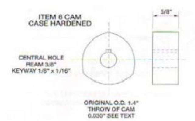

      I am making the Parkes’ gear hob relieving (backing-off) device which requires the making of a 3-lobed cam with a 3mm lift, or at least the instructions seem to indicate this although I would have thought that a greater movement of the cam follower would be more effective. I have followed the instructions given in the construction notes, MEW 57, with some success, or at least not a total failure but there is a bit of ‘guestimation’ involved.
      Not being the most skilled or knowledgeable of back-shed workers, I wondered if anyone can suggest a better approach for producing such a cam or point me in the direction as to where instructions might be found?
      Has anyone else built this device? Could they provide any advice?
      T.I.A.

            Post a picture/drawing of the part you are trying to make and you will likely receive plenty of advice.
            My copy of MEW 57 is in the loft and there is a ghost up there, so I won’t be going to look for it just now.
            If you are unsure that the dimensions are correct, someone might make you one or more 3D printed prototypes which would allow you to explore many options very quickly without having to worry about workholding.

                  “Not attempted to make this device I’m afraid but out of curiosity I’ve tried laying out the cam according to Giles Parkes drawing dimensions. It looks nothing like his drawing ! Using his “throw” of 0.030 inches (you quote 3 mm, inside info.?) it’s hardly possible to tell that it’s not a circle. Scaling GP’s drawing a throw of about 0.070 inches looks to have been used. Or am I missing something here ?”
                  In the construction notes it states that one jaw of a 3-jaw chuck should be packed out by 3mm (this is the only metric dimension given in all the drawings and notes) to produce the off-set and a cut put on of no more than 0.030″, the cam blank being fixed to a hexagonal mandrel. I have used both a cam blank of 1.4″ as called for on the drawing and, assuming this may have been a typo, a blank of 1.250″, i.e. one inch and a quarter as all the other dimensions on the drawings are given in this ‘imperial’ format. The smaller blank produced the more defined cam with the larger hardly appearing to deviate from a circle, but in either event the throw seems very small. Unfortunately Dr. Parkes is no longer with us to clarify his intentions, hence my asking if anyone else has built this device, I cannot believe that I am the only one.
                  I know that this device works as I had a conversation with the late Dr. Parkes when he was demonstrating it at one of the ‘Doncaster’ exhibitions several years ago.

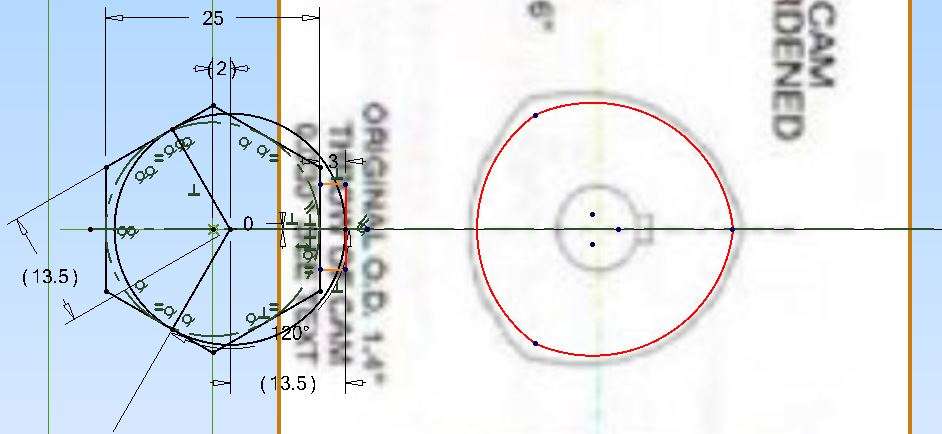

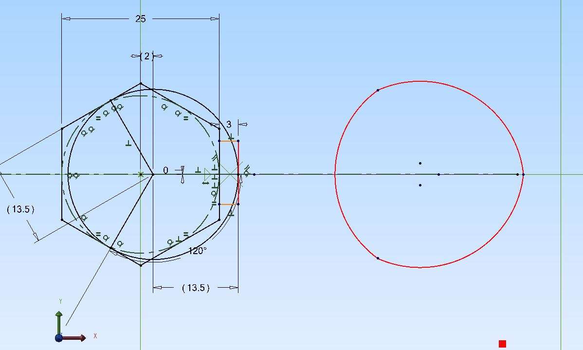

                              well this CAD jocky would go straight to CAM and then the CNC.
                              But for your enlightenment on the left I opted for a 25mm AF hexagon, added 3mm packing to the right hand side  and plotted where the ctr comes. Nice round figure of 2mm offset.
                              On the right is the resulting part set to a 2mm offset and a 0.030″ deep cut taken at three positions base on 1.25″ round stock to start with.
                              trilobe
                              This is from the article
                              trilobe2
                              Worth noting that the various formulas are based on holding round stock but using hex removes the need to allow for the width of the jaw end as the surface always stays parallel to the end of the jaw.

                                Looks good to me, Jason
                                #693251

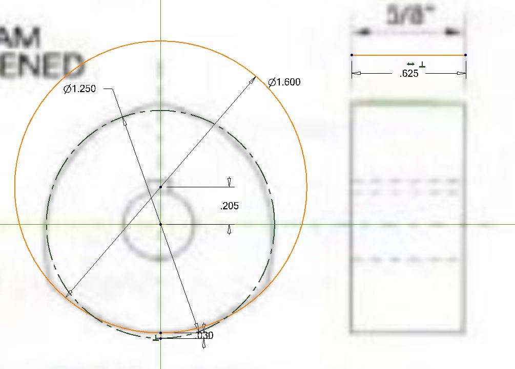

                                  Having now plotted it over the original the only thing is that the original blank looks like it was larger than 1.25″ and a much larger offset would be needed to get the radius of the flank shown.
                                  trilobe3
                                  #693252
                                    So we’re back to the opening question really … but with your tidy demonstration for reference.
                                      That is a good observation because it means that so long as the (round) stock is small enough, you could hold it in a hexagon collet block that is held in a three jaw chuck. That would simplify the mathematics.
                                      Would it be correct to say that as the jaw width tends to zero (i.e. line contact), its influence on the calculation reduces? If so, a six jaw chuck with three jaws removed could help as six jaw chuck jaws are naturally a lot ‘pointier’ than three jaw. Pointed soft jaws in a three jaw chuck could also assist.

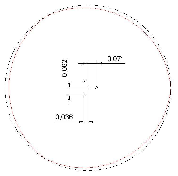

                                            For completeness this is the cam from my first image overlaid onto the drawing using a 1.25″ blank. Either it is a good case for “do not scale from drawing” or somewhere the sizes and text are wrong.
                                            1.4″ blank would be too big as it looks like 1.312″ is about right but offsets and DOC would not match what it says.
                                            trilobe4
                                            Probably wants a 1.4″ blank, a deeper DOC and then a bit of file work to round/blend the corners where the three faces meet will reduce that overall 1.4″ to closer to the 1/312″

                                              On JasonB Said:
                                              For completeness this is the cam from my first image overlaid onto the drawing using a 1.25″ blank. Either it is a good case for “do not scale from drawing” or somewhere the sizes and text are wrong. …
                                              Thanks again, Jason
                                              I have an uneasy suspicion that the published image is “for illustrative purposes only” … almost certain that it could be drawn with a geometry compass at one simple re-setting.

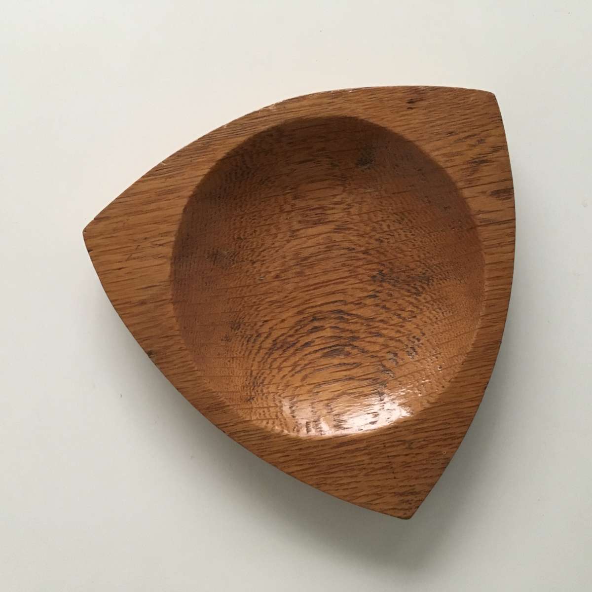

                                                    … and to demonstrate that: Here is one that I made [considerably] earlier
                                                    IMG_9095
                                                    as a school woodwork project in 1966
