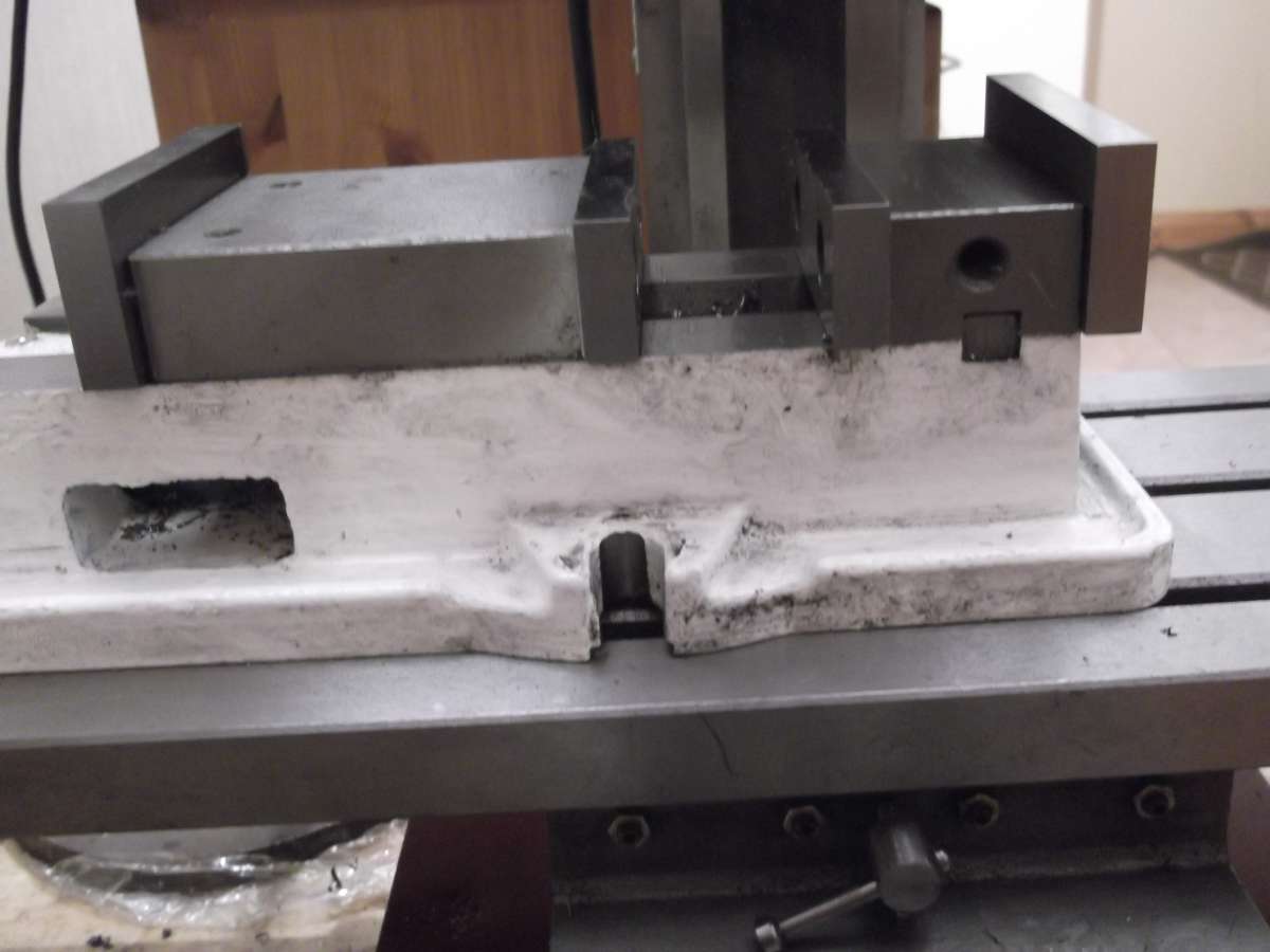

      Mod. 1 ~ fixing centres of the vice without swivel base 100mm.
      I milled the  fixing slots a little using an 8mm EM , as i prefer to remove the mininum  of material, now i can fit the vice lengthways on the bed, which to me is preferable & less “in the way” though there WILL be jobs where you will need to mount crossways on the bed.

      I decided to make some new jaws. The originals are 24mm x 3/8″ x approx 82mm long.
      Opted for some 1 14/” x 3/8″ GFS.
      Initially the price of ~ GFS put me off somewhat, but i got lucky & got the required size for a 1980’s price of £7.99 posted!!
      Initially i was going to make 4 new jaws, i’ve only made two, will see how things pan out for now.
      Though I now think 3 larger jaws might make for max potential with a minimum of jaw swapping?
      Probably not best practice to have vice jaws sticking up too much~ but the X1 isn’t exactly a powerhouse, so i think i’ll be ok.
      No i didn’t harden them, i lack the tools & know how to do a good job on this.
      Milling the ends square & to size, the X1 coped really well.
      I can’t say i enjoyed drilling the counterbores for the allen bolts much on my little mill though!
      Machinability (power) factor of GFS must be around 1.5, with mild steel 1.0 & Ali 0.3, so was hard graft drilling relatively big holes in a “hard” steel.

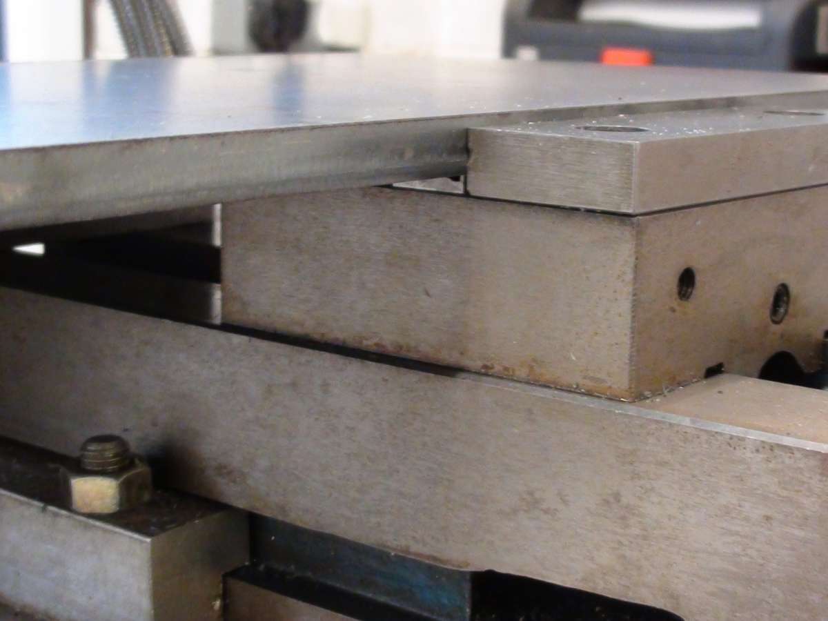

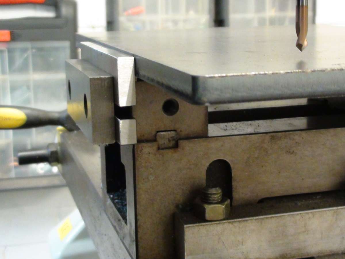

                      I found myself in a similar predicament to that faced by Samuel, back in 2022, when I was making a fixture plate for my mill.  The size of the plate was exceeded the capacity of the vice’s jaws and I wasn’t confident in the ability of the standard jaws’ ability to grip the workpiece sufficiently well using the normal relocated fixings.  After a little thought, I came up with a solution that utilised the original jaws, relocated to the rear of the fixed jaw, but with longer than standard screws, and sandwiching a couple of parallels as shown below;
                      Rear jaw
                      The use of two parallels kept the new “jaw” at right angles to the workpiece.
                      On the moveable jaw, I was able to just mount the vice jaw horizontally on the top, like this:
                      Front jaw
                      For a later project, and to accommodate an even larger piece of flat material, I replicated the arrangement used on the fixed jaw with one on the moveable jaw. This greatly increased the gripping range of the vice.  On the downside, it really stretched the X-Y envelope of the mill (a Warco VMC)!
