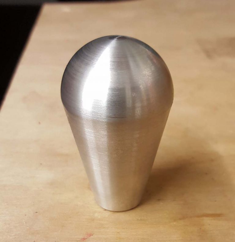

      I want to make something like this **LINK**
      I know how to up to a point but am struggling once I have made it how to drill the hole and thread it without damaging it.
      Any suggestions, looked to YouTube but could not find anything

          I suggest tapered soft jaws or tapered split bush.

            I would have thought that the hole and thread is the starting point and from which you hold the raw stock to do the shaping operations. i.e threaded onto an arbor.

              I think I would be looking to drill and tap the blank first, mount it on a matching threaded shaft. You could then hold the shaft in the chuck and turn the shape of the knob.

                Yep, drill and tap then turn taper on threaded arbor then use ball turner and shape end over

                    As said drill, tap and cut the taper then screw it onto something while you round the end.

                                  I suspect that the nylon / plastic on would be comfortable to the hand, it might be worth making a threaded brass insert with a parallel knurled outside to it, pressed into the nylon knob. Set up the hole first, and screw this on a short bit of thread, hold in the lathe chuck and turn the taper, then rough out the hemisphere and finish with a hand scraper as used in wood turning.

                                      Well have enjoyed making my new knob
