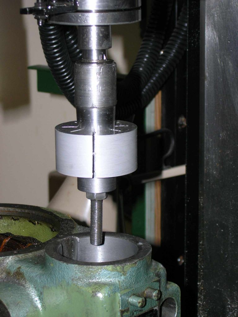

      Just boring out an Arborga head casting but need to lap it to get a decent finish before we sort the new spindle size out. .
      Seen plenty of articles about making nice precise smaller laps and made some previously with great success  but has anyone got any ideas about making a largish (60mm) lap for a one off job, is it possible to make one from close grained wood for example?

          Wood works fine Peter. I have used it many times for lapping a cylinder. You need to make it so it can be expanded. On method I have used which works well is start with 2 pieces of wood say 2 x1 and about twice as long as the cylinder .Form a groove across the centre of one piece. Glue them together at the ends only to make a 2×2 blank. This can be turned to the required diameter between centers and a wedge pushed between to expand the lap.

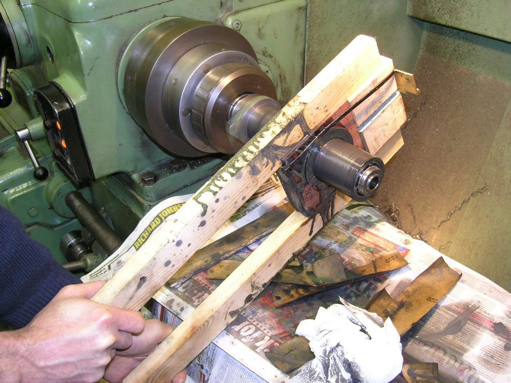

                      #60970
                      Ian S C
                        @iansc
                           For an external lap, 2 sticks of wood, say 6 to 8″ long, hinged together at one end.  Near the hinged end make a groove to accept the shaft. Put it over the shaft, which is mounted in the lathe, apply the grinding paste and start the lathe bring the two sticks together, and thats about that.  Ian S C

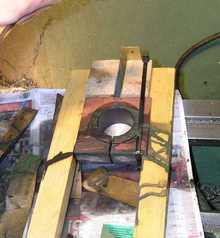

                          Thanks for the advice, over the festive season we have been working on the job and it is now finished and we are very pleased with the results.
                          We had bored the head casting previously, this was not withour delay as the Abene mill we were using suffered a gearbox failure just as we got started and it took a week to overhaul it and replace 3off 3mm dia needle rollers in a clutch which were causing the problem
                          After finding a piece of aluminium the right size we made an internal expanding lap. This worked well and we soon had this nicely lapped out using medium and then very fine Timesaver compound.

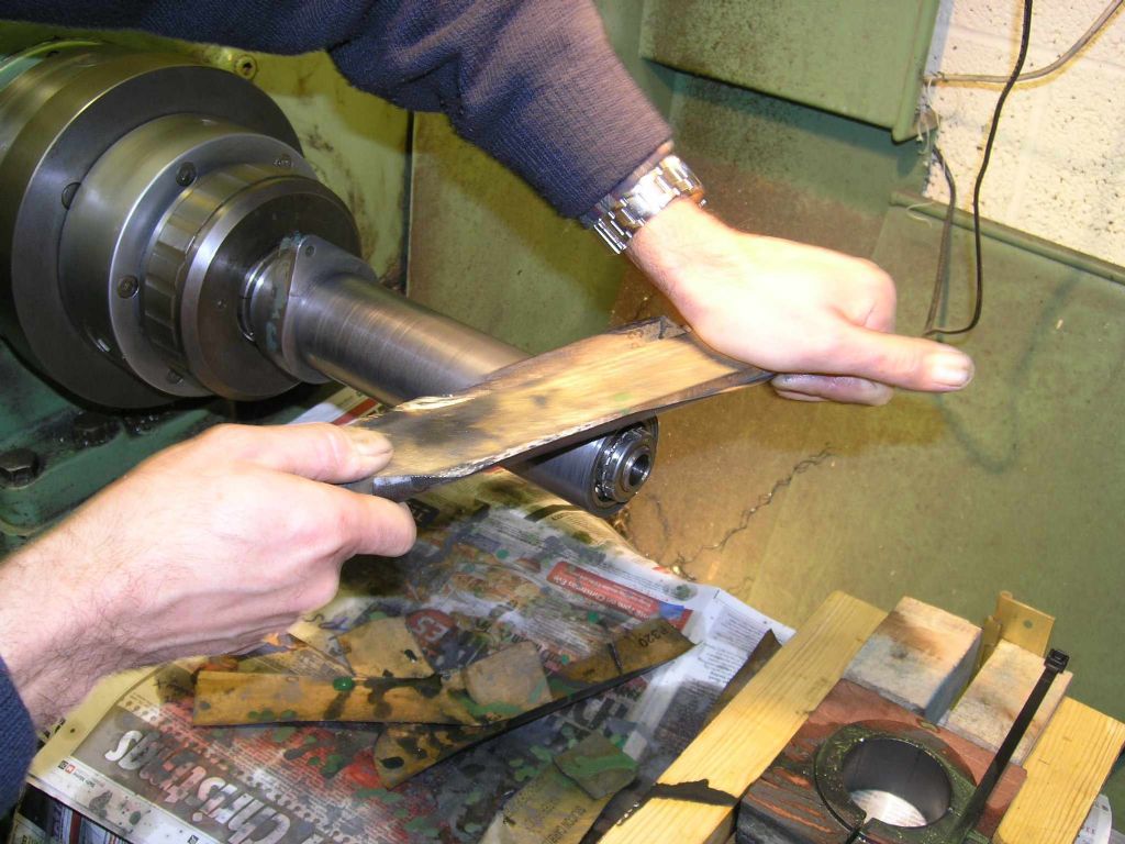

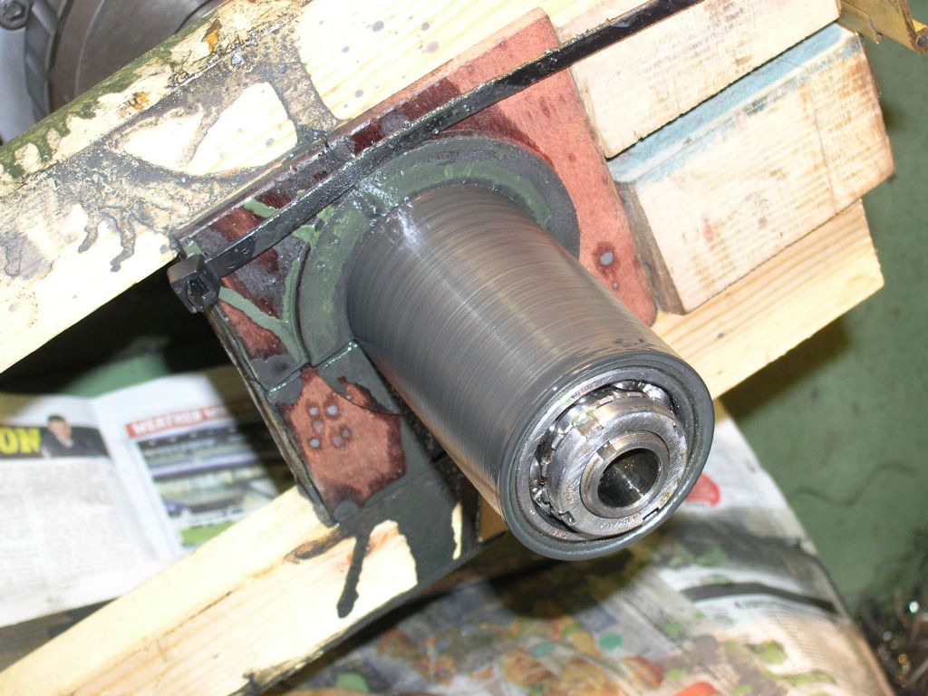

                          The old spindle was turned down assembled so we could use the bearings to support it  in a large collet chuck in the lathe. The spindle turned out to be  a cast material and was cracked where someone had missed drifting a drill out. We sleeved this with EN8 locitied on  and turned to almost size. In classic tradition the final cut produced grooves and a slightly wrong size which was worked on with fine wet & dry.
                          A wooden lap hinged at the top was made based on from some of the suggstions, the centre wood was made of Jarra and promptly split on the first use. However the loose piece was held in place with a cable tie and all was well.
                          Measuring the fit of it it all was quite awkward and we managed to get one end to just about fit and worked down the spindle. We could use the spindle to keep checking but eventually resorted to a an ancient micrometer more as a comparator on the shaft to see where the errors were.
                          Eventually we got it to be a nice press fit along all its length so we were very pleased with the outcome. A bit more fiddling and working resulted in a smotth “push” type fit. We think that the aluminium lap produced a more accurate finish but the wooden one was certainly easier to make and use.
