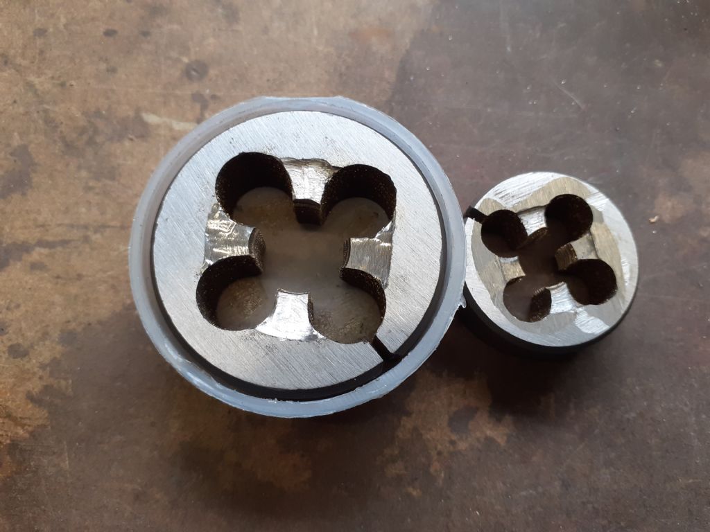

      Hi – I have a number of standard threading dies in the usual ME sizes, some of which have a generous lead-in on the front face for easy starting and effectively a zero lead in on the reverse face which is very useful when threading up to a shoulder. With more recent purchases I notice that dies now now come with a lead-in on both front and rear faces making it a lot more difficult to continue the thread up to a shoulder.
      What I would like to be able to do is to grind off the lead-in from the back surface of these dies but in the absence of a surface grinder I am loathed to try any lash-ups for fear of having a disaster on my hands. What have been other peoples experiences in this regard and can anyone suggest a simple and safe way of achieving the desired effect.

          You could try machining a recess with a carbide tool, just facing off the back will compromise the dimple positions in the die holder. HSS will machine with a carbide tool and carbon steel should be ok as well. An alternative to threading up to a shoulder is to machine an undercut as would be required if screwcutting.

            If I was compelled to attempt something like that, I would turn up a make-shift shallow die holder with a spigot to hold it in my battery drill. Mount the die in the holder, cobble up a rest and spin it in the drill whilst pressing it against the wheel of my bench grinder.

                    Unless you are threading to a very large shoulder then a Dremel can be used to hollow out the back of the die but leave the outer edge untouched so it still sits right in a diestock when used the right way round. You can then flip it around to finish the thread but I still tend to add an undercut or ease the female thread.

                        As I said above if shoulder is not too large a diameter than Dremel does the job, dimples stay in the right place and you still have a flat back face do die sits square in the holder

                          Looks fine Jason. I'd wondered if you'd built some sort of grinding jig for the toolpost.
