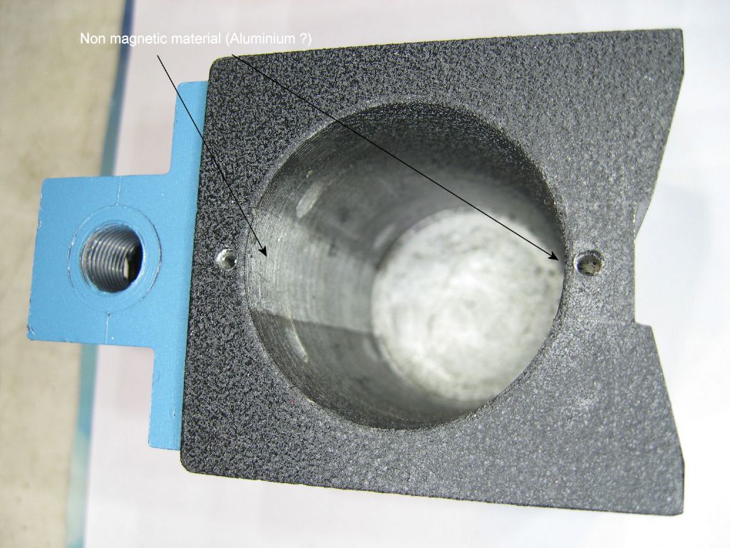

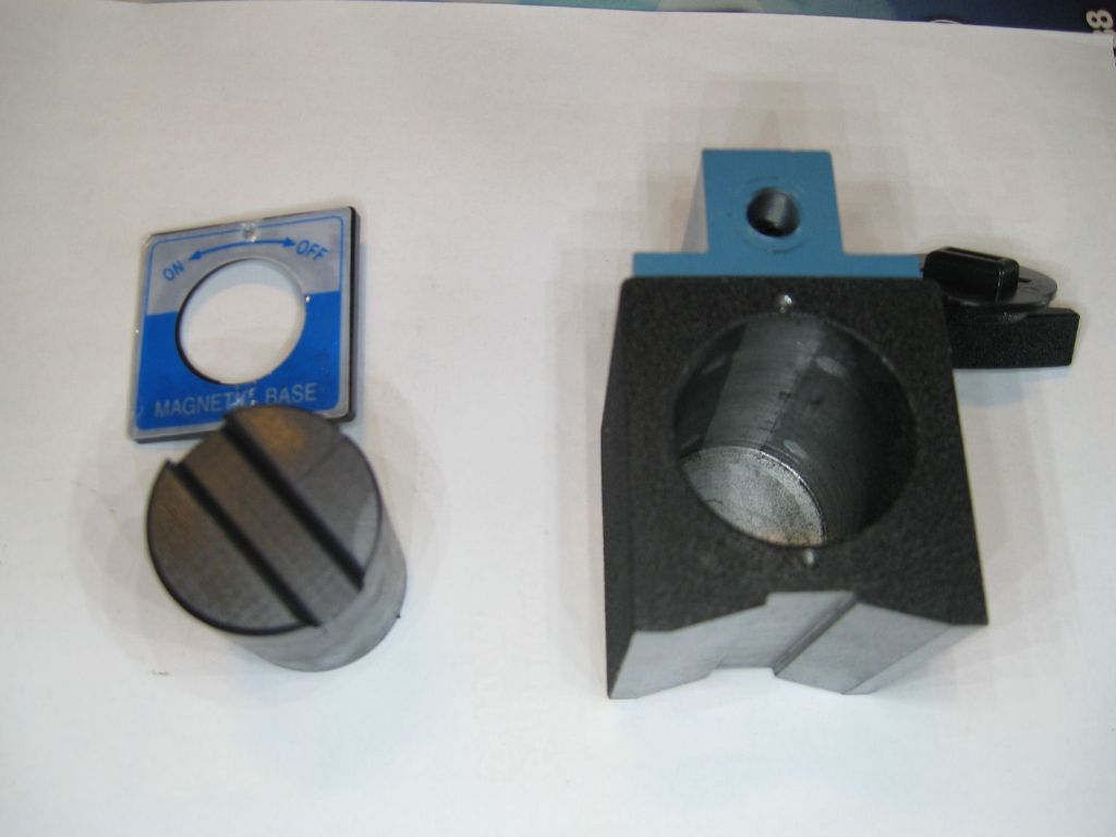

                        Hi,
                        This discussion made me wonder why the cast iron did not shunt the magnetic path. Looking at a magnetic base it looks like one lump of cast iron. As I could not understand how it could possibly work I decided to dismantle one. I found that it was not one piece of cast iron but two separated by non magnetic material. (Probably aluminium.) The cast iron forms the two pole pieces. This explains how they work. When the poles of the magnet are horizontal a pole is lined up with each pole piece. When the poles of the magnet are vertical they are shunted by the cast iron so there is very little magnetic field.
                        Here are the pictures of the dismantled unit.
                        Magnetic base parts
                        Magnetic base inside
                        Les.

                              Les Jones 1
                                @lesjones1
                                Hi Neil,
                                It still works when re assembled.
                                Les.

                                                  #97855
                                                  knoba
                                                    @knoba
                                                    I've been wondering about these too.
                                                    I stripped an almost identical mag stand, to the one Les posted pictures of, trying to figure out the dimensions, construction, materials, etc…
                                                    From what I can figure…
                                                    The disimilar metals can clearly be seen forming the sandwich. The two sides are made from 2 Fe plates with pre-bored holes (see image at what look like rivet marks either side of the Al plate). The aluminium core must(?) be cast into a mold with the Fe plates in situ. The whole lot is then bored. The Al filled holes appear to be a way to secure the assembly together, due in part; to joining the dissimilar metals and, to eliminate any Fe disturbing the Al (non-magnetic) core that would (usually) be created using standard Fe fastenings through the sandwich.
                                                    The magnet used in mine is a "Dyametrically oppossed" cylinder magnet with an approximate break-away pull of 1Lb.
                                                    Unfortunately, regarding the machined mag base faces (mine has 2; underside & rear) it's a little more complicated as, the rear of the casing is also constructed of Al & Fe materials. However, in my base, aswell as the one in the photo, the entire visible area at the back of the internal bore is Al. The Fe plates have been pre-shaped to allow a mag face at the rear.
                                                    The only other info I can find is a Wiki page, here – http://en.wikipedia.org/wiki/Magnetic_base
                                                    If anyone else has more info, I for one, would be interested.
