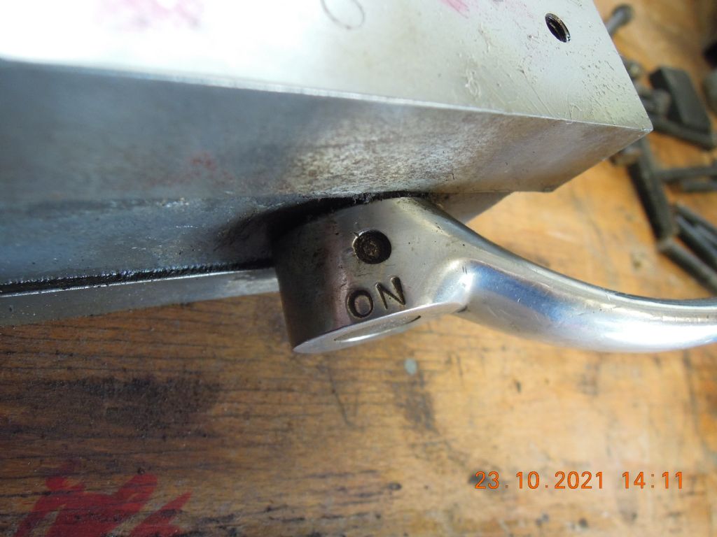

        Afternoon chaps, just trying to dismantle my mag chuck as the handle is much stiffer than I think it ought to be.
        Does any one know how the handle is retained on the shaft ? It's not a roll pin or a screw, at least that I can make out, in fact it looks more like a rivet. What I do know is that both ends are a bit of a mess suggesting I'm not the first to try to remove it. It presently looks like this:-

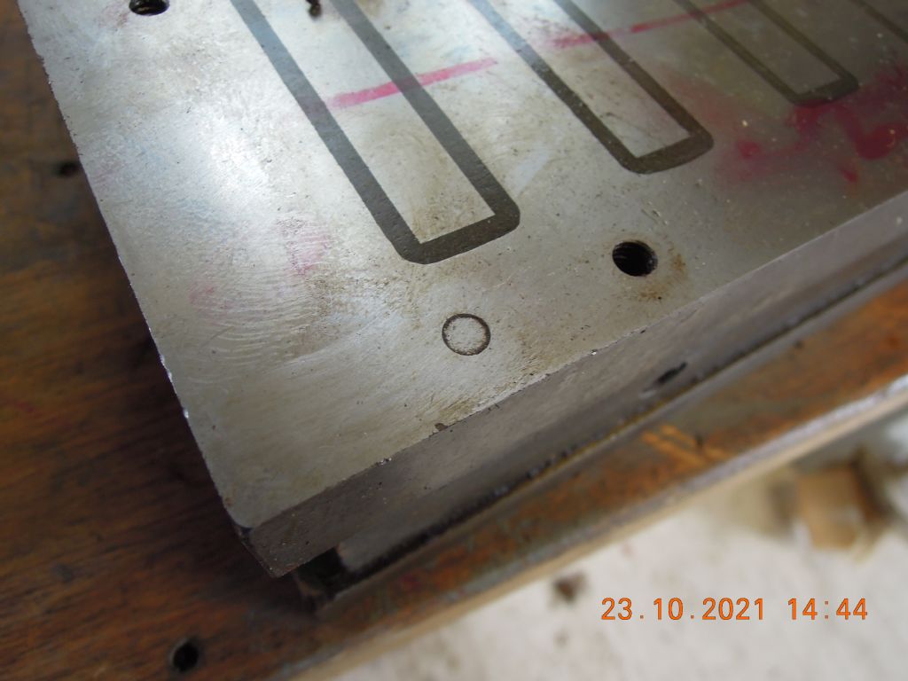

        Also, in terms of the separation of the two halves of the chuck itself I'm struggling here too. I have removed 11 long countersunk screws from the base and I can see that there are four locating dowels which must be keeping the two main sections together as seen below.
        However, quite a lot of hammering on the overhanging ends of the top plate wont budge it off these dowels. I'm thinking of using a press to force a wedge between the upper an lower plates but thought I better check with the experts on here before getting too aggressive in case I've missed something

              I took my Eclipse 10 by 5 mag chuck apart many years ago because the on off handle was very stiff. The handle on mine was held in by a taper pin and a good wallop got it out. Undo all the screws in the base and it should come apart quite easily, there are three pieces, top and bottom plates and an ally casting for the middle bit. Mine was full of crud, it had been used with coolant and some had got inside and rusted everything. A good wash out and reassembled the same way it came apart and jobs a good un. Would be worth just kissing the top over just to make sure everything is dead true, I was always taught to grind the top of the chuck with the magnets on, others say with them off, no doubt someone will tell me what is correct and why.

                    The handle on mine is a lift off key, square form male into a socket if I remember correctly without going out to check it. The handle itself is die cast carburettor metal which will not take severe torque on the small area of the square key. I have used total immersion methods in kerosene to free off seized or partially seized mechanisms, leave it overnight to give it a chance to creep inside.

                      Gerry, don’t bother removing the handle, it should come away with the centre section of the chuck. I have taken a few of these apart in my time and some can be reluctant to come apart, one chuck needed persuading with a four inch bricklayers bolster applied under the top plate to lift it up, it had to come apart, it was seized solid, others have fallen apart as soon as the screws came out.

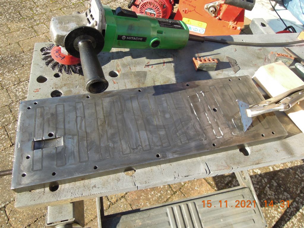

                              As Mark Bolan said 'all I want is easy action' and that's what I now have on my mag chuck. It was a bit of a struggle to get the beast apart. I had to clamp the base-plate to my bench and get a crow-bar on the top-plate to separate it, but once apart it was really just a clean-up operation. A wire brushing and a dunk or two on a bucket of white spirit was mainly all that was required.
                              There were a couple of points worth mentioning for anyone else attempting this often frowned-upon task. The first one is that I found the epoxy fillings between the poles were protruding quite significantly above the inside surface for the top plate. Suspecting that these could be part of the cause of the operational stiffness I cut them back with a blade until they were absolutely flush. The chuck couldn't have been made like this so my guess is that the epoxy has swelled a little over time from oil absorption. In the pic below the 'white bits' indicate where the epoxy was cut back. This pic by the way was taken in the almost-finished condition. There was much more protrusion beforehand.
                              The second point was that the aluminium frame came with only one oil lubrication hole in it. This didn't make any sense to me as its just as important to let the rubbish out as put new oil in. So I drilled and tapped 3 additional M10 grub-screw holes so that there were two on each side.. I can now add oil and drain simultaneously whilst operating the chuck.
                              I have to say that this was a job well worth doing and I'm astounded at the improvement its made. I can operate the on/off handle easily with one hand now where as previously I needed two arms and an extension tube. Of course some might say that this improvement is because I have lost all the magnetism. I suppose I might have lost some, I can't actually prove it either way, but I honestly can't tell that the chuck is any different to before. If I put a rough cast iron plate 3" x 5" on the chuck I simply cannot move it by hand and that's good enough for me.
