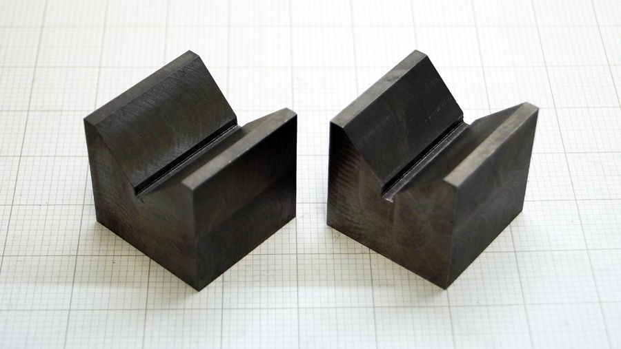

        A friend asked if I can make a new steel shaft for a piece of old farm equipment he is renovating, its not too big with turned ends and various bits of milling along the length.
        I thought for the milling a set up on a pair of V blocks would be good but I dont have any but I did have a piece of 45mm square cast iron so I thought I would give making a pair of blocks a try.
        It went ok and I,m quite pleased with how they turned out, now before I get jumped on – no they are not hardened steel, no they are not precision ground and they are not sized and matched to within a tenth of a gnats wotsit.
        They are reasonably accurate though and as good as I could get from milling a lump of cast iron. I machined them as one piece and apart from the slot all the cutting was with a 25mm end mill, where it matters they are good to within 2 thou.
        So hopefully they will be ok for the job I have to do, should be as its pretty loose on tolerances, and they should be ok for everyday jobs.
        Good fun making them, just need to go over them with a 800 paper wrapped file and then black them, I may mill a couple of slots along the sides and make up a couple of U shaped top clamps.

          Nice V blocks, I made a pair some years ago, they have been used often. Mine have a slot along each side so they can be clamped to the milling machine table.

            Hi Ron, look good to me, and yes a couple of slots on the sides would be a good idea you'll be glad you did when you get a job that needs them.

              I made a much cruder vee block out of a foot of 3" channel section steel. I wanted to section a Skeeter gearbox rotor shaft for display. It was good enough to hold it while milling out an 15" by 4" bit to see the innards. The tube was much harder than anticipated and used up about 5 solid carbide end mills.

                Thor, looking at the link of your blocks I think I will put a clamping slot in each side of the blocks and make up some clamps for fixing down to the table. Plus if I take a mil or two off the the top faces to increase the width I can drill and tap for fixing clamps which I can also make, yours look good.
                A question I do have re cast iron, is it possible to surface harden cast iron, I tried looking it up but got mixed messages, some said no, some said yes but saying you need to know the make up of the iron first and at that point I got a bit lost.

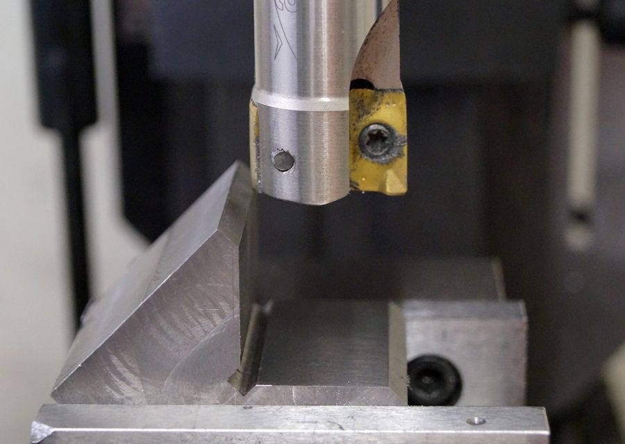

                              Recently in another thread there has been a discussion on how best to mill a 45 degree angle. Just wondering how you did it?

                                        Adrian,
                                        A picture below of one of the finished blocks in the vice the way I had it set up for cutting the V. I clocked the block from the spindle making sure I had the diagonal vertical and then used the end mill to cut down to just shy of the finished depth.
                                        I then in turn set the block up in the vice with each face horizontal to give a finishing cut having first clocked the vertical face true and square. It seems to have worked as checking the V with a square and also a Stevenson block the V looks to be pretty well spot on 90 degrees or at least as my eyes see it.
                                        Hope that makes sense.
