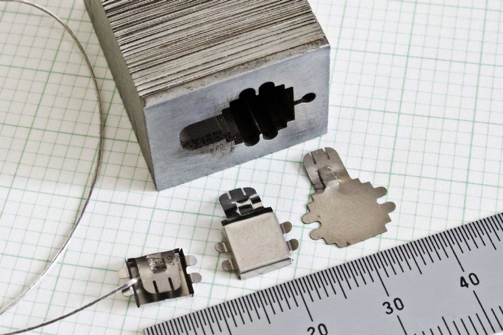

                              Sam Stones
                                @samstones42903
                                Hi Luc,
                                You might consider using wire cutting, which is a very neat EDM process. This was a method I elected to contract out for some thin stainless steel electrodes. The cost here in Melbourne, was quite low especially when compared with making up a stamping tool.
                                The top of my picture shows the starting point block of some 740 off shims 0.075mm thick after they were spark machined. The hole to the right of the block was their starting point, and was burned through by the contractor.
                                Each shim measured about 25mm x 20mm, and I sandwiched them between a couple of pieces of gauge steel before rivetting them together with two silver steel dowels which passed through the whole assembly. The contractor surface ground a couple of faces of the block for reference.
                                The row of electrodes (right to left) show an initial blank, a formed electrode, and my method of attaching the wire.
                                Because the shims were tightly sandwiched together, you can see that the edges are very `clean’.
                                For reference, the small squares on the graph paper are 2mm.
                                Although it is about ten years ago or more, and my memory is not as sharp, please feel free to ask, if you think I can help further.
                                Best regards,
                                Sam
