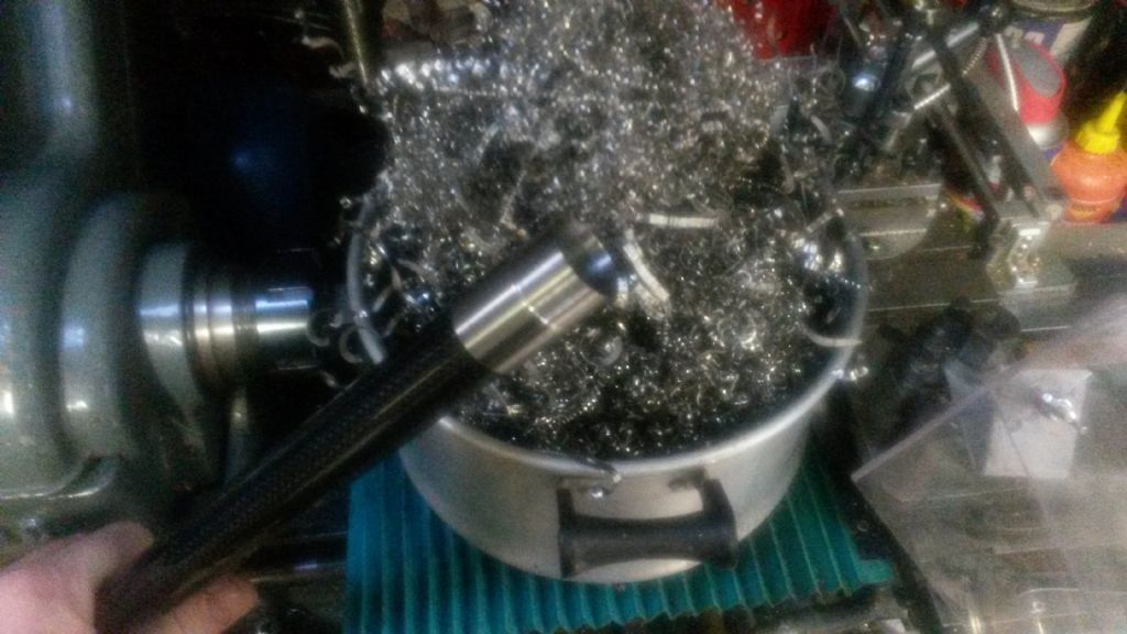

                                                  Nick Hulme
                                                    @nickhulme30114
                                                    Titanium tube end adapter and the waste generated from machining two such adapters from solid, carbide tooling run dry on a Myford S7
                                                    No fires, no drama, no problem
