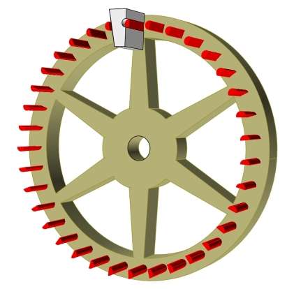

      My clock project progresses (very) slowly. While it’s too cold to spend much time in the workshop I have been thinking about how to make some of the bits.
      This is the pinwheel for the escapement. It’s 32mm diameter. the 35 pins are 1mm diameter brass or phosphor bronze rod, 5mm long (plus the bit in the wheel) on a 29mm pitch circle. There is 2.09mm between the finished flat on one pin and the back of the next. The curved back is the acting surface, and the flat is needed to keep the drop small by allowing the pallets to be closer together.
      Pinwheel Image
      The question is the best way to cut the flats on the pins. I have a small rotary table for the mill, so I am thinking of  mounting the wheel (with round pins) on the table (horizontal), and milling the flats with a 1 or 1.5mm end mill.
      I am not sure the 1mm Brass pins would mill without bending, so I think I will make a support block as shown (it needs more elaboration for clamping) and put it behind each pin before milling.
      I am hoping someone has a better idea!

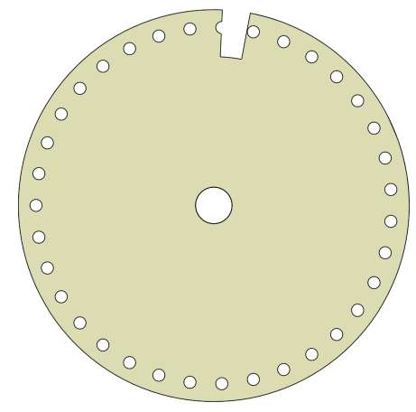

          #710377
            May be easier to drill the hole pattern on a scrap disc of metal and slip over the assembled pinwheel and then just do a series of radial cuts rather than having the possibility of the wedge coming loose

                Thank you Jason. Almost the inverse of what I planned, but way easier to make. Something like this – would be moved each time the table was indexed, but much easier to clamp
                Pinwheel Jig

                  An MDF support plate may be enough for machining the brass pins as it is only going to be between 0 and 0.5mm coming off. An alternative to a milling cutter is a slitting saw. A 1mm or 2mm saw will do this and will leave a nice surface on brass. A lot less flimsy than a tiny milling cutter where having one snap after a few pins are machined would be very troublesome in my mind.
                  If you want a metal support plate you don’t need to make one to go over all the pins at once, one that only supports a few of the pins at once would be enough as long as it can be slipped off and repositioned without much struggle.
