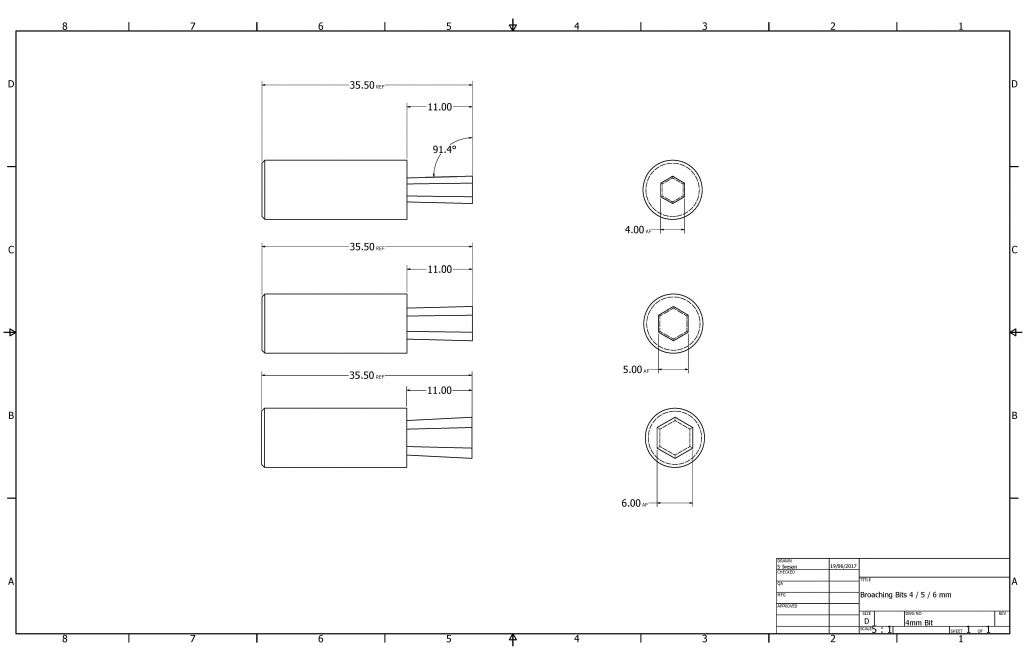

      I'm looking for some help here. I've used your forum many times in the past as a resource for information and I thought it may be a good place to ask for some assistance.
      I have a lathe and want to make some replacement pivots, axles etc for my mountain bike – the only issue is I can't broach an allen head…yet!
      I have made myself a rotary broach however I have no access to a mill and so I cannot machine the actual cutting bits (I had hoped I could get someone at work to do it for me but that's fallen through). I was hoping that someone with a mill might like to knock some up per the sketch attached in exchange for beer (or money to buy beer would probably be easier!).
      The bits are to be made from 10mm dia ground silver steel (or drill rod) which is approximately 27 HRC hardness. I can supply this. I had no trouble facing them off on my mini lathe if that helps. I realise that the hex won't be up to a square shoulder however that's just for clearance so it really doesn't matter. As for the angle, that's just how it came out when I drew it up and isn't critical (although given the choice I'd prefer a greater angle to allow more clearance than a smaller one).
      If anyone is able to help then that would be massively appreciated as until "she who must be obeyed" signs off on the milling machine I'm a bit stuck (although to be fair to the wife she has given me the go ahead on a bigger lathe!).
      I am based in Aberdeen but could post material out and of course would happily supply enough beer tokens to compensate for any return postage costs.
      Thanks in advance for any help!

            Apologies for forgetting to attach the image! I think I got carried away thinking about beer!
            As for the tool steel, it's not that hard just now although grinding would be a good alternative. Once the cutters are back I will heat treat them to attain a hardness of (hopefully) around 57-62 HRC. Certainly when researching this project other people I came across milled the hex and then polished to achieve a better surface finish although this was likely due to machine availability rather than it being a preferred process.
            Please see below:cutting bit-page-001 (2).jpg

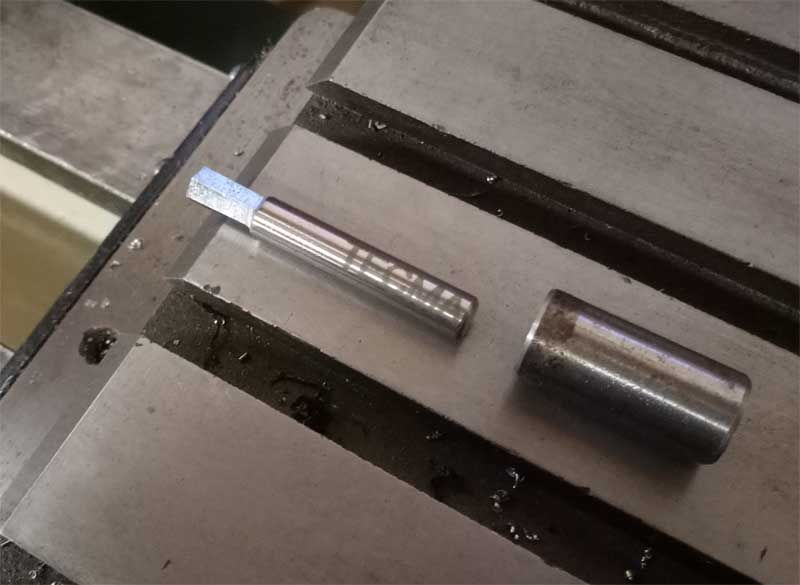

                  You could make a jig up and mill them in the lathe .
                  All you need is some hex bar with a hole drilled and reamed through it to accept the blank broach and a couple of decent grub screws to lock it in , if your toolpost is big enough to accept the hex bar mount it up in there and set the toolpost to the 91 deg you need then mount a milling cutter up in the chuck .
                  If your toolpost is not big enough you could set it all up on an angle plate on the lathe cross slide and set the angle plate to the 91 deg . You would have to set up some fences or stops on the angle plate also
                  The hex bar holder becomes your indexing device as well ,
                  You could also leave the a few thou oversize and then set up a grinding wheel in the chuck and use that to give them a final sharpen up after hardening .

                            Posted by XD 351 on 04/07/2017 19:07:05:
                            That is a fantastic idea and one I think I'll give a go! It seems so simple – previously I was thinking of mounting rotary tables to the cross slide! Now that just seems silly!

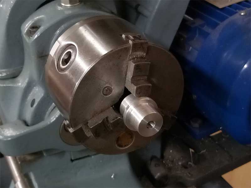

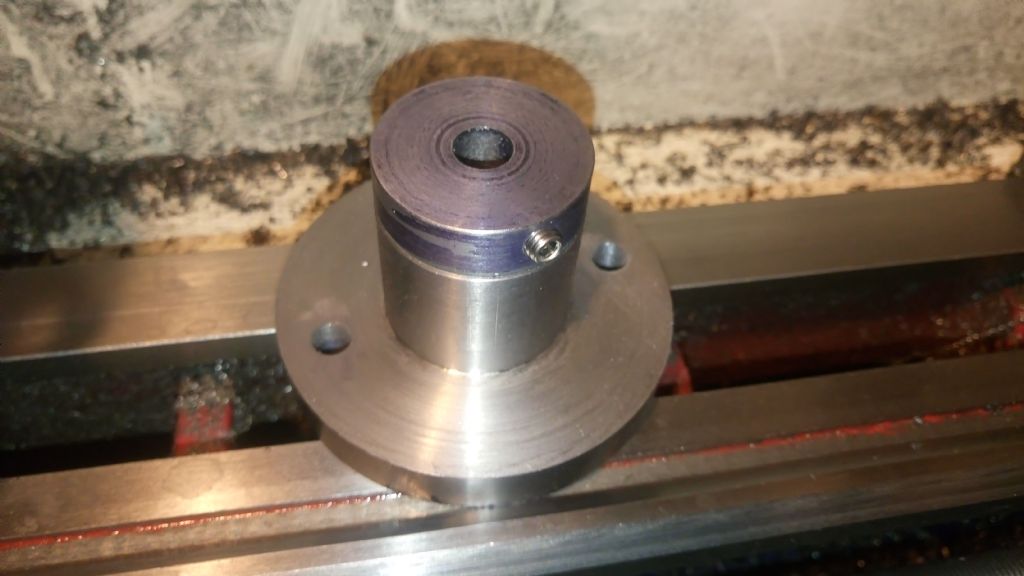

                                    Here's a picture of where I am so far. All I need now to complete the tool is the mounting plate (which I will finish tonight) and the cutting bits. I've just ordered some hex bar stock to have a go at Ian's suggestion of making them in the lathe so I'll report back when I've had a go (probably next week).
                                    On a side note – does anyone have any suggestions fro removing marking blue? I think part of the problem is a relatively poor surface finish and I'm not overly fussed for this particular project but it would be good to see if anyone has any ideas. So far I've tried isoporyl alcohol and WD-40 which will remove the dye from high spots but won't touch any in the dips in the surface.
                                    #305653
                                    John Haine
                                      @johnhaine32865
                                      Meths. I hope your manufacture of the broaches in the lathe works out, but I'd be willing to make them as it's on my "have a go" list anyway.

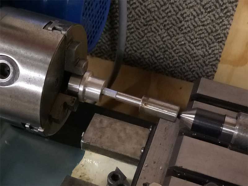

                                          Seeing we are having such cold winter weather here a bit west of Sydney (18deg C !) I thought I'd hang out in the nice warm workshop and make/post a simpler method of rotary broaching for home use. The test was the 5mm size which fitted on a piece of 1/4" HSS round. The form was ground on a D-bit grinder which has been very handy for this type of work. As I have one of those little Myford ML7 lathes in the corner of the workshop (it was a project a couple of years ago to save it from the scrapper!! A great little machine but rarely used in my workshop) I used that as the OP indicates it is Aluminium alloy he will be using so it didn't require a heavier machine.
                                          A short piece of 12mm silver steel (mild would do) was used to house the broach one end with a 1/4" blind hole. The other end has a No. 3 centre drill hole for centre support. The tailstock is offset to give about the 1 deg taper on the broach form but not more than the taper. The hole was drilled 5.1mm dia, as another poster suggested with a small 1mm deep counterbore of 5.8mm dia. to guide the point A bit of lube on the form and some on the centre, speed set at slow high range and presto, wind the tailstock spindle forward steadily and you have a nice 5mm hex for the key to fit. Suggest making the broach 5.1mm A.F.

                                            I love your idea D Hanna – that would have saved me a lot of time! Oh well, adjusting the tailstock on the mini lathe is a PITA anyway! That's a good suggestion too making the cutter slightly oversize. It would also allow for more scope for sharpening without reducing the AF dimensions beyond what is acceptable.

                                              Only if you fiddle around with methods deemed to be "the only way"!! A DTI either held by it's tail or even a magnetic base attached to chuck face, rotate stylus around tailstock centre or bore of taper and read front to back until zero difference. Forget what reading is at top as "mostly" the tailstock will be a wee bit high unless it's worn through misuse. A couple of minutes should have it back in alignment. Trial cutting in most cases has whiskers on it unless the lathe bed has other problems!!

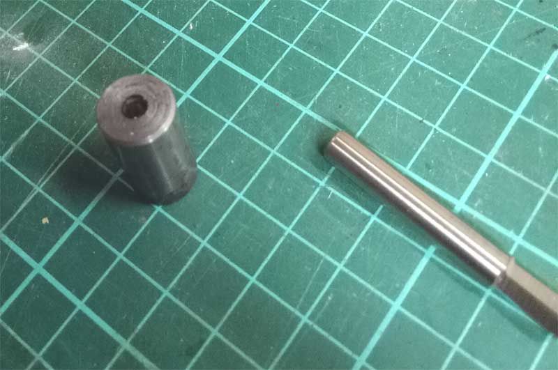

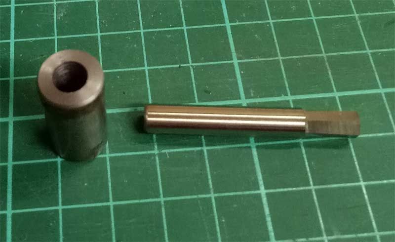

                                                The main issue I have found is that once I've got everything centered and where I want it to be it has a habit of shifting when I tighten everything back down. Last time it took many cycles until I got it spot on. That being said, I was a whole lot less experienced last time I tried it. I think my dial indicator was purely used to stop my drawings blowing away if I'd left the shed door open!
                                                As for milling in the lathe – it worked a treat! I was in a bit of a rush and didn't entirely think things through so the dimensions were a fair bit off on the first one. I've not yet had a chance to try again but I'll be sure to post back once I do!
