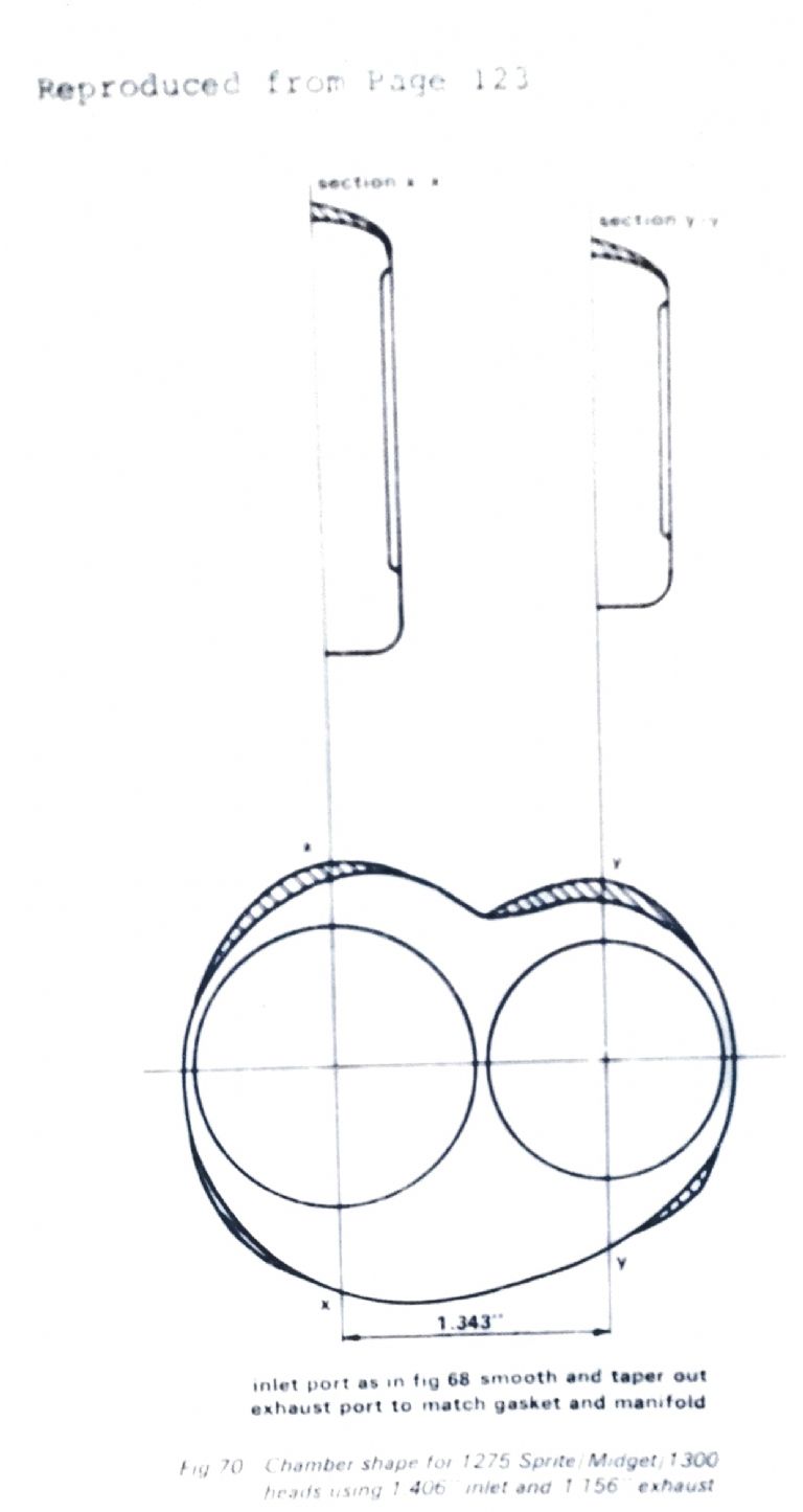

                    If I understand the task here, it's to produce some flat area in the chamber that is a defined distance from the top face of the cylinder head so as to provide a guide when using a mounted point on a flexible shaft grinder to fully profile the chamber. Why not set the depth on your pillar drill and use a small diameter end mill (~5mm) to create a number of spot faces in each chamber? Or just use a 5mm drill instead of the end mill.
                    If the valve seats are already cut, you could make a pair of dummy valves that protect the seats and sit in the seat at the correct depth to act as a further guide when grinding.
                    I still have my 1973 Vizard's guide to cylinder head modification from my 998cc Mini days and scanned the 1275 Midget template:

                      Multiple spot faces with a slot drill should deliver what the OP needs. And more importantly should be doable with a pillar drill.
                      Here's a 12G940 head I did a while ago, very similar combustion chamber shape to the Vizard design. I traced the combustion chamber shape for this head from a head from a professionally built motor (Swaymar IIRC) that gave really good power on the Dyno.

                        Using a slot drill or endmill with plunge cuts only will not produce a flat combustion chamber, just a load of peaks and troughs, Those cutters have the lips ground to provide clearance so do not cut a flat hole.
                        Could be beneficial as it would certainly cause a lot of disruption to the gas flow.

                              The idea is to make a reference cut. The chamber floor will be ground flat to the reference point using an Air Die Grinder.

                                  I replied to this yesterday morning, but the post seems not to have uploaded. You have understood the task correctly. Vizards Cylinder Head Modification Book is on eBay for £38, but I am cautious about buying it as a lot of his info has now been superceeded due to modern fuels, would it be worth buying? You don't still have the chamber profile template do you All the experts do not want to give away thiers I have managed to get a photo of a modified cylinder with a ruler as a guide and I am trying to make up a template but it is very difficult. I have been getting guidance from a renowned expert but its very bitty.

                                            Hi,
                                            This is a 12G940 BMC A Series Head, non hardened valve seats.
                                            Valves will be Metro which I believe are 35.6mm Inlet, 29.2mm Exhaust.
                                            Target head volume is I believe 25.3cc (but I’d need to recheck my notes) Piston dish is 8cc, Deck Height is averaged at 0.0045”. Rockers will be zero tolerance 1.3:1. No pockets required as this Amis a 1275 A +. Pistons are Nural Hepolite P21253 +40.
