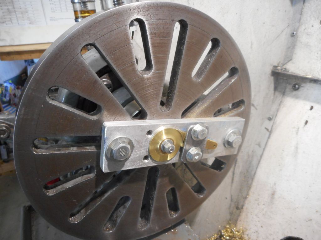

                                                      I use a box of 5/16 and 3/8 BSW bolts, nuts and washers of varying lengths from the local hardware store for all clamping to faceplate and vertical slide. Plus some T nuts for the vertical slide. These take either 5/16 or 8mm studs.  No need for T nuts on the faceplate. Just nuts and washers work ok. Also some bits and pieces of flat bar with various holes drilled in them to suit the need of the day and act as clamps.
                                                      Handiest thing I have is a few pieces of flat bar with two holes drilled in each. One hole is tapped to take a 5/16 bolt that becomes the adjustable packing piece. The other hole is 3/8 clearance for the clamping bolt. Can be seen in this pic, albeit using longer than normal bolts for a special job. I like not having loose packing pieces that could fly out if the clamp comes loose, so the bolt screwed into the clamping piece is nice and secure.
                                                      But you will often have to make special clamps and jigs to suit the job in hand, such as this piece of aluminium plate with the job screwed to it then the plate bolted to the faceplate. Works a treat for fiddly little stuff.
                                                      I have also resorted to using 3/8" coach bolts on the vertical slide. Had to grind two flats on the heads on the bench grinder and thin the dome of thehead down on the lathe to fit the T slots. Also coach bolts work well on the faceplate as the square shank part holds them while being tightened. Do not overtighten 3/8 bolts or they WILL distort your flimsy Myford slides etc. Hold your spanner up close to the nut being tightened and use restraint.
                                                      5/16" is plenty big enough if you are buying a formal set of clamps and bolts. Mostly it depends on what T nuts you can get to fit the Myford slots. I think you have to buy them from Myford as nothing else fits. Not sure what size studs their T nuts are made for these days.
                                                      Never mind the Heath Robinson contraption to mount the lathe's fixed steady to itself for machining! Needs must.
