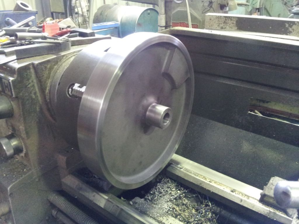

        This question prompted by seeing a photo of a cast flywheel that will be machined. I can see that it will need a hole in the boss and the outer rim machining but where do you start, which part do you assume is 'accurate'? Do you hold it by the boss and turn the rim then hold the rim and drill the boss? Which bit do you rely on being 'near enough correct' to use as the starting point?

          I would normally hold it in the 4-jaw by the inside rim and set the "as-cast" inside rim as true as possible. The outer rim, boss and bore can then be machined. This approach might need to be modified, dependant on the exact geometry

                    I mounted the flywheel for my engine in a 4-jaw chuck by the inside of the flange, then machined the bore, outer surface of the boss and the outside and one side of the flange. This ensured that they were all machined on the same centre.
                    The chuck jaws were centred on the inside of the flywheel and the OD made concentric with it. The inside flange on my flywheel is a cast surface. If I had located on the OD, I probably would have to machine the ID to make it concentric and balanced. (also a bit difficult with couterbalance weight built into the casting)
                    The flywheel was then reversed and held by the boss to machine the remaining side of the flange.

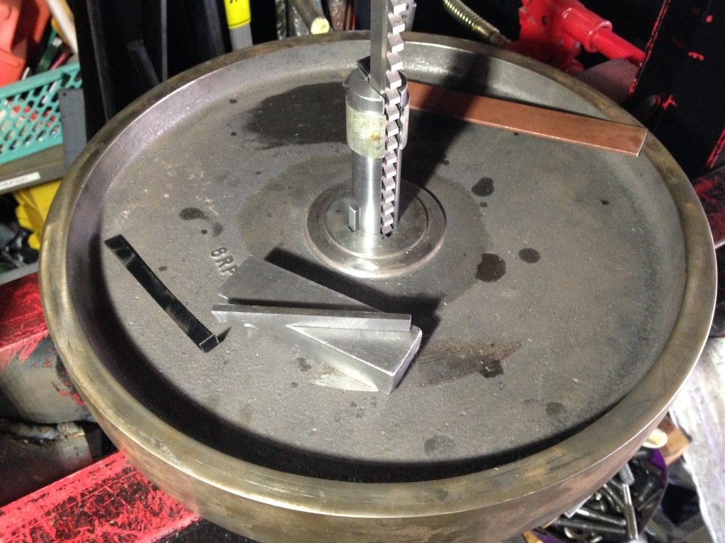

                                    The flywheel on my engine is secured with taperred keys and a tapered slot had to be cut into the boss in the flywheel.
                                    I first cut a keyway with a broach. Pushing the broach thru the flywheel with a press and then making subsequent passes with shims behind the cutter to deepen the keyway slot. The final cuts were made with a taperred shim behind the broach to make the angled slot. I then made a key by using the same taperred shim under the key material. Both key and keyway were then at the exact same angle.
                                    Securing a flywheel to the shaft with a taperred key is fairly simply but my engine has 2 keys at 90 degrees to each other. A bit more complex. The solution was to make a broach guide that was a slide fit with the flywheel bore and machine 2 slots in it at 90 degrees to each other. One to locate in the first slot in the flywheel with a key and the second slot as a guide for the broach to cut a second slot.
