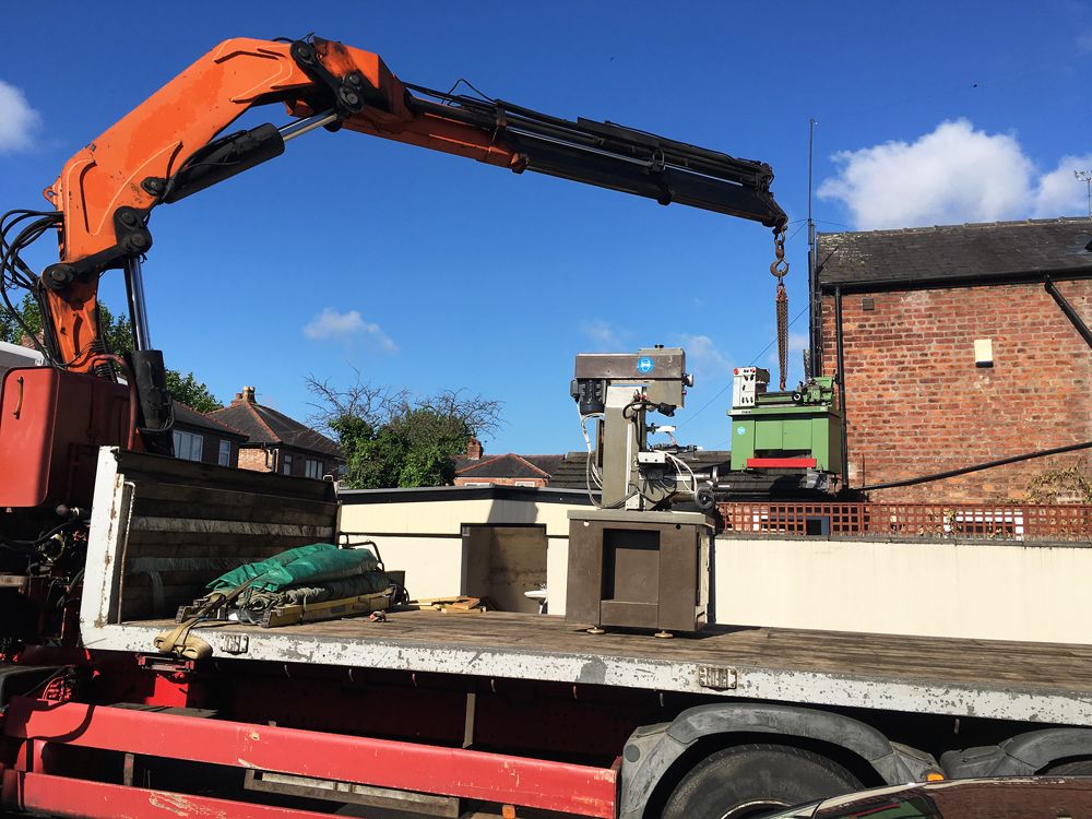

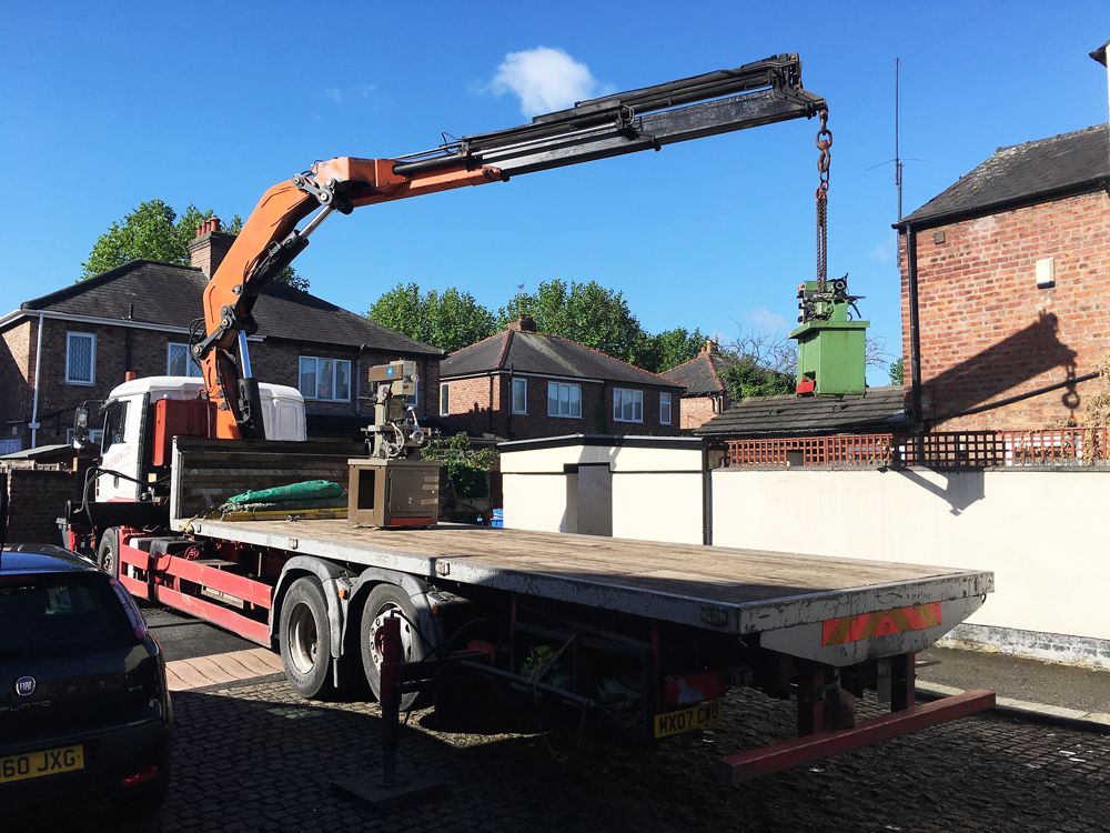

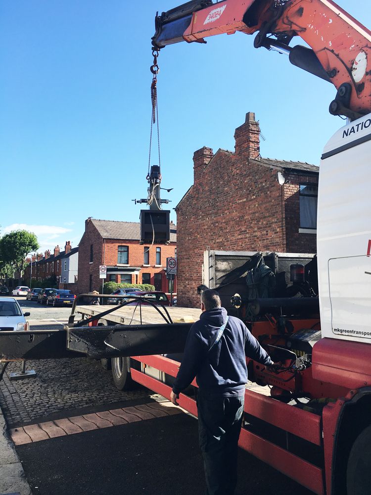

      I have known for a couple of months I was going to have to relocate my workshop.
      Today was machine moving day. – All went well without breakages or crushed heads or toes.

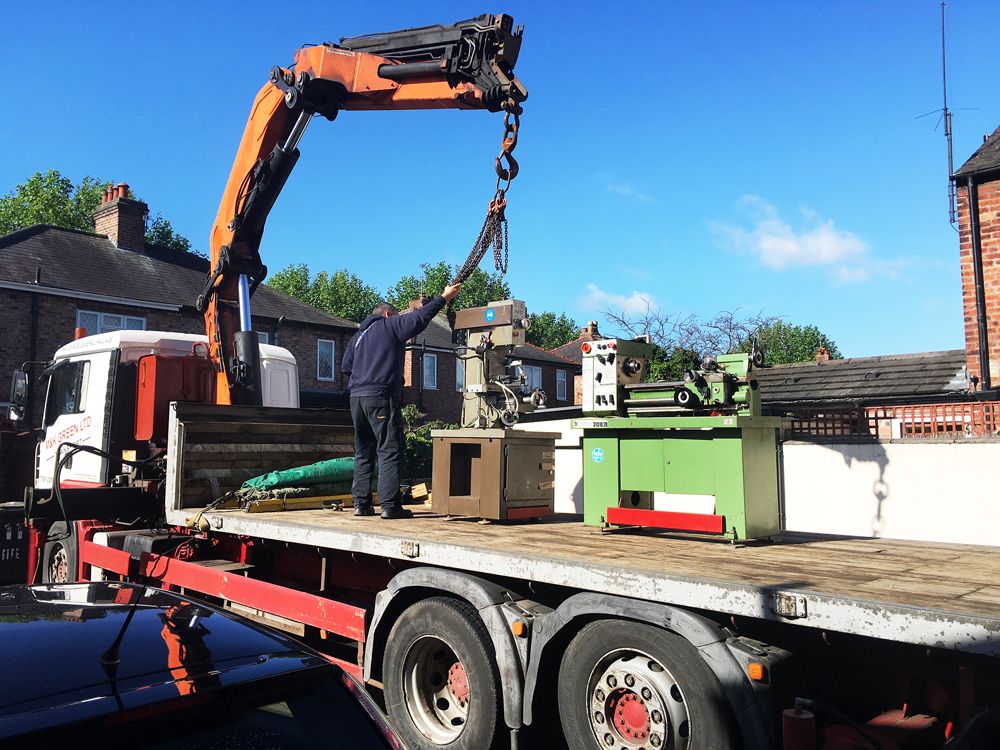

        Speedy Builder5
          @speedybuilder5
          Single strop for the lathe? I think I would have preferred 2 strops, one on each end of the bed.

              Posted by Speedy Builder5 on 09/06/2017 18:19:15:
              BobH
              Isn't there a hole for a screweye in the middle of the bed?
                BobH
                The Boxford is being moved as per the manufacturer's recommendation.
                There is a thread cut in the first web in from of the chuck for a M16 x 2 lifting eye, failing that a single strap is used round the web and through the bed, NOT round it.
                The X10 series lathes balance correctly with a single point lift by adjusting the saddle and tailstock to an appropriate position as counterweights.
                If you lift an X10 Boxford with two straps round the bed it will bend the leadscrew.
