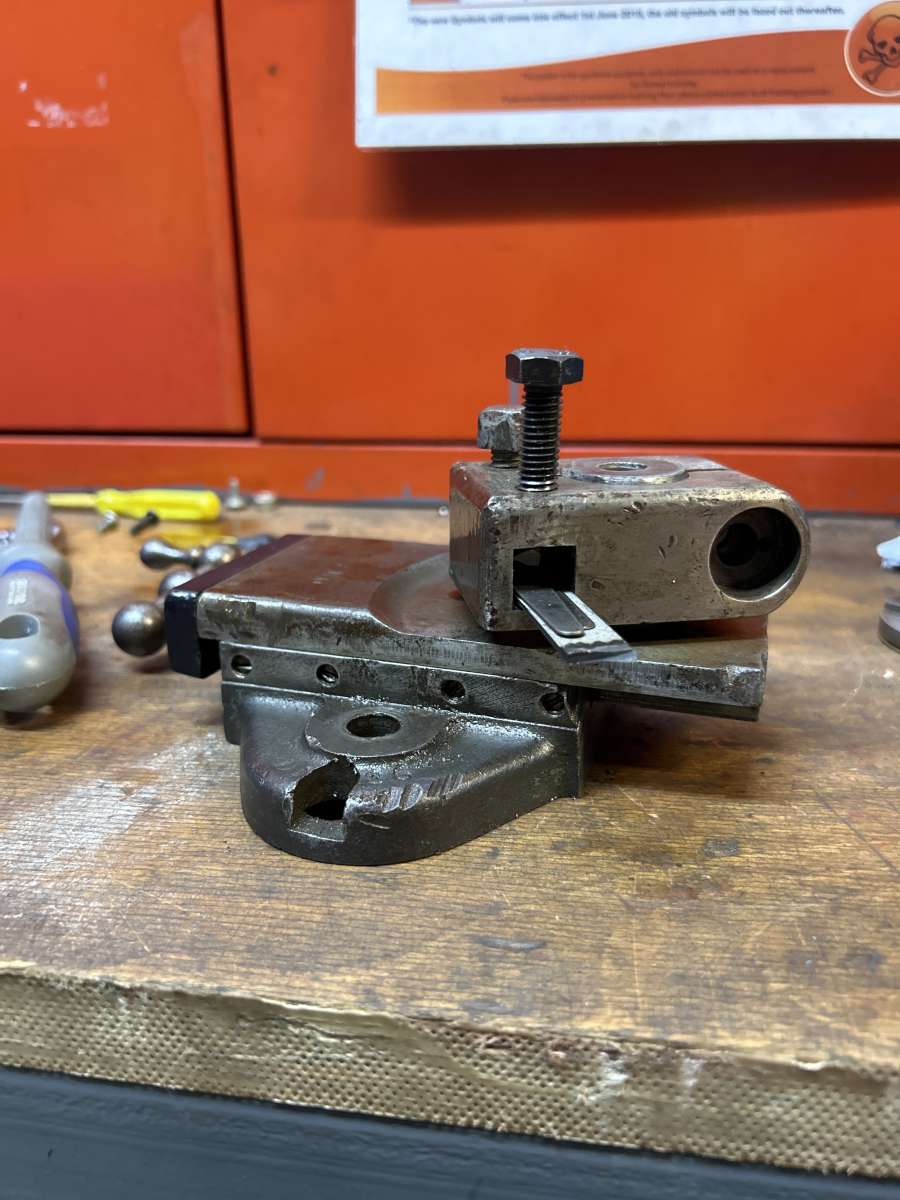

      Hi all, I’m looking into a new tool holder as the one I have is the original one and has seen far better days. Myford have told me that if I want to fit one of their later tool holders I will have to change the topslide or modify the one I have with a 7/16 mountain post. Would anyone know what or if a different topslide can be fitted?

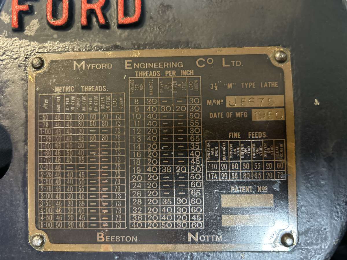

          Sorry Bernard, I just assumed you all owned a crystal ball😉😂. The lathe I have is a Myford/Drummond 1950 3 1/2 M type. Pics below of the original tool holder.imageimage
          #805292
          bernard towers
            @bernardtowers37738
            It looks like a small 4 way could be made to fit, dimension from slide to base of tool is what’s important. There are some on the bay and RDG sell them as well

                Myford suggested this one, but I’d have to modify the top plate to fit a 7/16 post mount.
                https://www.myford.co.uk/product/myford-quick-change-toolpost-ml7-super-7-254-lathes-78175/

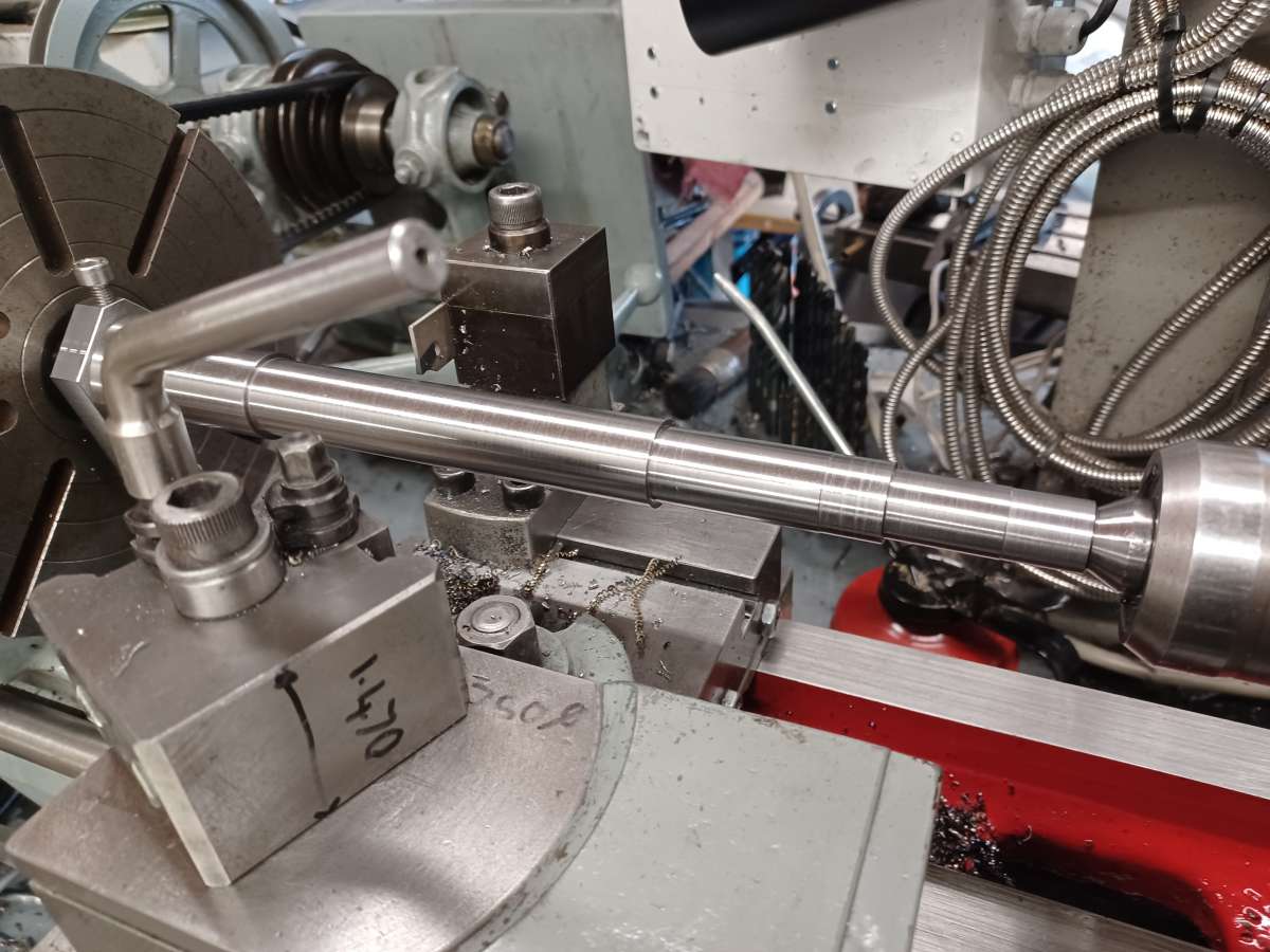

                          Hi Jimm.  I have modified my M Type lathe to take a Dixon toolpost and wouldn’t be without it Jason has given a link to the artical that I wrote a while ago. There is another group which is usfull to Drummond and Myford lathe and machinery owners which it is worth visiting for information and another group of helpfull members as well. I have a page in the files section there with loads of drawings and pictures of the M Type lathe with loads of modifications and upgrades I have done to my lathe and the tooling.
                          https://groups.io/g/drummondlathe/topics
                          20230226_093819
                          Picture of making a Morse taper spindle for my lathe and you can also see rear toolpost which makes parting off a dodle since i fitted it.
                          David

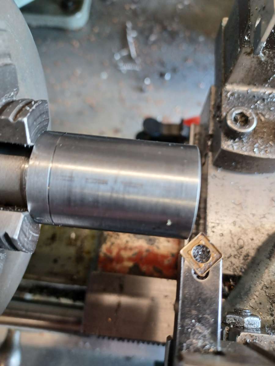

                                I use mostly 10mm tooling in my Dixon toolpost and can get away with 12mm just. I have a 10mm tool which is great for foughing out as you can use the front for diameter turning the left hand side, as the tip sticks out a small amount, for facing and the 45 degree face for chamfering and taking of sharp edges.
                                These are available from Jenny Potts. Email jenny@jbcuttingtools.com   telephone   01246418110   or website  http://www.jbcuttingtools.com
