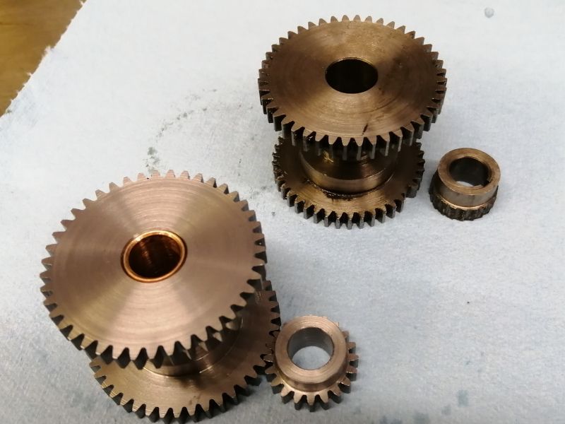

      Just to be Job's comforter, Would Myford cast iron gears (Assuming 20 DP rather than 1.25 Mod ) be
      a ) wide enough, or
      b ) strong enough?
      If YES, go for it and modify some.
      Howard
      #514751
      Mark Rand
        @markrand96270

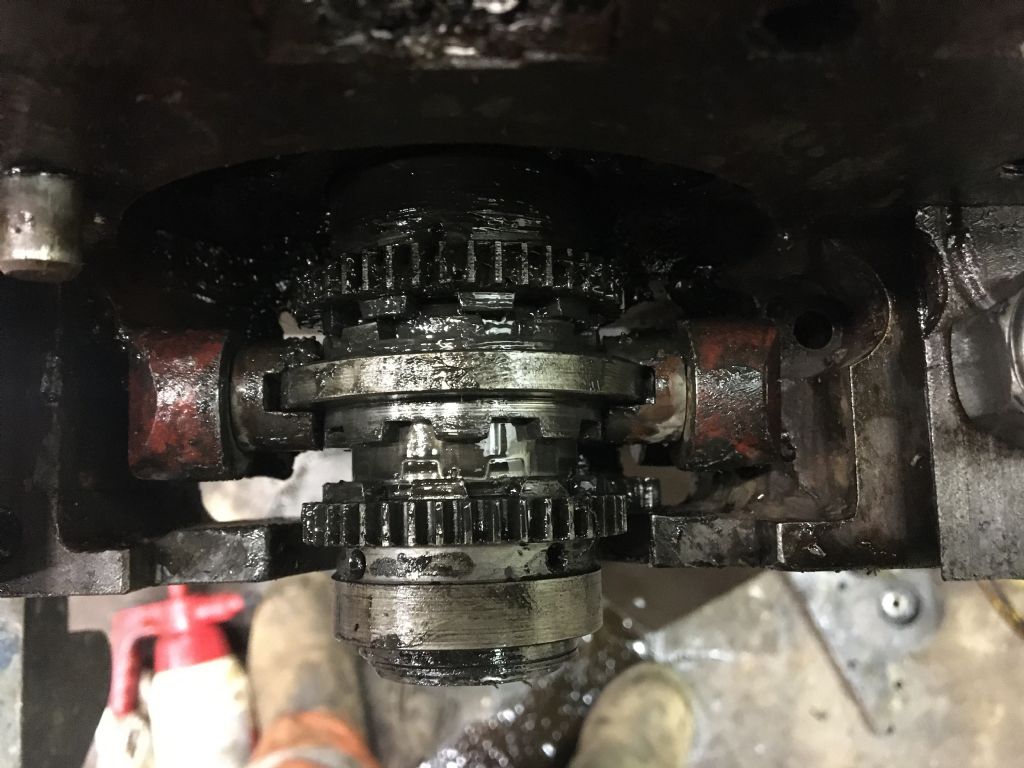

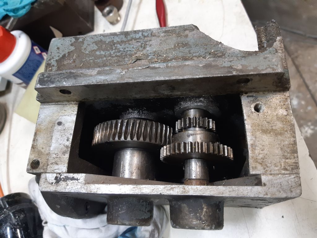

        There is good news and bad news…
        The old gearbox was still there under the surface table.
        However
        There is only the 20T gear because the 42T gear is part of the saddle assembly. The 20T gear is also rather badly worn. I suspect that it won't last all that well. One or more previous owners weren't all that bothered about lubrication, protection from brute force, moisture etc.
        As for the feedscrew key,the dogs should slide on to it without any force, but no noticeable clearance.. You may either have a small burr on the key or it isn't all the way into the keyseat.
        You are welcome to the gears if you want them. Just PM me an address.
        For what it's worth, I'd probably just use a collection of Myford changewheels, bore them out and Loctite them on to either manufactured bushes or the turned down originals.

            #514761
            Pete Rimmer
              @peterimmer30576
              Posted by Mark Rand on 21/12/2020 13:32:16:
              However
              Edited By Mark Rand on 21/12/2020 13:46:07
              Mark can I impose on you to measure the centre distances for me?
              #514793
              Mark Rand
                @markrand96270
                Posted by Mark Guy on 21/12/2020 14:09:03:
                Mark when you turn the left hand lead screw handle the dog drive turns with it even though the key that serves two purposes I.e locks the lead screw when it’s engaged and also holds the dog gear carrier. So it’s impossible to line the two up so when you screw it up it just locks against the key. Also I’m unable to back the bed right of to the left as it also locks up and not sure why
                You can't remove the bed on the left without removing the end brackets and handles.
                The feedscrew is keyed all along the threaded length but not far on the solid part of it and the dog clutch/gear assembly is permanently keyed to it rotationally (sliding fit axially). so the feed screw has to be withdrawn from the right hand side of the machine. take the left hand handle, dial, dial carrier and bracke too off. Take the right hand bracket off (can leave the handle etc. attached) then wind the feedscrew towards the right. Once it's past the feed nut, at the left side of the saddle, you can slide it out the rest of the way. There's a likelyhood that you'll need some creative tapping/levering with a drift and a wooden lever to get the brackets off the table, since the dowels are a good fit.
                Pete:- I can't measure the centre didtances between those two gears, since one is in the gearbox and the other is buried in the carriage. But I have double checked by measurement that all the spur gears in the box are 20DP.

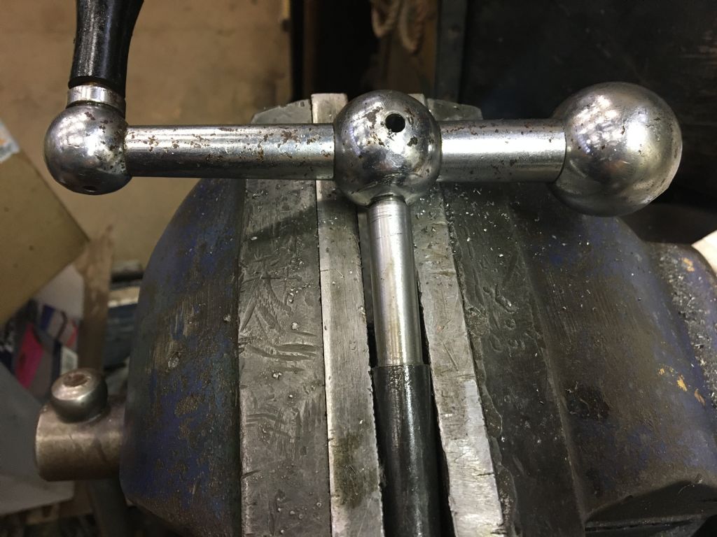

                            Mark Guy
                              @markguy26995
                              Mark
                              Good man cheers will I get away with just taking the plate off as the handle on the left as be broke off the lead screw and been bojed up. There was a T nut and bolt right side but not on the left. I never gave it much thought until this happened then I realised what it was for.
                              I’m also going to rewire the feed motor via a relay so it can only be turned on whilst the head is live.

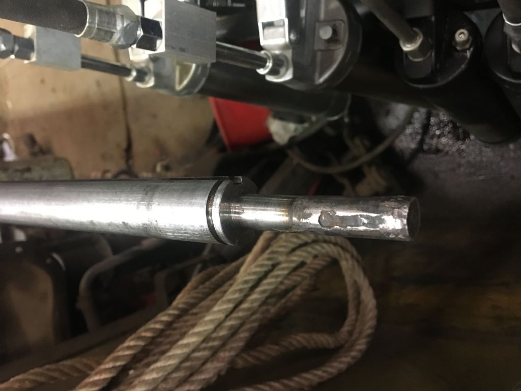

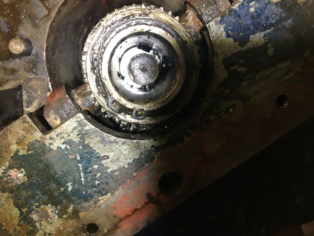

                                  #514984

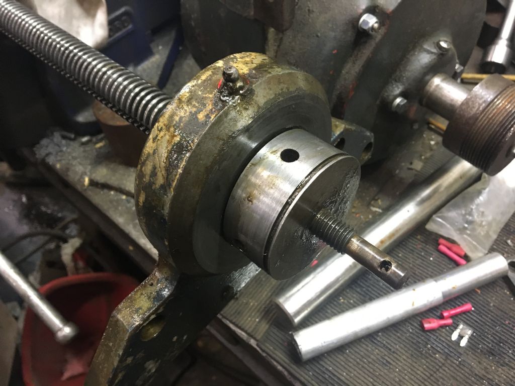

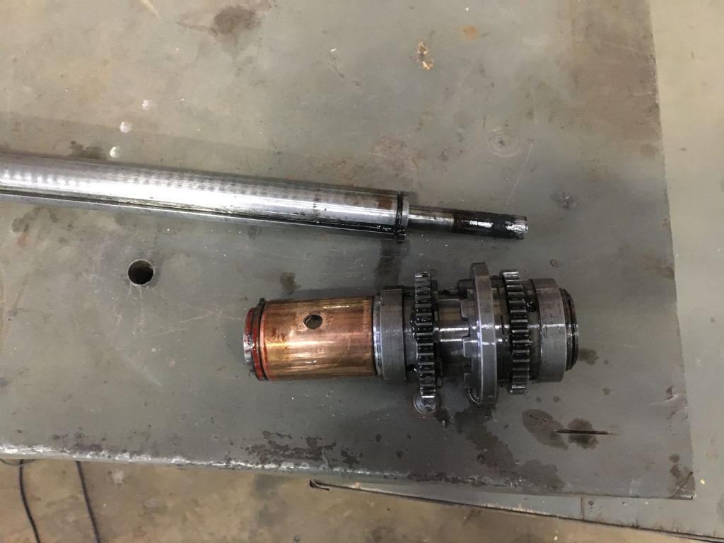

                                  Mark Guy
                                    @markguy26995
                                    876aa9f4-778b-4899-bfd8-5c7d5335133c.jpegf4b3b8d2-c820-4b56-8143-d23ebb62b69a.jpegfad4deca-da90-4ae7-b914-637f16b76b56.jpegMark
                                    I’ve managed to get it apart after taking the lead screw out completely like you said it was a burr on outer right side of the lead screw. Had to get the pullers on it mind to shift it. Thanks for the advise.
                                    now I’ve got it all apart I may as well repair the lead screw properly well as properly as possible without making a new one. I’m thinking of a straight 1/2 en16t bar threaded 1/2 unf cut off the damaged ends on the lead screw then bore and tap the lead screw to suit then either lock tight or drill and grub screw in place.
                                    what are your thought.
                                    #514998
                                    DC31k
                                      @dc31k
                                      Posted by Mark Guy on 22/12/2020 19:48:15:
                                      I would just cut off the smaller diameter piece flush with where the step in diameter is, drill and ream the leadscrew and use Loctite 648.
                                      What torque is that part taking? Or are you in the habit of using a Stilsons with a four foot cheater bar on the handwheel? Threading both parts runs the risk of them not ending up concentric, unless you make the shorter bit oversize and finish turn it after locking it into place.
                                      You should probably stone or file the keyway in the entire leadscrew while it is out to remove any burrs. Also have a good look at the drive key that runs in the keyway, and remake it if necessary. It is not the best design, having a keyway along a threaded shaft – the threads act as a cheese grater on the key.
                                      Before you commit yourself to gluing something in, have a think of how you will secure the handwheel and dials to the leadscrew. If you have the necessary taper pin reamer, all well and good, but matching the existing holes in the dial and screw is not simple, especially with five feet of screw waggling about on the end of the piece on which you are working. It might be easier to do the fitting with the small diameter piece free of the main leadscrew. Then you can test assemble everything, make one simple length adjustment and glue it together.
                                      Have a look at the part in the foreground of the lower photo, let us call it the dog assembly. Excessive end float in this can make engaging the power feed like changing gear in an Austin Maxi. A brass washer to shim it all back snug again transforms it to a Honda Accord.
                                      #515006
                                      Mark Rand
                                        @markrand96270
                                        Strangely enough, my one's got 1/2" silver steel ends, threaded 1/2"BSF, held in with Loctite 603 for similar reasons laugh.
                                        It may be worth putting the feedscrew on a couple of V blocks to check that it is straight. If anyone's tries to lift the mill with slings under the table it might not be. Mine was 1/8 out of true! Straightened to 3 thou TIR with a bit of work.
                                        At this point, it's also worth inspecting the feedscrew nut for wear. unscrewing the outside end of the adjustable nut and having a look down the hole will give you a good idea of how much meat is left on the threads. If they look as clapped out as mine were, you might need to make a new set. Not a particularly complicated job if you have a lathe that can be geared to cut 5 tpi and can grind and ACME bit to sit in a boring bar. If the threads look usable, then just adjust the backlash when you've got it all back together. The one thing that Balding Engineering got very right was to use cast iron nuts on the feedscrews. The nuts wear in preference to the screws unlike certain well known US mills, where the bronze nuts ruin the feedscrews…
                                        A lot of improvements were made on the later Mk2 versions and they've had 60 years for people to abuse them, but when they're all sorted out they're bloody good machines (not biased at all!).

                                            #515038
                                            DC31k
                                              @dc31k
                                              If you end up putting the leadscrew into the lathe to modify the end of it, think very carefully about the very long, unsupported bit that will be poking out the back of the headstock. Support it well (in a manner closely equivalent to having it in a fixed steady).
                                              I think it is better to make the repair inside the large diameter part of the screw as there is more surface area (greater perimeter and longer depth) for the threadlocker to work. If you did want to thread it, you could drill and tap it 3/8" UNC say 2" deep and then bore and ream the first 1" to 1/2" diameter. That way, the loctited threads give security and the reamed bore gives concentricity. There is also no stress riser at the point where the diameters change.
                                              With the left side, is that the side where the leadscrew is threaded for the thrust bearing? Turn it down maybe 1/16" then build it back up with weld, then skim back to truth. There's a description on here of how John Stevenson did the same with motor shafts.
                                              Now for a real challenge: would it be possible to do all this work on the mill itself, without using a lathe? I think that on a Beaver, it would.
                                              #515105

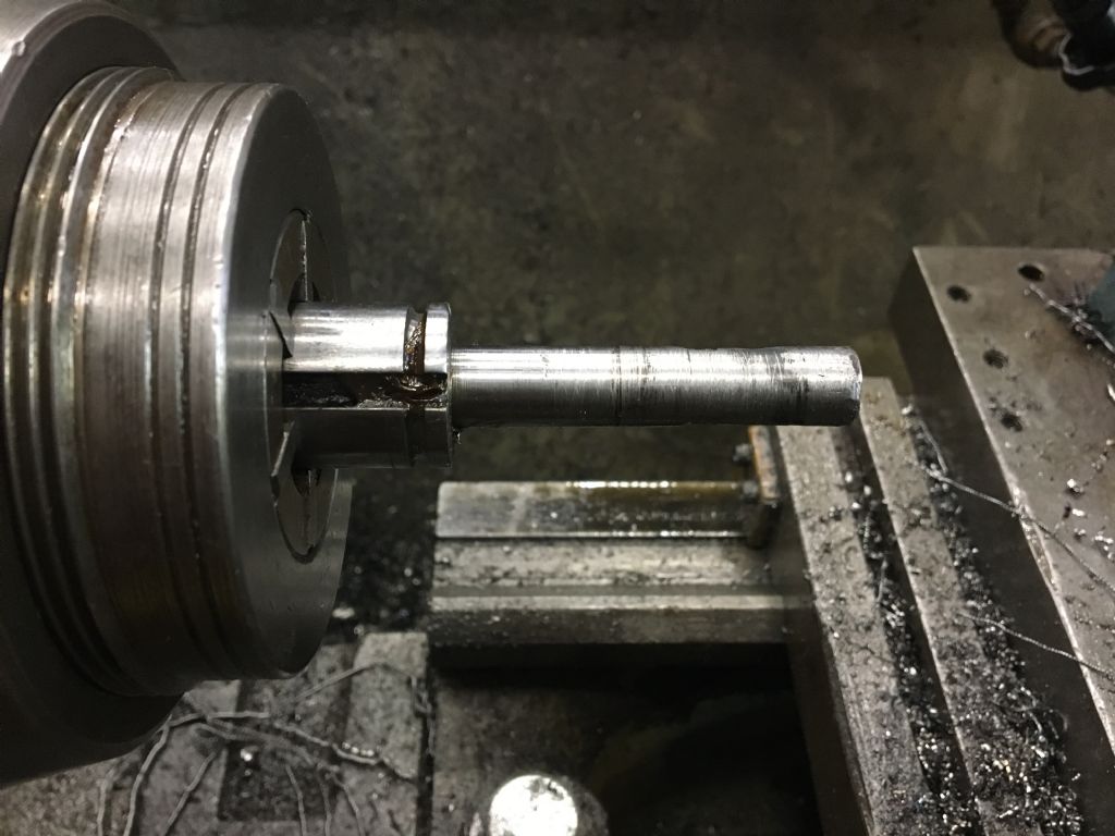

                                              Mark Guy
                                                @markguy26995
                                                254fa1b1-b181-42f6-9a16-037df7b88757.jpeg68c6adee-6d48-4b3b-a52b-f0912f5d914c.jpegMark,DC
                                                This end of the lead screw is .010 out around 5/16 from the screw( just as it leaves the bush) I’ve made the wheel end c/w taper hole and pin and was just thinking what your thoughts would be about turning it down say .030 unti concentric and boring the wheel end .002 under size over 2” and sweating it on.
                                                #515110
                                                Mark Guy
                                                  @markguy26995
                                                  DC
                                                  I’ve secured it in the lathe with a cone I’ve knocked up on the back side and nipped it up with lead screw nut and the back of the screw is supported with a packed stand and rubber lined v cup to prevent bounce. I’d be struggling with the mill as it all still in bits. Thanks for the advice
                                                  #516685
                                                  Pete Rimmer
                                                    @peterimmer30576
                                                    New gears made. Send me your postal details Mark
