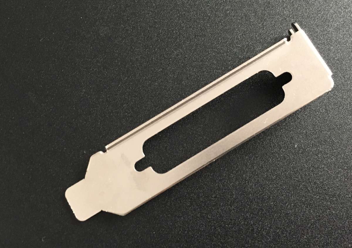

      This is a strange one, so I turn to the collective wisdom of the forum:
      I have an elderly DELL Optiplex 390 ‘Small Form Factor PC, for which I have just purchased a StarTech PEX1P/PEX1LP PCIe parallel port adapter.
      So far, so good … I’ve even sorted out Win 10 drivers for it.
      The problem is mechanical [!] … the half-height card will only fit into the machine if l remove its mounting plate. This is clearly not a practical solution.
      I am too blind or daft [probably both] to see exactly where the obstruction lies, So I’m hoping someone might have encountered the problem before.

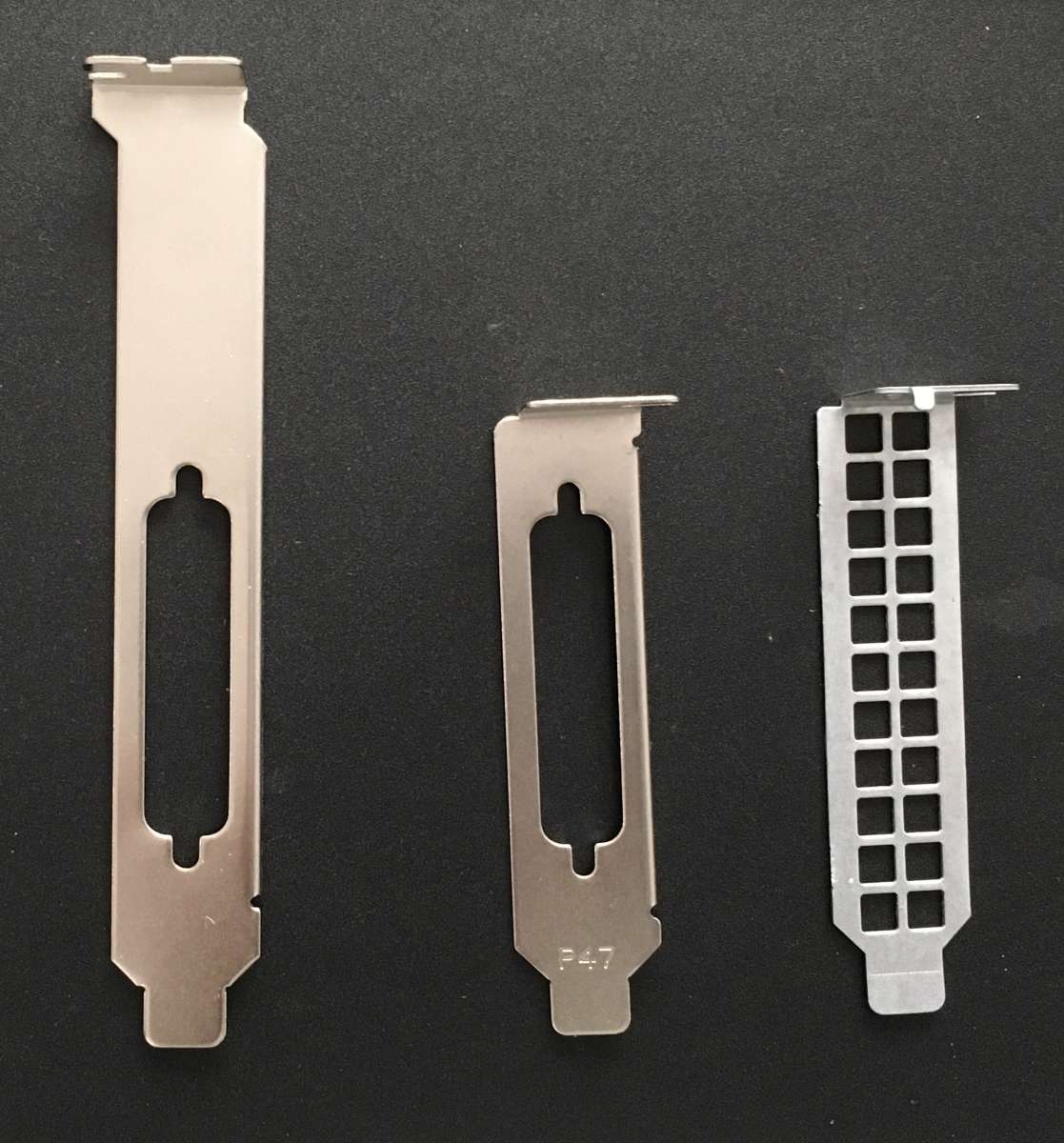

            Thanks, both
            They do … and it did [it’s an old item but new and unused]
            The problem [I think] is that the bulky Centronics connector is catching on something during the insertion process … space is very tight in the SFF but I wasn’t expecting this.
            Photos tomorrow; I’m too weary now.
            Refhttps://www.startech.com/en-gb/cards-adapters/pex1plp

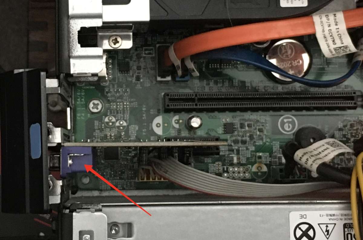

                  It’s tight in there:
                  IMG_0957
                  Centronics connector is arrowed
                  Card [without its plate] sits perfectly in the x1 PCIe slot
                  … but with the plate attached, it’s like trying to manoeuvre a grand piano through a doorway !
                  It may be possible, but I haven’t worked-out how 🙁

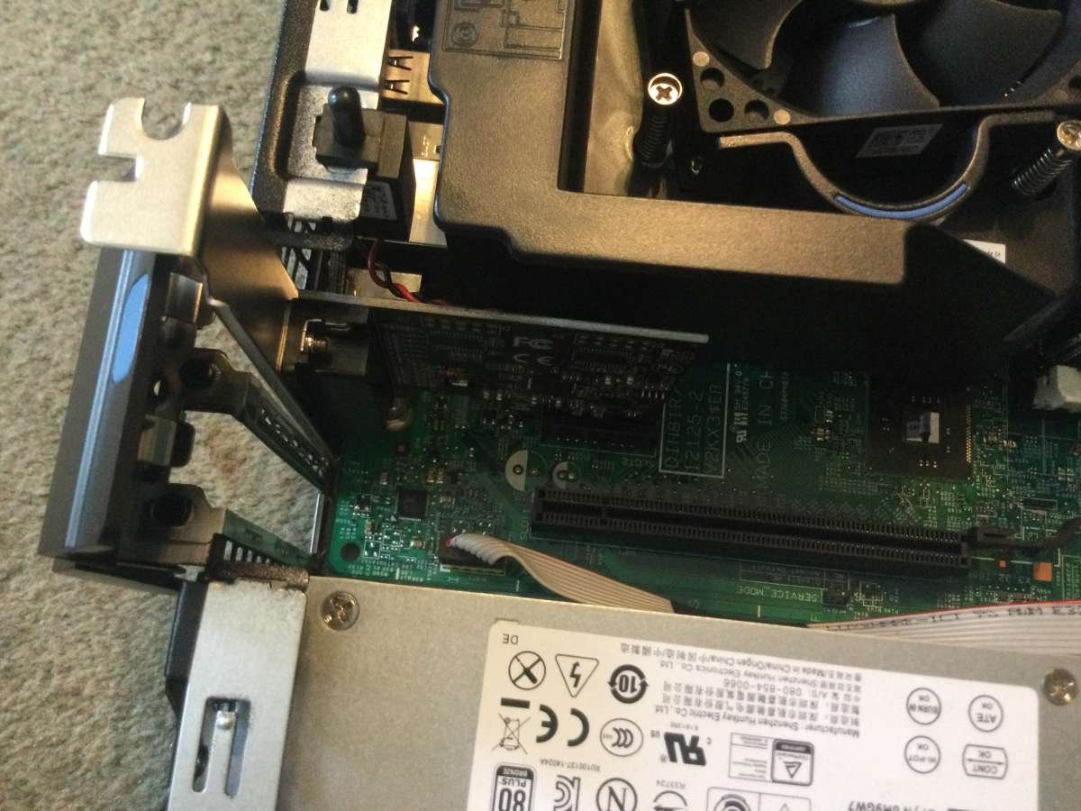

                  #811278

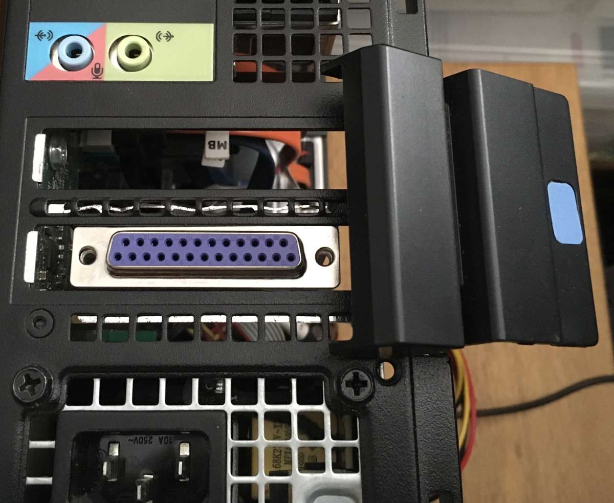

                    Stuart Smith 5
                      @stuartsmith5
                      Michael
                      I struggled a bit with mine but there is a slot for the end of the plate and it should just push straight down if you get it lined up.
                      Stuartimage
                      #811295
                        Emboldened by your success, Stuart … I have finally succeeded
                        With the upper screw removed, and the lower one slackened right off, there was just sufficient flexibility to wriggle the card into its slot and  the bracket into its position … Not an experience I wish to repeat !
                        It’s all tidy now, and <phew!> the card has survived its excessive handling.

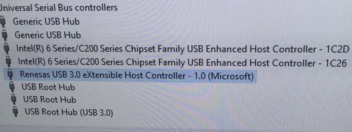

                          That was sorted just in time
                          This little beauty arrived in today’s post
                          https://www.ebay.co.uk/itm/176386734029
                          and after [in infinite monkeys mode] persuading Windows to load the correct driver, all is looking good.
                          IMG_0959
