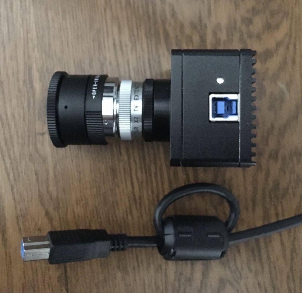

        I have a rather nice little Motic C-mount camera, but the USB 3.0 cable that came with it is bulky, heavy, and too stiff !
        Type A connector for the computer, and the’double-decker’ Type B for the camera … The big problem is the clip-on Ferrite, located on a loop of cable near the camera connector.
        First : A question for our Electronics experts … Does the Ferrite need to be located at the camera-end or would it still do its job if located near the mid-point of the cable ?
        Second : can anyone suggest a suitable replacement cable ? … Flat and/or Flexible, and preferably without an enormous Ferrite contraption on it.
        Thanks

        #662326
        Ian Parkin
          @ianparkin39383
          Just unclip the ferrite and do without it ….i've never found that they make any difference
          or relocate to where you want it
          #662328
            Thanks, Ian
            I was nervous about doing that, because of stories about USB 3.0 interfering with both Bluetooth and Wi-Fi
            #698311
            John Doe 2
              @johndoe2
              Yes, the ferrite is required and it does need to be located as close to the device as possible. (In these very cost conscious times, manufacturers would not include something unless it was absolutely needed!).
              It is there to suppress radio frequency interference, (RFI), from the device, radiating to other devices, and interfering with them. (The cable acts as an aerial).
              Removing the ferrite might seem to have no discernible effect, but for example, your mobile phone reception at home might become slightly worse, or your Wi-Fi might become slower, or less reliable in some rooms. Devices using Wi-Fi might become unreliable, (which could have safety implications). Your computer might occasionally misbehave, or your TV signal might suffer interference on some channels.
              Not suppressing RFI is a bit like dropping litter – you probably won’t be seen or caught, but you will contribute to turning the place into a dump, metaphorically.
              (I am not judging at all, just saying).

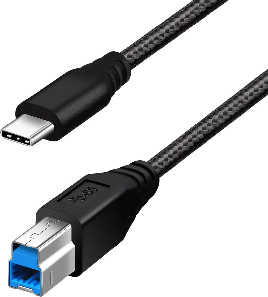

              #698312
              Journeyman
                @journeyman
                This nylon braided type might be more flexible. This is USB 3B to USB C just a guess as you haven’t mentioned the other end of the cable!
                usbcable
                #698313
                  A good guess, John …thanks
                  I have two Mac minis [an Intel and an M1]
                  Both have USB Type A connectors, but theThunderbolt connectors are different styles.
                  See Wikipedia:
                  https://en.wikipedia.org/wiki/Thunderbolt_(interface)
                  Cable flexibility is only an issue at the camera-end though.

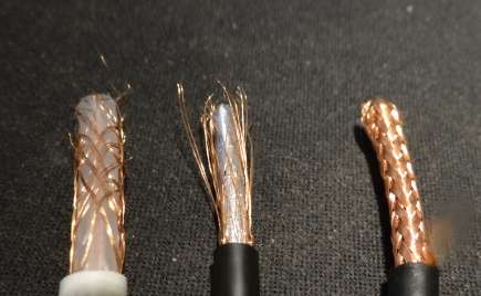

                                  Often a big gap between theory and practice!  USB cables are supposed to be shielded, but that doesn’t mean they are, or that the shielding is as good as it might be.
                                  This photo is of 3 examples of the shielding in coaxial cable.
                                  DSC06825
                                  The white cable is DIY store 75 ohm TV down lead. Cheap because the mesh is widely spaced and there’s not much copper in the shield.  Whilst the shield is only mildly effective there’s a good chance most of us would get away with it, but the coax is too cheap in an area of marginal reception.
                                  Centre example is inexpensive Satellite cable. Better because the shield is beefed up by aluminium foil, but lossy because Aluminium is a poor conductor compared with Copper.   Inferior rather than awful, but fit for purpose in most domestic installations.
                                  The Black cable on the right is RG58C, a reasonably good 50 ohm communications coax.  The shield is a tightly woven copper mesh, much denser than the other two cables, and it is much better at keeping transmit power inside the cable and keeping interference out.  Not the best money can buy by a long shot – I have some coax about finger diameter where the silver plated copper inner is shielded by a tight silver-plated mesh, wrapped in thick copper tape, and again by a second tight copper mesh.  It’s too expensive to use!
                                  How well even the best shielding works depends on how the cable is terminated.  Ideally there’s an exact impedance match and differential cables are balanced exactly, but these conditions are unlikely to be met unless particular care is taken.   If either is off, common mode currents bypass the shield.   For example, wires in cheap USB connectors are often soldered direct to the pins, and the result is unlikely to be balanced.  Better connectors mate the pins and wires via a small printed circuit board, one we hope was designed to provide a good match. Mileage may vary.
                                  A ferrite choke might not be necessary if everything else was tickety-boo, but this is an imperfect world.
