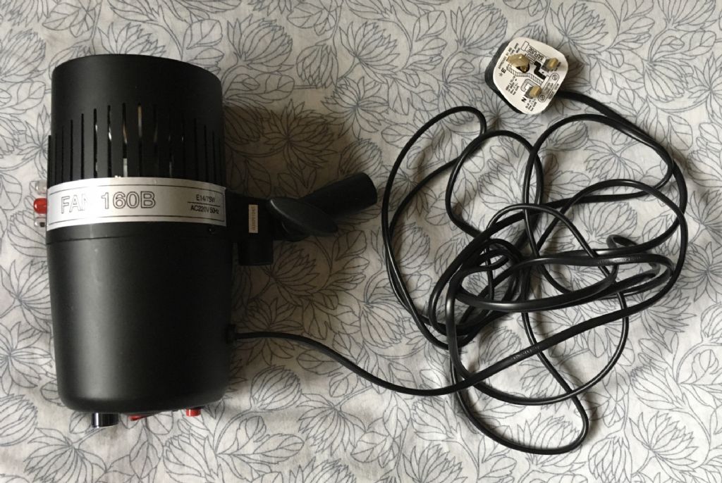

        I have a new mains-powered ‘Studio’ flash head which, rather inconveniently, has a fixed mains lead [2-core U.K.]
        I propose to cut it short, and add an in-line connector; so that the long lead can be stored separately.
        The obvious question is : What connector would our electrical experts recommend ?

                          #560572
                            Thanks for the further input yes
                            Just to show the scale of the problem, here’s a quick snapshot of the unit:
                            It came crammed into a surprisingly small cardboard box … but there’s no way I would want to use that for storage.
                            What I was hoping to do is snip the lead at about 9” from the Heyco strain relief, and insert a pluggable [and preferably locking] connecter with a much more flexible mains lead. … then I would be able to store the two separately.
                            P.S. __ Sorry there’s no fill-in flash on that snapshot !

                                  Thanks, Robert …
                                  I am hoping to avoid opening the unit; but if nothing more suitable appears, I may end up putting one of those in a little box on the shortened lead.
                                  Ref. __ https://www.farnell.com/datasheets/2108396.pdf
                                  P.S. __ The ‘studio’ in question is my table-top light tent.
