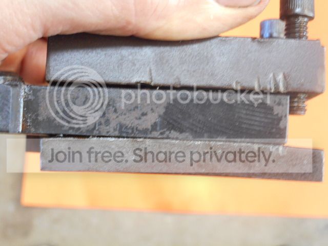

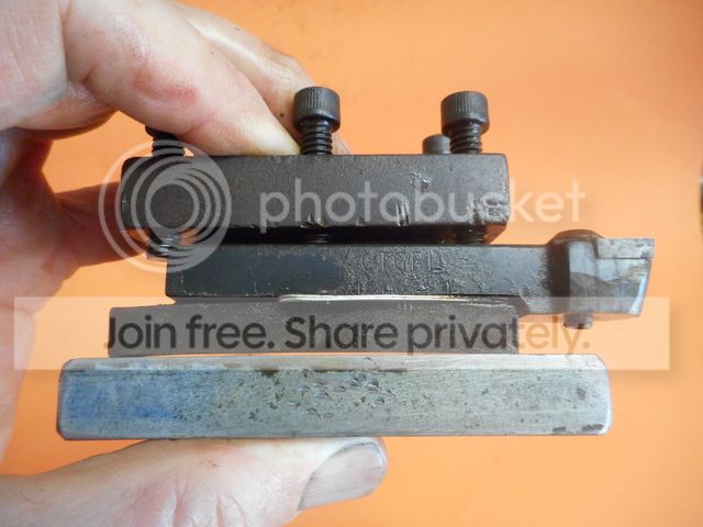

                                                Another crime against engineering was discovered this morning during the cleaning process. The Myford four-way toolpost has been bent like a banana from some lunk of an electricion overtightening the tool clamping screws. The once flat base now measured as having an .018" bow in the middle.
                                                See the gap between the tool and the holder at the left? And what are those gashes at teh right? They do not line up right to be any kind of chuck crash scars. Only thing I can thnk of that makes a mark like that is a chisel!
                                                A gap you could drive a Mack truck through. Well, an .018" tall Mack truck any way. How long a pipe did they have over the allen key to do this? Once again supports the idea that hand tools and not guns should be licensed.

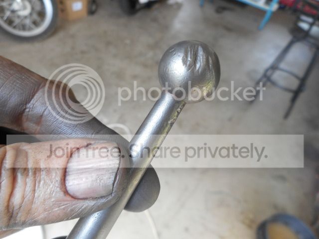

                                                And then there was the ball handle with obvious clout marks from when for some reason the toolpost would not seat firmly!
                                                Luckily I have a 20-ton workshop press so the toolpost will come out straight, maybe with a light mill or even just file to finish it off with minimum loss of metal thickness.
                                                Again, not as stoutly made as the Mighty Drummond, because the smaller top slide lets the toolpost hang out over the edges into mid air, allowing the 5/16" thick bottom of the toolpost to bend. On the Drummond, it originally had an alloy steel "Norman Patent" single tool post, but when I made a 3" square toolpost for it, it matched exactly with the edge of the topslide, giving full support that would never allow this to happen.
