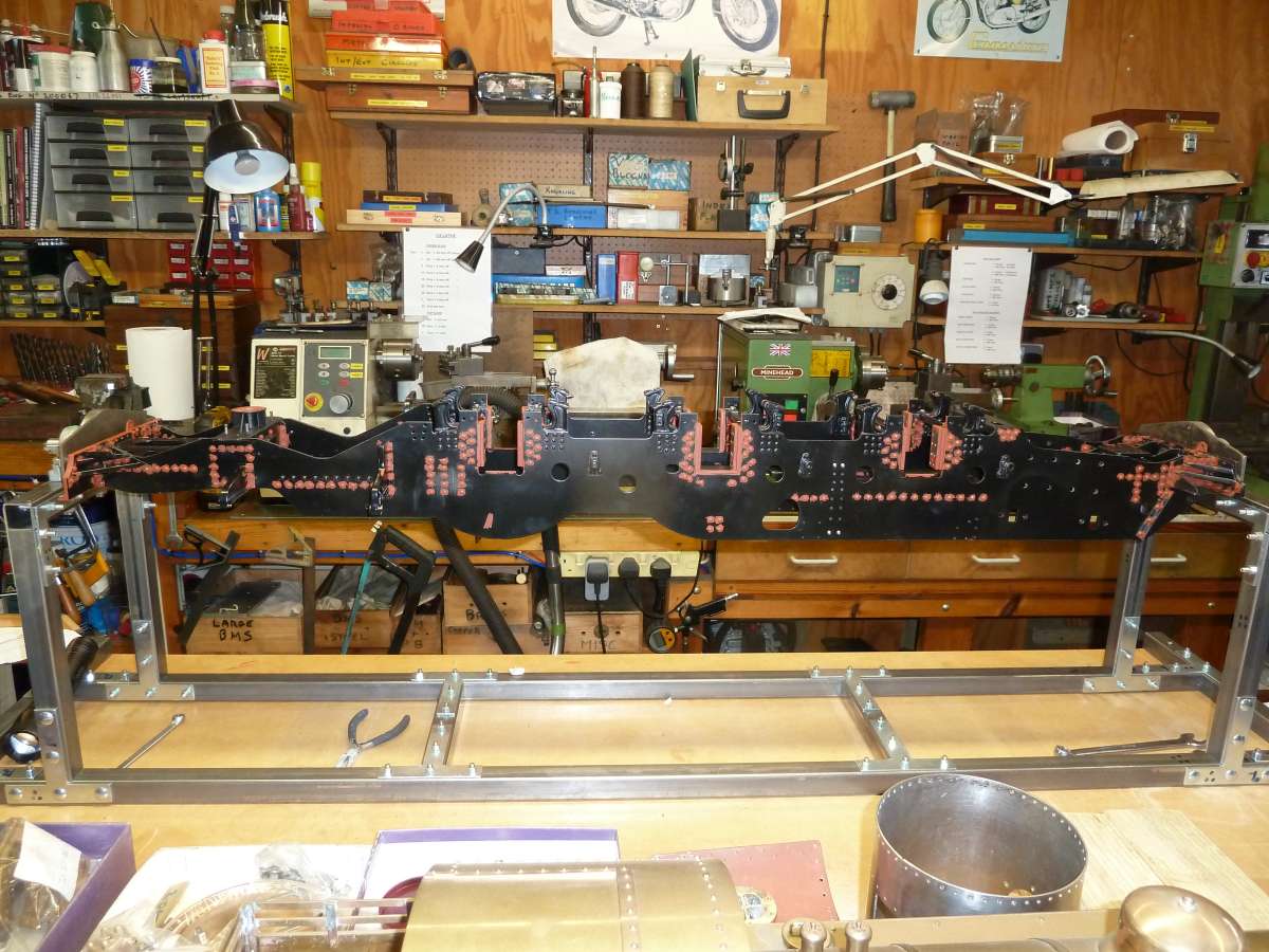

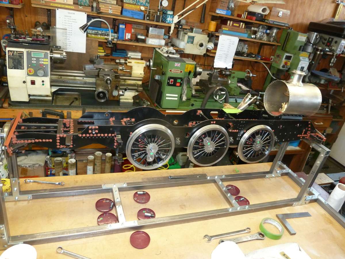

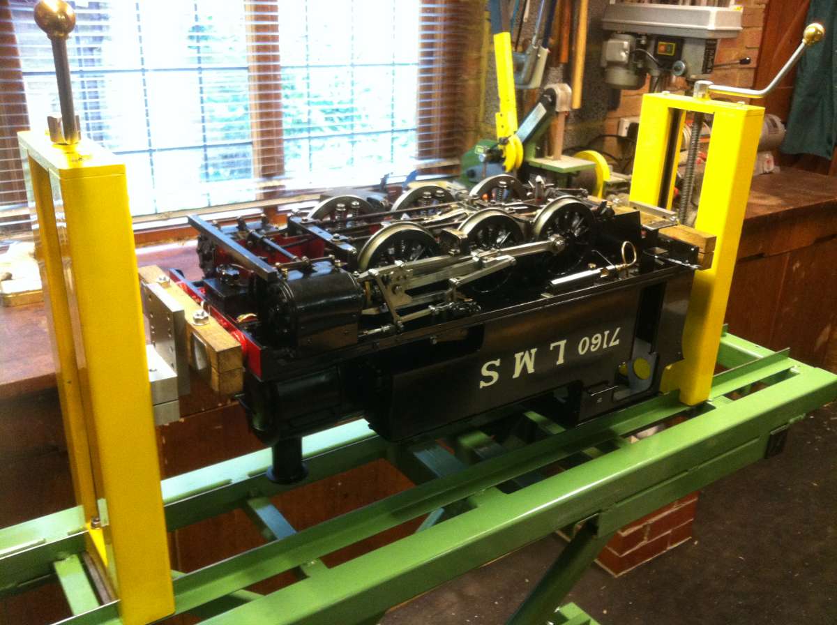

              The problem is going to come when you add the boiler and the CofG of the swivel point needs raising. It will need plates on the ends of the frames at a new distance away from the buffer height datum. So you will have to raise and lower the loco with some other support and jacking system. Also, when you are finished what will be around 100kg needs to be removed from the frame and easily placed on a trolley with rails. 100kg is a four person lift without mechanical assistance.
              I built a wheeled trolley, with rails on top, then strong vertical supports that bolt to the trolley frame with vertical screws (like a lathe feed screw) to raise or lower a block at each end. Each block has a large pin about which a friction clamp can rotate. Affixed to the clamp are plates to allow CofG adjustment. One of the plates grips firmly to the end of the loco frames. The decorative buffer beams can be left off until the loco is in its final build stages.
              The photo shows my assembly supporting a 45kg 0-6-0 with wooden clamps around the buffer stocks. More recently the same frames, with adjusted CofG have supported a 100kg Britannia but with steel clamps around the frame ends. With the CofG adjusted to within a few mm the loco can be turned by hand.
              I only post this in case it helps you plan ahead.

                I have a piece of unistrut supported from the rafters. Using this in combination with the scissor lift trolley gets away from difficulty of lifting loco onto rotating stand. I found having the pivot a bit above the buffer beam made the whole thing balance with the boiler on.

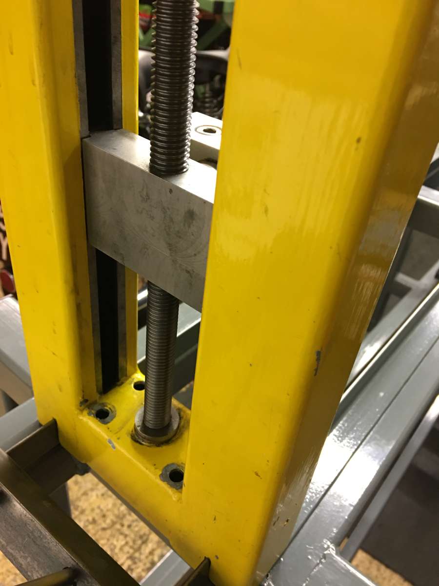

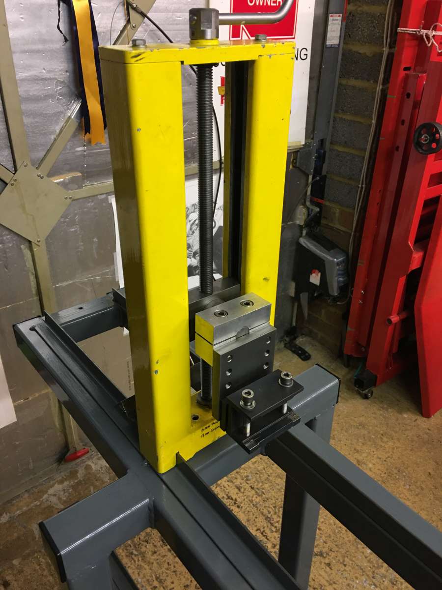

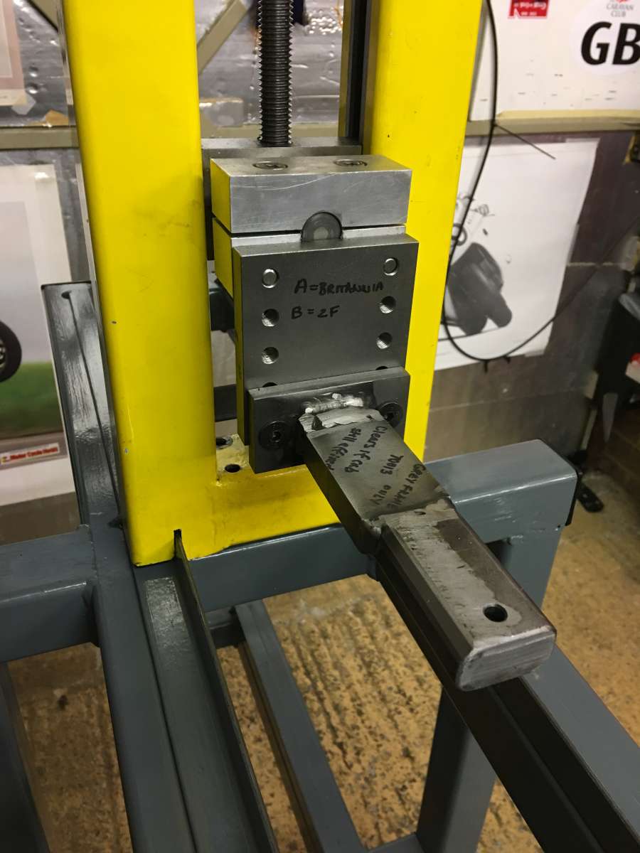

                              The uprights are steel box section with a milled out slot in one side. Welded cross member at the bottom and bolt on stretcher at the top to allow assembly. The central steel carrier runs vertically in those slots and takes any side or twist thrust to keep the screw thread unloaded. A welded pin in that carrier has a split aluminium clamp gripping it. The screws allow grip adjustment. The drilled steel plate allows height adjustment to enable loco rotation along (near to) its CofG. It is important that the mounting to the loco is rigid and does not impose any downward twist. The towers could be half the height shown and would still allow full rotation.
                              One photo shows a mounting clamp that is attached to the loco front frame stretcher with buffer beam and stocks removed. The other shows a long steel tongue that goes into the rear loco drag box.
                              Hope these are of some interest.
