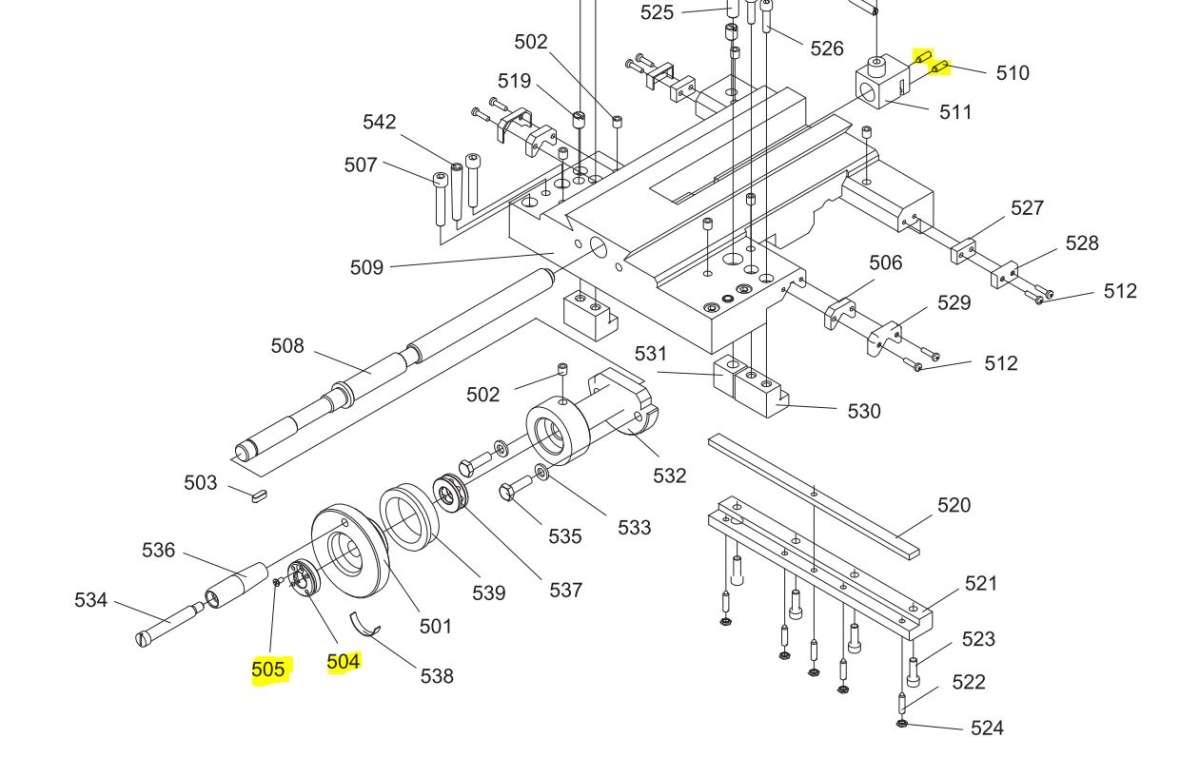

    Perko7
      @perko7

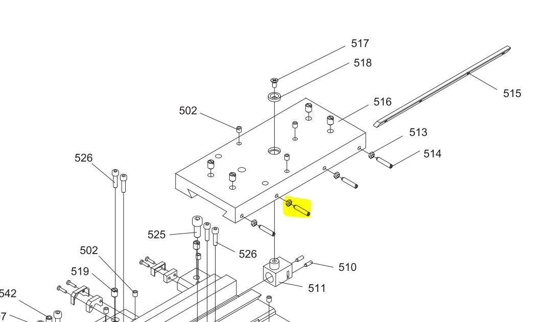

      Trolled through the forum headings but could not see anything related to this question.  I have had problems turning longish shafts like loco axles in the lathe and getting an even diameter along the length. The problem is not with the lathe alignment which I have checked, the problem is the top-slide moving during the traverse. The lathe is a Sieg C6 and there appears to be no way to lock the top-slide in position while traversing the carriage along the lathe bed. Has anyone else had this problem? Currently I have to hold the topslide leadscrew handle during the cut which is awkward. The topslide leadscrew wants to move during the traverse and I can’t see how to tighten it. There is also a bit more backlash on the topslide leadscrew than I would like but I can’t see how to overcome this as the exploded diagram in the owners manual is a bit hard to follow.
      I thought about tightening the gibs to lock it in place but then I would have to loosen them again after every traverse to return the carriage to the tailstock end ready for the next cut.
      Any advice appreciated particularly from any Sieg (or clone) owners.
      Thanks in advance

        Could you just tighten one gib screw?  Or if you are confident, dismantle the topslide and add a new threaded hole for a locking screw to bear on the gib.  Topslides are generally more trouble than they are worth IMHO.
        #747076
          Set the topslide parallel to the lathe axis then any movement will be in the same direction of the cut and not alter the diameter.
          Are there adjusting screws on the cross slide nut? most imported lathes seem to use this method to take up wear.

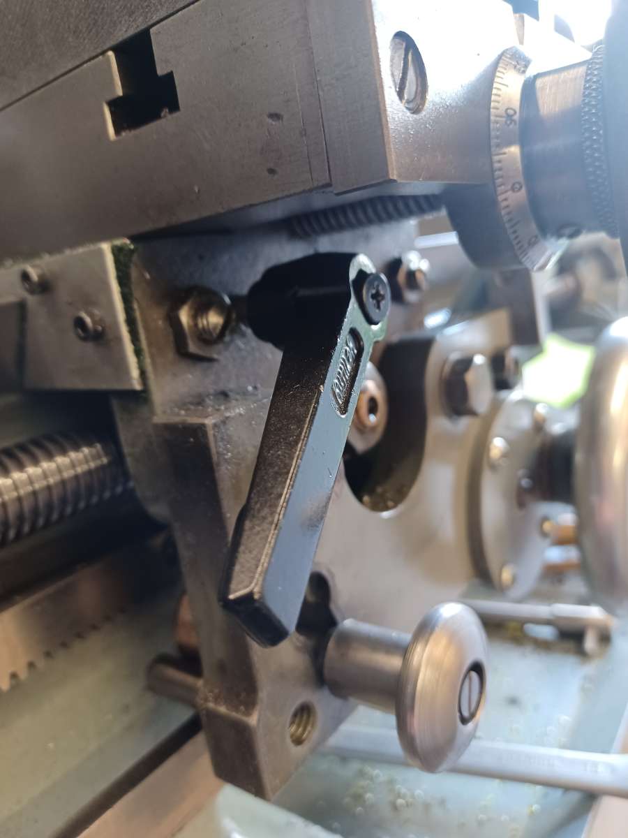

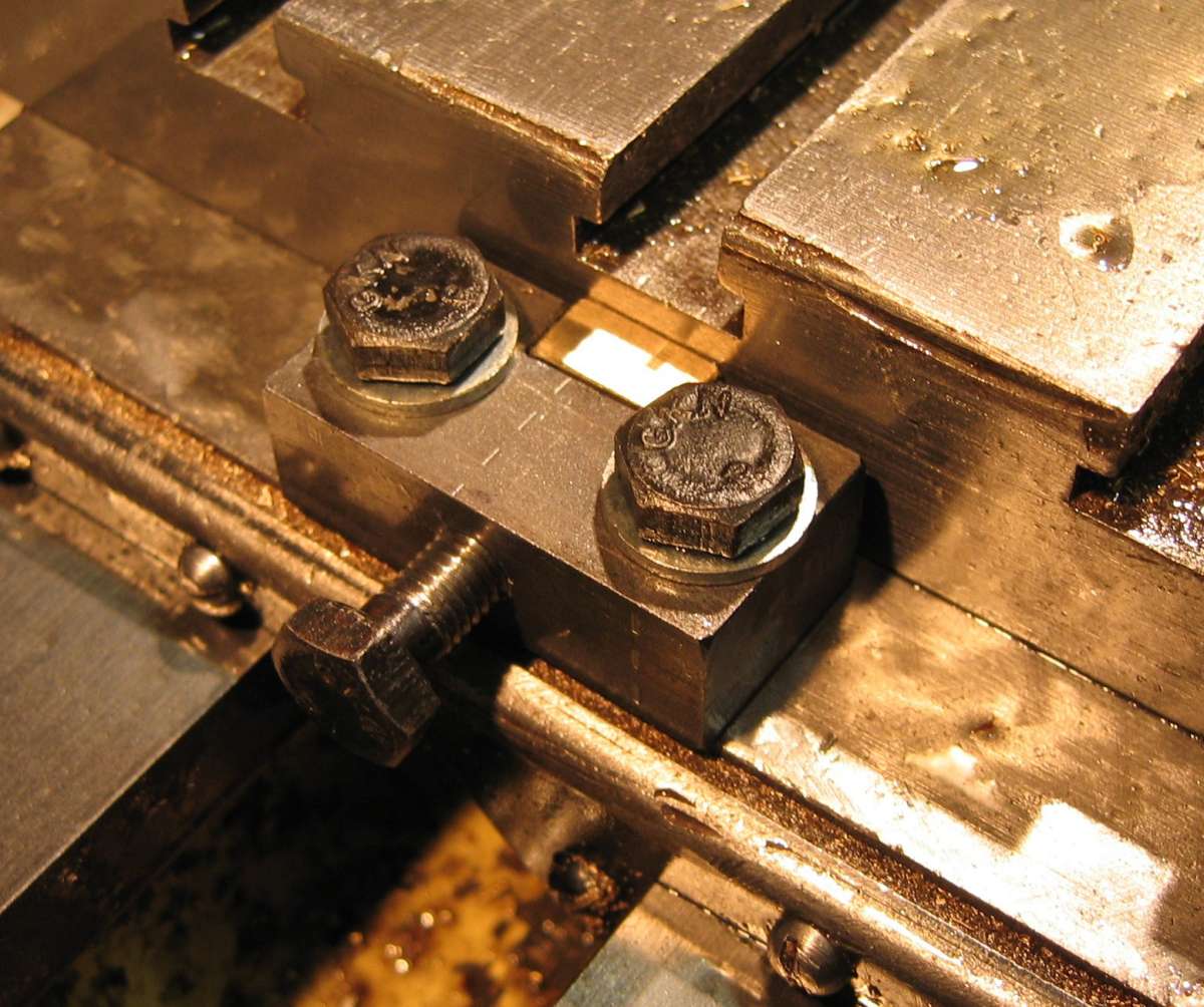

                    On my old Myford Super 7 I used a very simple clamp that used the travelling steady bolt holes. This appeared in the ME quite a few years ago.
                    finished 1 a
                    Since these two holes are not on my current lathe I use a GHT top slide type lock, frequently.DSCN6172
                    As for “storing” the top slide I put it at 0degrees, parallel to the lathe’s axis. If you do this make sure it is at 0degrees……

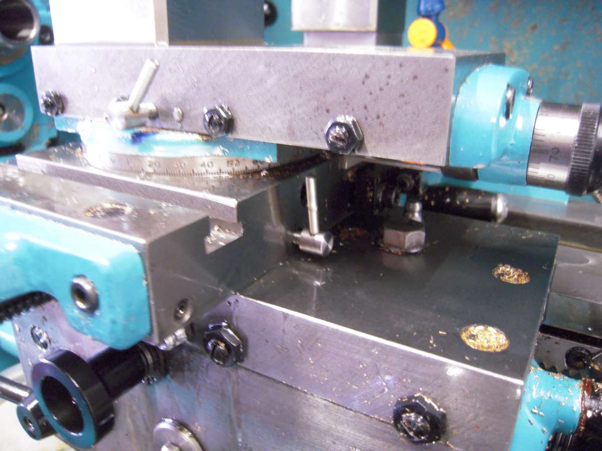

                          looking at the GHT lock this is in effect what my two Emcos and the current Warco have with a cap head screw. Keep meaning to add levers but never do. Similar on the two Sieg lathes which have bristol type levers

                              Are you talking about the topslide or the cross slide? It sounds more like the cross slide if you have to back it out to return the carriage. Whole different ballgame from the topslide.
                              For turning long diameters you can lock up the topslide gib screws and leave them locked. For the cross slide, the one that affects the diameter you are turning, you have three choices: fit the locking screws ala GH Thomas as described already, or nip up one of the gib screws and realease it every time for the return. Or adjust the gib screws so your cross slide can move but with a bit of resistance so it does not move under its own power, which it should not do.
                              Also on most lathes, you can tighten up the handle and or graduated collar on the feedscrew so the screw does not rotate freely but needs a bit of hand pressure to move it. Not sure on the Chinese stuff but Myfords use a fibre washer in there to provide a bit of friction when the handle is tightened up on the screw a bit.

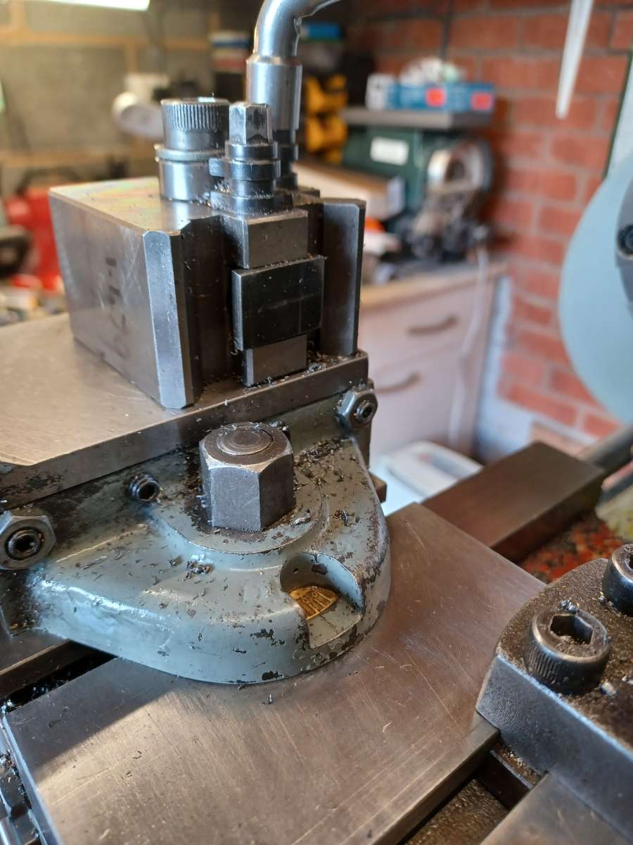

                                                @johnmc39344
                                                The biggest force generated when turning is the cutting force that acts, more or less, vertically downwards, the feed force is secondary. There is a tertiary force pushing the tool away from the work.  The resultant force is still dominated by the cutting force. (A generalisation, I know, but probably true for most turning)
                                                To move the top slide it suggests to me that the slide gibs could be a little tighter?

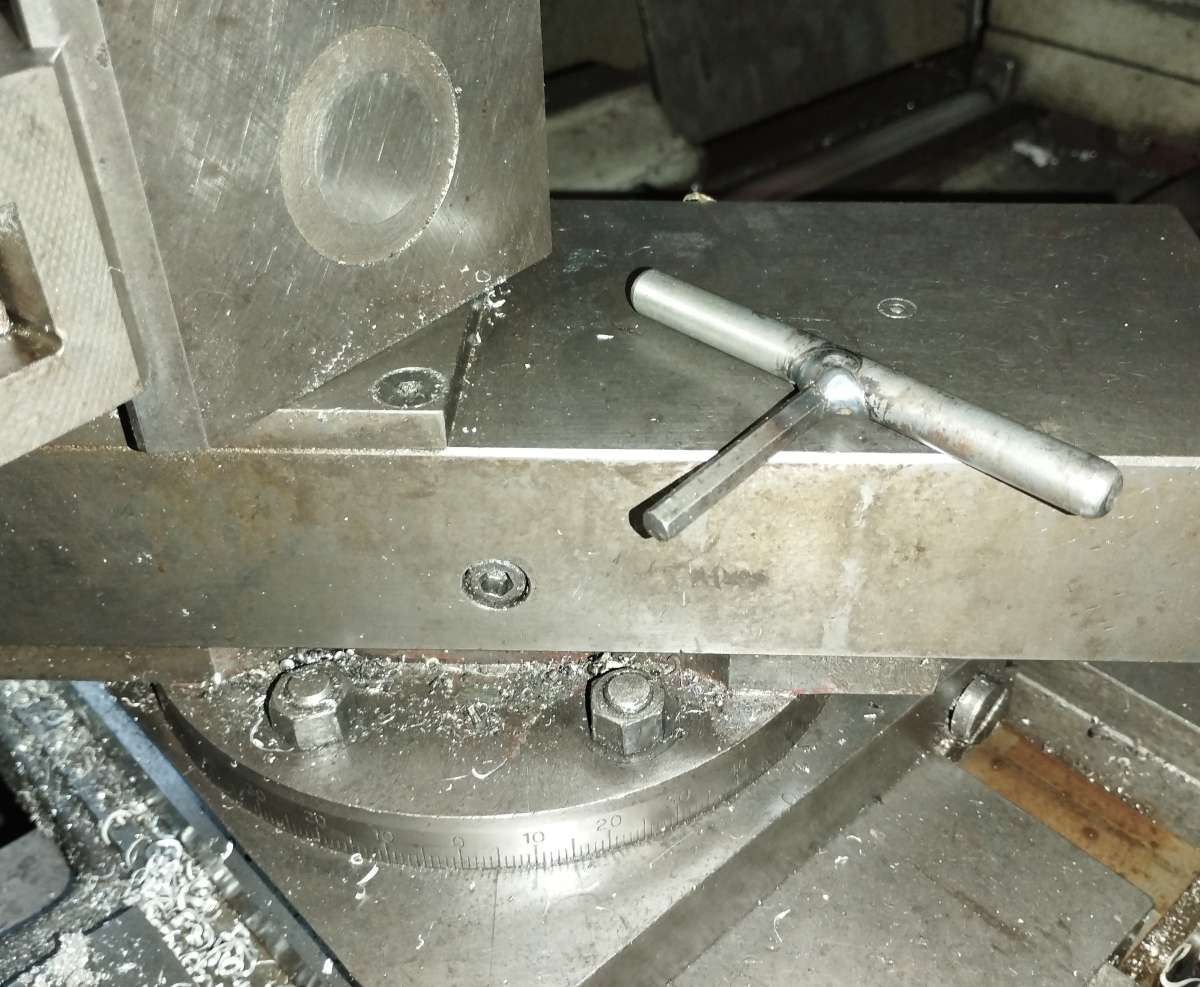

                                                The attached photo shows the top slide of a Colchester Triumph, the cap head screw clamps the (tapered) gib against the slide.  I usually leave it locked until the slide is needed.   I’ve duplicated the arrangement on my Chipmaster.
                                                Incidentally, I leave the top slide at 45 degrees unless there is a need for another angle, handy for chamfering.
                                                Triumph topslide lock

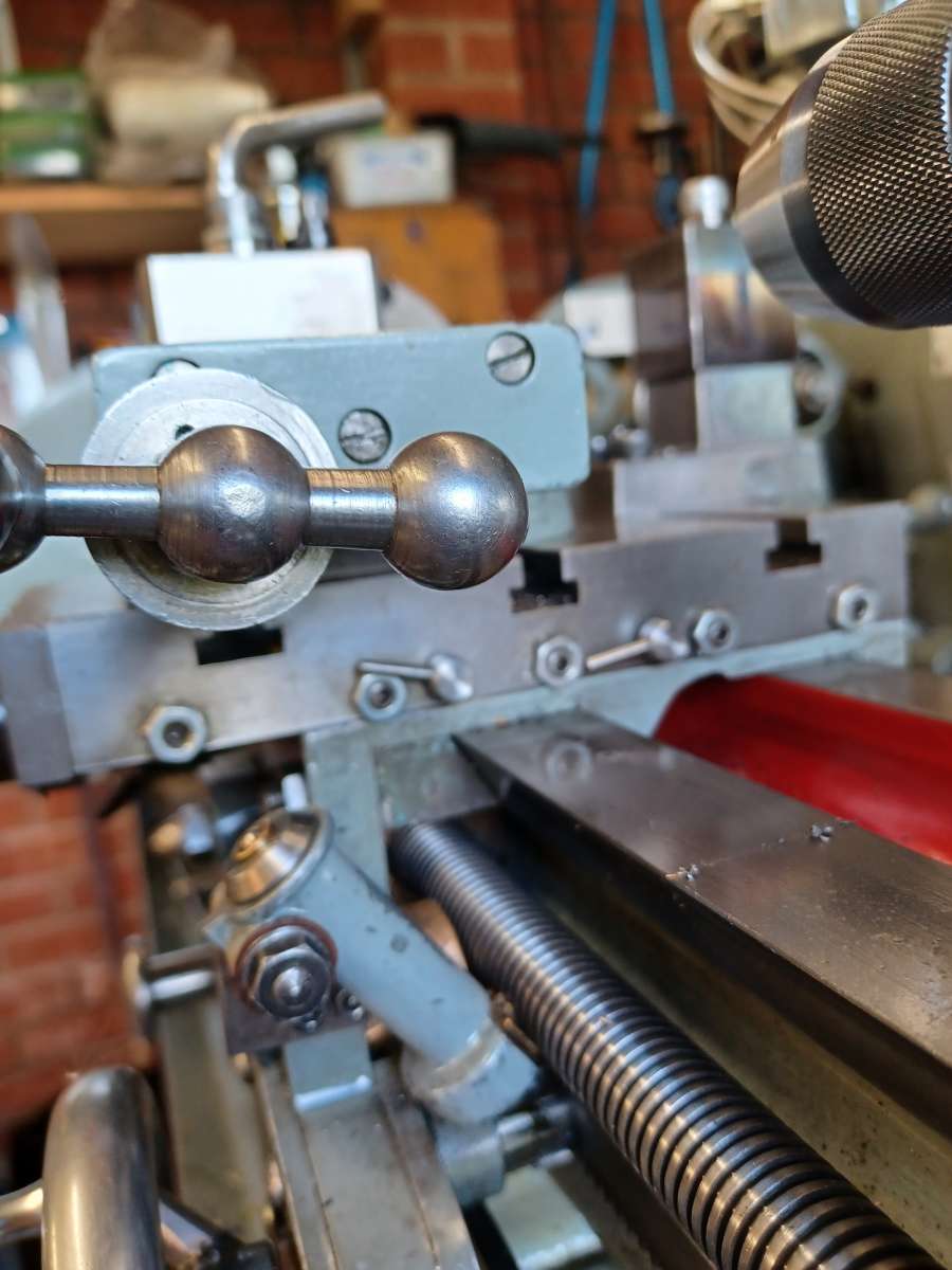

                                                      FWIW, My C3 has no lock for the Cros Slide, so I made one.
                                                      Because the gib adjusters are on the Tailstock side of the Cross slide, I made and fitted one to the Headstocj side
                                                      It is a crude but effective device.
                                                      The rear side of the saddle was tapped  M5 but because the front side of the saddle is over the vee , I could only drfill and insert a short dowel.  A short piece of bar waas drilled with appropriate sized through holes, and tapped, centrally in the other plane. Into this wa screwd a simple knurled brass screw.
                                                      This bears on the Cross Slide to lock it.
                                                      Maybe an easier way would have been to replace the cenytral gib adjuster with a simple knurled screw, and used that as a locl.
