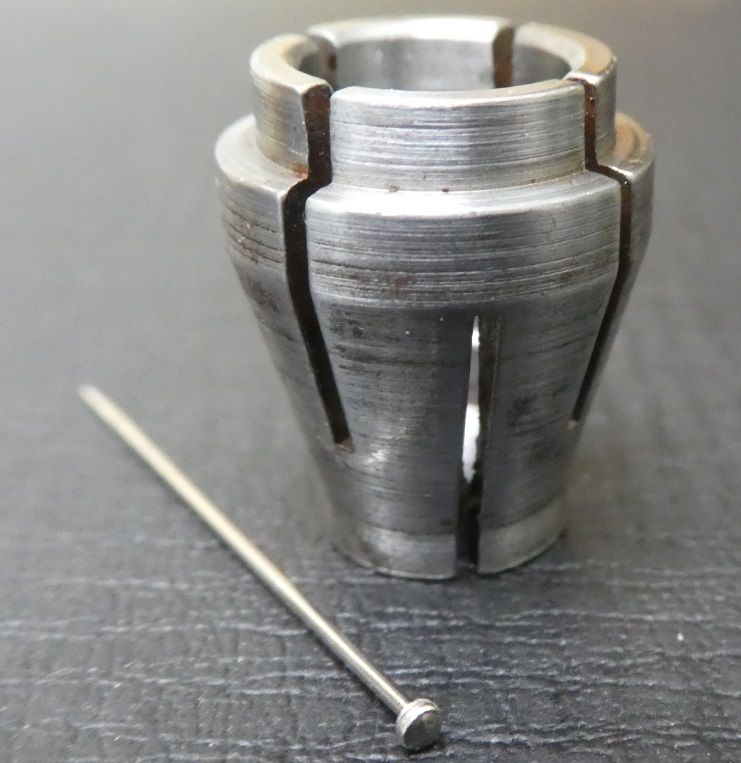

      I have several of this type of small collet and have often wondered what they fit. Does anyone have any idea?>>
      Overall length is 5/8" and the two diameters at the nose end are 17/32" and 27/64". The diameter at the back end is 11/32".>>
      The box they came in contained – amongst other bits – a half finished brass clock face but of course that could be a red herring!>>
      Rik
      >>colletnpin.jpg>>

          They look a bit like the collets we used in right angled windy drills – Desouter ??
          #301262
          John Haine
            @johnhaine32865
            I think they are made for the Taig lathe (can't remember what the brand is called over here. I bought a headstock for a dividing head project years ago (based I think on a Tony Jeffree design) with a set – they aren't very well finished are they!

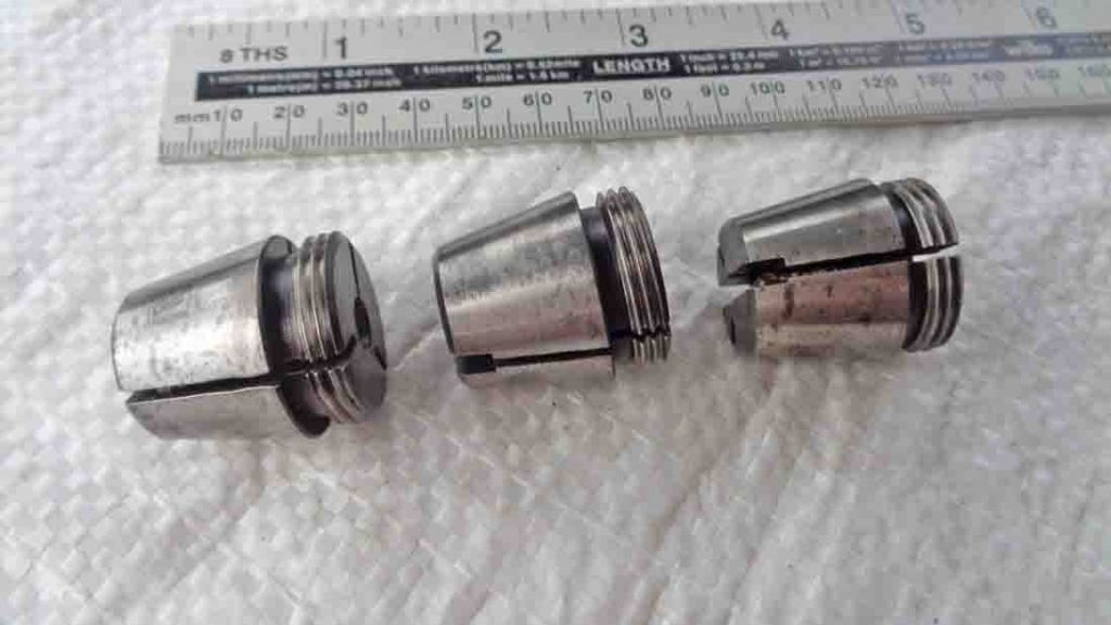

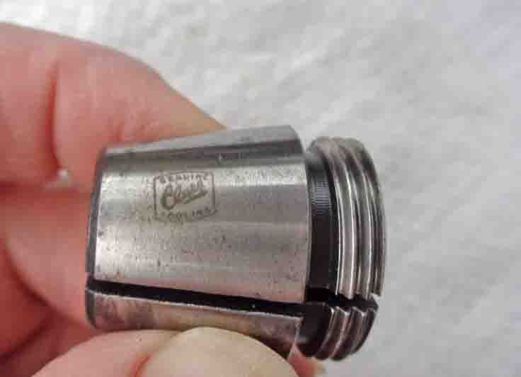

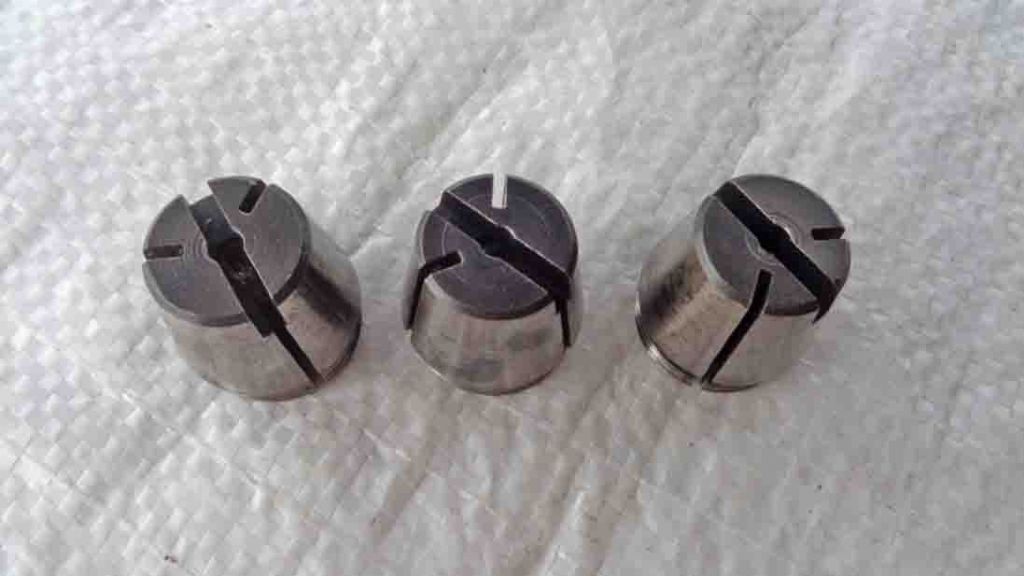

              Hi, bit of a hijack here but still on sort of topic! smiley
              Found these three small collets at tthe bottom of a crate of tooling this week. Cannot really make out the makers name CLARKE, CLARE, CLOSE ???
              Any help please.
              27mm long overall; threaded part is 24mm od; maxdiameter is 25.5mm

                Afternoon Martin, nice to chat albeit briefly. John, I have checked and it looks like you are right in suggesting TAIG. Having looked at their collets I seem to have the full set of seven.
                I agree, the one pictured does look a bit rough but my camera is very good at enhancing imperfections. Its not as bad as the picture shows. Good work chap and thank you!

                  Posted by Martin King 2 on 05/06/2017 14:16:14:
                  Any help please.
                  Cheers,
                  Martin
                  Clare Collets=Uk makers (Manchester possibly).
                  Sorry thats about all I know about them personally.
                  Edited By V8Eng on 05/06/2017 15:26:58
                  Edited By V8Eng on 05/06/2017 15:30:35
                  #301282
                  Martin King 2
                    @martinking2
                    Mmmmm, just looked at them and all three are 1/4"….. not so good.
                    Martin
                    #301291
                    Nigel Bennett
                      @nigelbennett69913
                      Clare collets were specifically for Clare milling cutters. They were unthreaded in the area where Clarkson cutters are, but they had a special tongue instead. The idea was that you inserted the cutter into an appropriately-sized collet, twisted it a few degrees to engage the tongue with the collet and then tightened the closing nut.
                      You can sometimes get Clare collets second-hand, but otherwise the collets are pretty well useless. They'll probably grip a Clarkson or plain cutter reasonably well, but the grip won't guarantee it being pulled out.
                      We used them back in the 1970s in the apprentice school!
