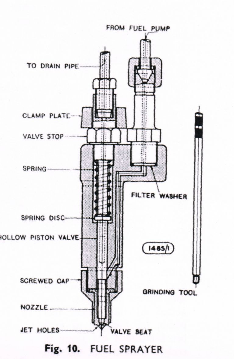

                        Ennech
                          @ennech
                          My Lister CS parts book does not give detail about the inside of the injector, however I round this drawing on the net, I hope that it helps.

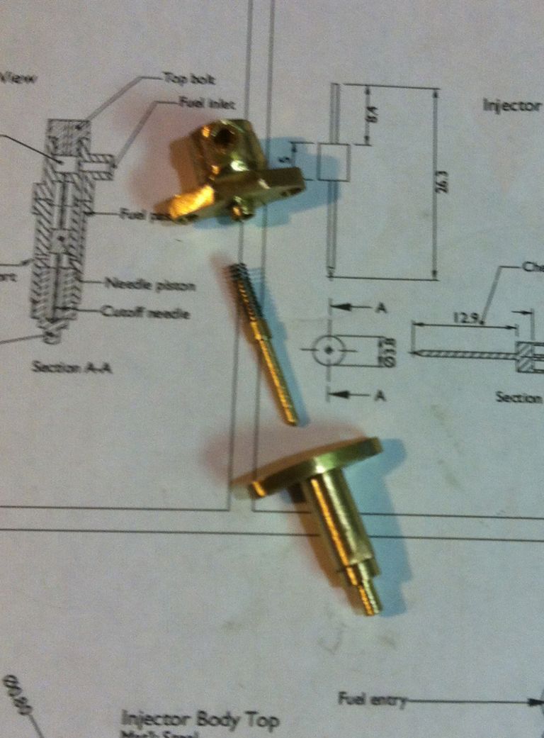

                            HobbyNut
                              @hobbynut
                              I am trying to figure out how the excess fuel gets to the top outlet "to overflow". This is almost exactly as George has drawn it, except that the inlet is at -90d from where this one is.
                              #126802
                              Ennech
                                @ennech
                                The fuel leaks past the piston as the injection pressure is high and there is always a clearance there.

                                HobbyNut
                                  @hobbynut
                                  injector parts.jpgMy injector. Will it work?
                                  #127123
                                  Ennech
                                    @ennech
                                    I can't quite see all the detail of your injector HobbyNut. Essentially the effective area of the injector plunger is the area of the piston minus the area of the needle where it sits on it's seating.
                                    The top of the plunger should be at atmospheric pressure which it will be if it is connected to the leak off pipe connected to the tank.
                                    The injection pressure (I do not know George's intended pressure) for the full size engine is 90 bars (1450psi), a relatively low figure by today's standards. The fitted load for the spring is given by multiplying the injection pressure by the effective area of the plunger.

                                    #127127
                                    Ennech
                                      @ennech
                                      Whoops! 90 bars is 1305 psi
                                      #127622
                                      Sub Mandrel
                                        @submandrel
                                        How do these injectors work? I can't see what lifts the valve? Or is it activated by cylinder pressure somehow?
                                        #127625
                                        martin perman 1
                                          @martinperman1
                                          Neil,
                                          At the top of the body is a threaded cap and a lock nut inside which is a strong spring, the spring applies pressure to the needle which has been lapped into its seat sealing off the nozzle end, when the pump applies pressure to the oil this lifts the needle which over comes the spring and lifts it to allow the fuel to leak past and out of the holes in the nozzle body as a spray. depending what the engine builder requires determines the type of nozzle and how many holes that are in it to produce the spray to help run the engine.

                                            #127752
                                            Sub Mandrel
                                              @submandrel
                                              Thanks, so presumably it is the pump itself that determines the timing?
                                              Oddly enough I managed to run out of diesel ina van yesterday (however the fuel pickup is arranged it didn't like a long, steep downhill). Fortunately I was only a few miles from the garage and my wife was following in the car. Equally fortunately, I had already found the priming pump on the fuel filter!
                                              #127753
                                              Ennech
                                                @ennech
                                                Yes Neil it is the pump that determines the timimg and the amount of fuel.
                                                The spring in the injector decides the injection pressure.
                                                Eric
