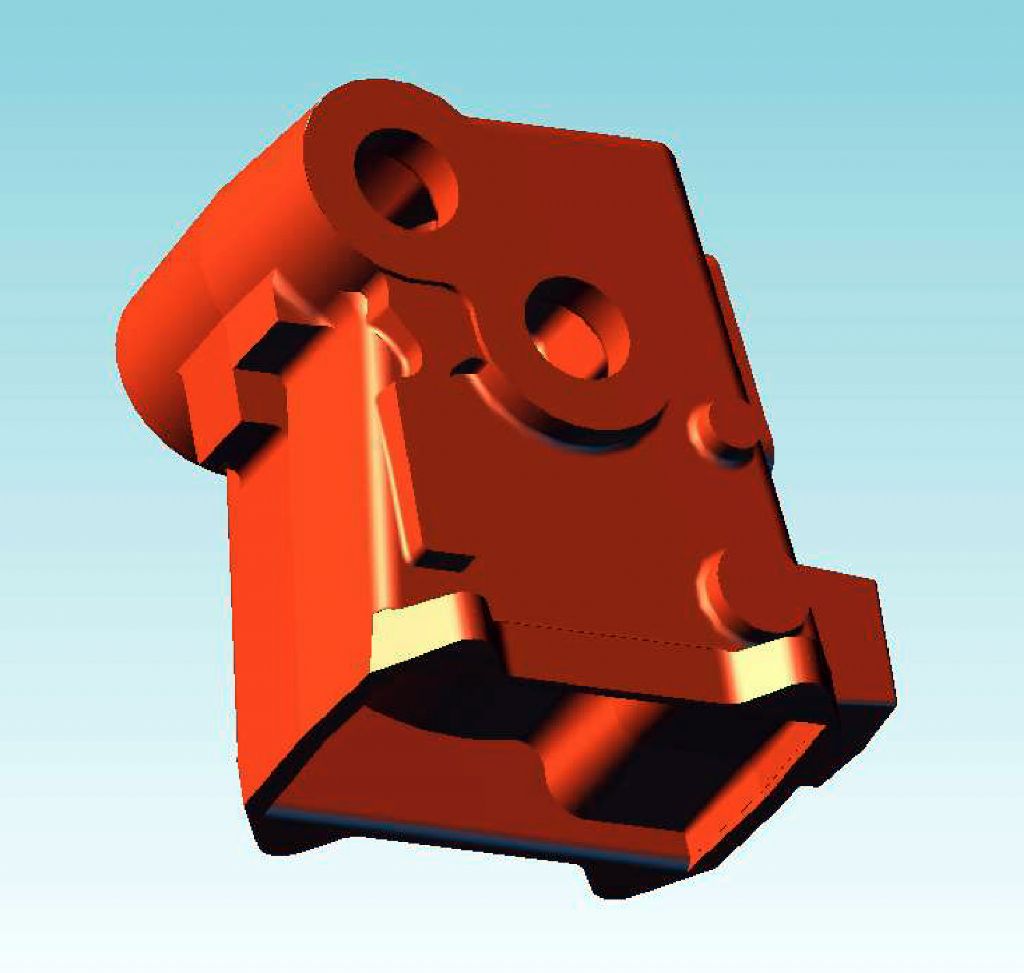

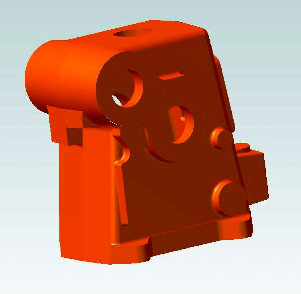

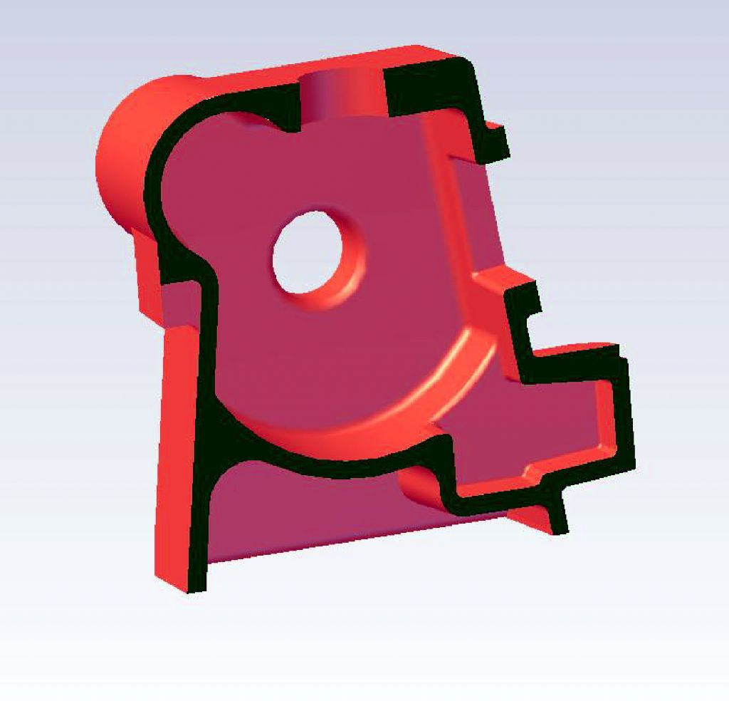

                                              Hi, I am new to this forum. On the subject of the crankcase casting, may I refer you to my thread?

                                                #111370
                                                Ennech
                                                  @ennech
                                                  I don;t have any more information than you. As for the feet I did a bit of guesswork based on a bit of scaling and the assumption that you original engine would have been made to imperial dimensions. Scaling indicates 3inches by 3 inches as the hole centres equivalent to 18inces by 18 inches on the full scale item.
                                                  #111378
                                                    Ah found your thread now, its here for anyone else looking.
                                                    #111688
                                                    Ennech
                                                      @ennech
                                                      I see that in issue 4449 additional bits have been added to the casting! It's a good thing that I did not machine the patterns last week! I attach my updated designs. from the section it will be seen that I have tapered the walls of the oil drain box slightly to improve the core strength.
