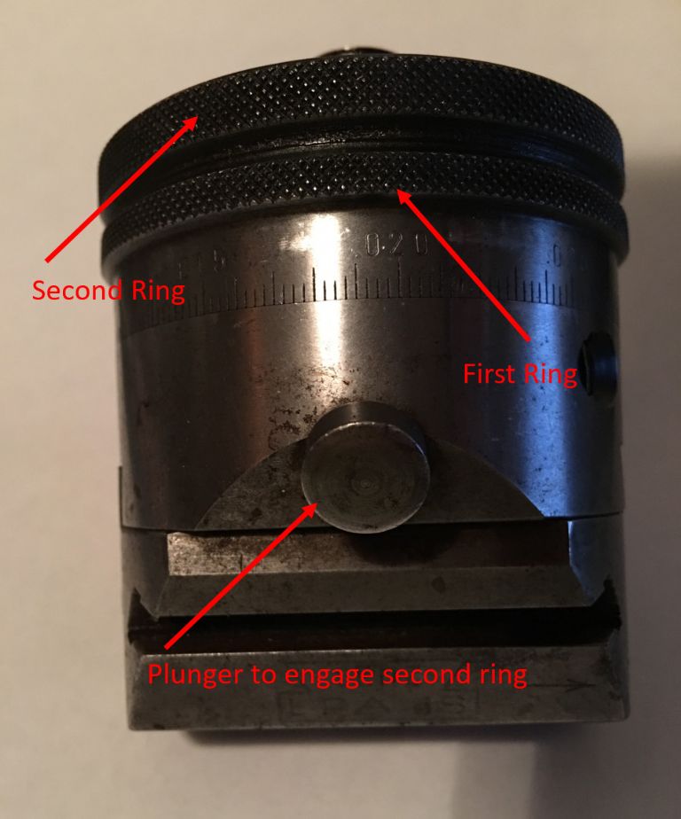

      I am in a quandary as to what to do with a Lenz LPA 1s automatic boring head I have acquired.
      It looks to be in good condition and the first ring on the head (lower ring) certainly moves the slide left and right but then I realised the second ring (Upper) did nothing even when the engage plunger was pushed in.

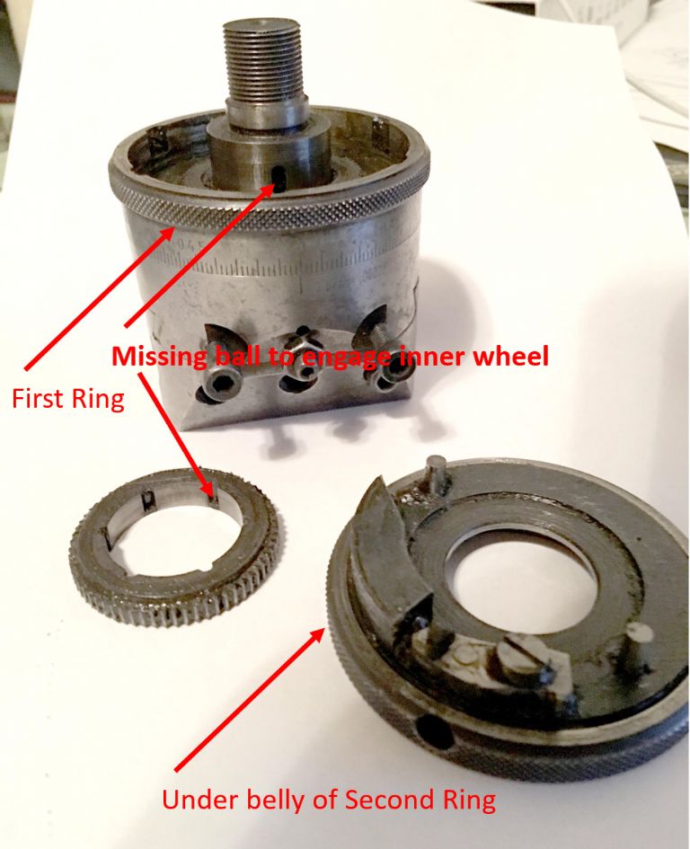

      On investigation the upper section seems to be missing a number of vital components…
      Plunger would have activated a second inner wheel (toothed cog) however there appears to be a ball / tooth missing to engage the wheel. This is an easy fix…

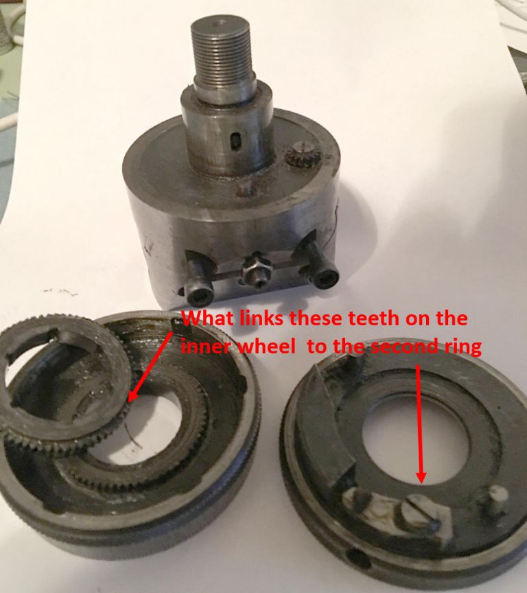

      But then I realised that with the inner wheel engaged…. There is a ???? missing to connect the inner ring to the second ring. The second ring appears to have a mechanism similar to a brake, or engagement lever. The wall also appears to have a ridge applied to it so that something can temporarily lock in place….
      Does anyone have an exploded diagram of this type of head as I have trawled the intraweb thingy and there is nothing?
      Any help restoring this would be appreciated.
      Dan

        Alan Waddington 2
          @alanwaddington2
          I think there might be two small gears missing from the two posts stuck up from the underbelly
          I'm not familiar with that particular head, but have recently stripped a poorly Kuroda head which looked very similar in design, and it had the two small gears.
          have a look in my photo archive, there are some pictures which might explain better.

            I had wondered what those pegs were however having looked at your photos which has a gear upper and lower and from the photo above the toothed wheel is split which I had originally thought was done to slot the upper ring so that it could be engaged via the plunger.
            I am now thinking that the geared wheels that sit on the pegs could also be split. one for upper toothed ring and one for lower ring….

              By some mad coincidence I've just picked up a complete and (hopefully) working Lenz LPA1 as a replacement for the defunct Kuroda, it came with a full instruction and parts manual complete with drawings. Have got a pretty full on week coming up, but if I get the chance I'll scan it for you, if not, then will do it at the weekend. Bad news is you should definitely have two small planetary gears present.

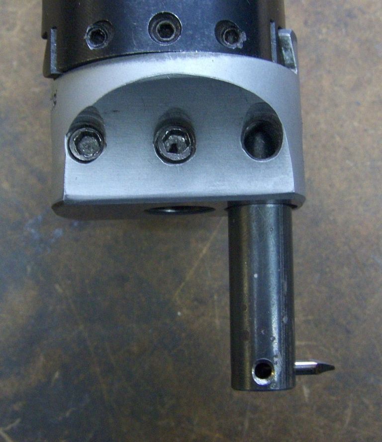

                          I have the same boring head on a R8 shank. It has 15mm holes for the cutters but nobody seems to supply these. I would appreciate any ideas on the best route forwards. Can larger boring cutters be ground down? Can the holes be easily opened out to 16mm. Does anyone service these heads? I would like to get it to work because otherwise I rely on a c****y Chinese boring head which is rubbish to set very accurately.

                            You could just turn a reducing sleeve to fit in the 15mm hole and bore it to take 12mm or 1/2" tooling, put ahole in the side so the grub screw bears on the tool and does not crush the sleeve.
                            Or just make a simple 15mm dia bar drilled through for an hss toolbit and cross drilled for a grub screw to retain the bit, something like this
                            Both these options are standard equipment for boring and facing heads and also better quality boring heads, even those from the far east
