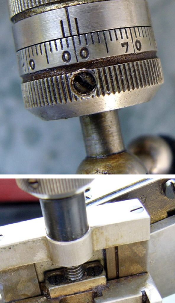

      appealing for some info on a ww83 leinin lathe sliderest…cannot identify thread on feedscrews.. hoping to make new nut for xslide..dia is 5mm , but not metric or ba..or even unf or bsf…pitch seems slightly coarser than 5mm metric…tried lathes.co…websites etc…totally stumped …did
      german lathe makers use special threads..same situation with a screw holding lorch tailstock handle on..anyone help if poss please….thanks

          Looking at Lathes.co.uk they show handwheels with 80 divisions, that would equate to M5 x 0.8 which is standard metric coarse. Though if they have used a trapezoidal form and the standard pitch of tr5 is 1.0mm
          Have you put a DTI against the slide to see how far it moves with one turn of the handwheel and what divisions on the handwheel?

            M5 x 0.8 seems entirely logical, Jason yes
            Apart from the Pultra and the Jason, none of my 'watchmaker' lathes has feedscrews sad
            As ever: If Lee could post a detail photo of an unworn section of the thread, I would be happy to try 'measuring' it.

                  thanks for replies….those pics are of the slide I have…o.8 pitch it seems to be…all clues point to the shape of the thread… dont think a tap is available…screwcutting

                    From the photo Michael posted it does not look like anything special just a Vee form standard metric thread.
                    Can you post a decent closeup photo of yours

                      But can you take a decent close-up photo of your thread ?

                        thanks again for help..not a standard m5 is the thread..tried several bolts..wont even go in one thread…cannot photo…no camera…wonder if its possible to contact leinin themselves..though metric is 60 degree thread, have suspicion it might be 55 or less..friend has some screwpitch gauges..might try them…

                          We're really into guesswork now Lee; but I suggest you try [gently] a 2BA screw for size.
                          The BA threads were based on a Swiss thread in the first place; so it's not as improbable as you might think.

                            I see a new one has 1.0mm pitch and 100divisions, as you say ave a word with Boley to see if they can help, may even sell spare nuts.
                            Could be Lowenherz thread as the 5mm dia one is 0.8pitch, 53.8deg
                            Edited By JasonB on 23/09/2018 07:12:21

                              Sorry to correct you, but Lowenherz threads were 53 degrees and 8 minutes, not 53.8 degrees
                              They were used by German and Austrian instrument makers into the early 20th Century so that thread form is a possibility. I imagine taps/dies to suit are now unobtainable.
                              Perhaps Lee's best hope is to hot form a nut in Delrin from his thread and use that, suitably machined, to make a new feed nut

                                There is no reason to suppose they would use a standard thread, it's not like they are going to make the leadscrew from a bit of allthread from the hardware store. More likely they thought of the pitch they wanted to use and the diameter that would be suitable and made them in-house. Making a suitable tap would be trivial for a machine tool maker.
                                As well as trying an M5 nut did you try a screw in the feednut? It may be that it is close to standard M5 but depth or crest height is different, or it is the angle that is different in the way that UNC and Whitworth fit in one combination but not the other.

                                    thanks again for replys..actually thought about making new screw an nut ..m5…but being long an thin would be a nightmare…friends Colchester has no steadies…one optionwould be to get aspare screw an nut for
                                    one of the mini lathes available..tho they are legion…!….would put dials out, but I dont really use them..saying that, they probably to large anyway..clearances only permit about 5mm…hmm…more headscratching….
                                    #373008
                                      If you are going down that route then think about getting a tr5 leadscrew and matching nut which would retain your dial readings and be the ideal thread form.
