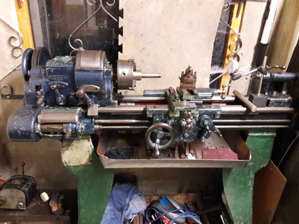

      Hi,
      I was using my Leblond Regal 10" throw lathe and motor went with a bang.
      The motor is really old and i think its time for replacement. Can anyone please recommend what size motor i should be looking at or recommend best place to get one ? Currently its single phase….the ID plate is missing.
      I also wondered if i should change the on off lever to a more modern one….but the old one seems in good condition so will leave that.
      Thanks in advance.
      BR
      Mark

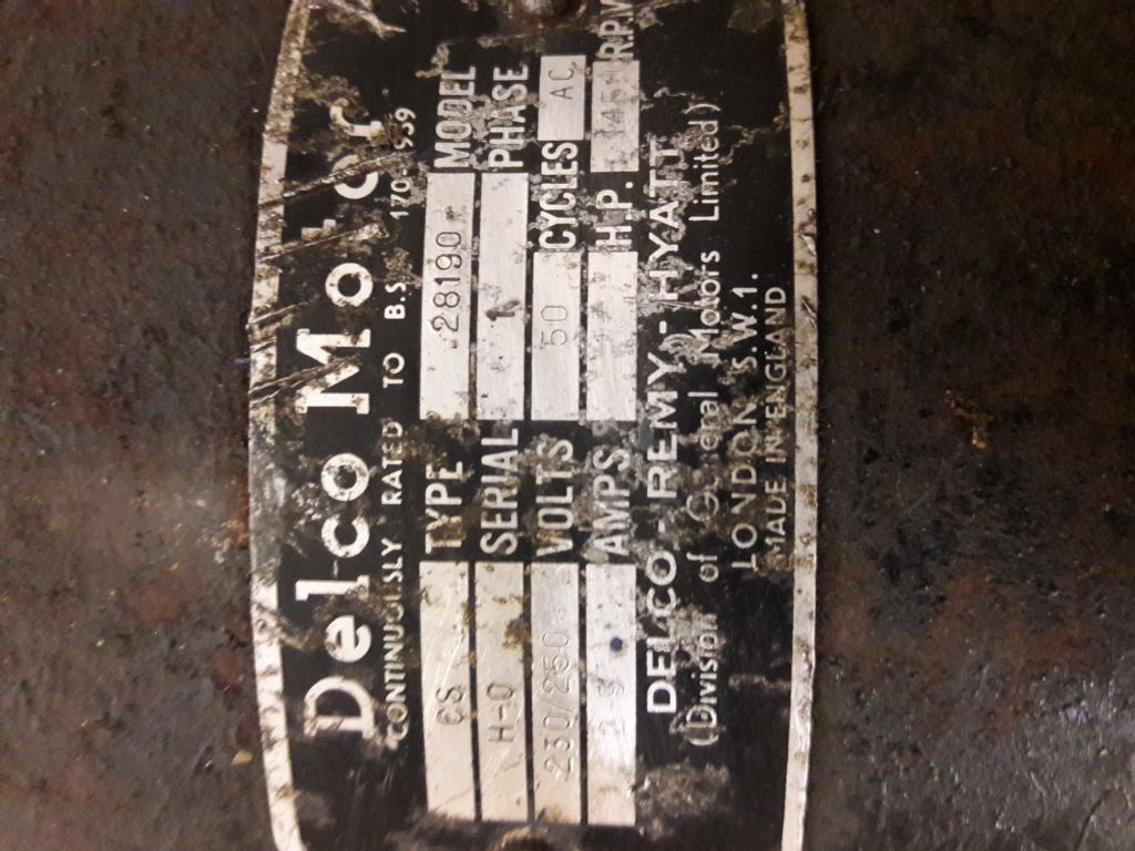

                      Anyway found the name plate…was a bit of a blonde moment !
                      Motor is, 50Hz single phase, 1/3hp, 2.9 amps, 1450 rpm.
                      For some reason i cant attach photos, maybe they have to be approved 1st…i have made an album etc but it doesnt recognise it….will try again later.
                      Anyway the motor is really old, and i think you are correct most likely capacitor has has probably blown. The wiring is a mess throughout the motor and i am probably lucky to be alive !
                      I see what you mean about 3 phase with VFD….more control of rpm etc and probably more economic to run, but i am not so good with electrics and thought i might just buy a new single phase motor and use the old on off switch, which looks in ok condition. I can get a new single phase approx 1/3 hp (might go a bit higher on power) for approx £100.

                        That's a pretty chunky small bench lathe and I'm going to throw my hat in and say 1/3HP isn't enough
                        I would say 1/2HP minimum and 1HP is bestest
                        For me with 10" swing I would be looking at 1.0 to 1.5HP

                            Motor size using Myford as an example ML7 uses 1/2 hp, Myford Super 7 (2000) top speed uses 3/4 hp , both motors 1440 rpm. A lot depends on the top spindle speed the higher the lathe spindle speed the more power required to drive it,Generally the more modern the lathe the higher the speed ,and the larger motor requirement. I would suggest 1 hp. Also bear in mind most single phase motors have a max number of stop/starts per hour rating,
