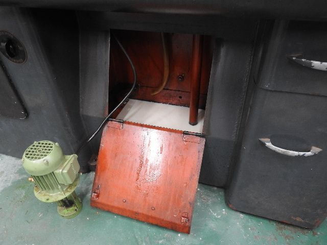

      just bought a Colchester student lathe and filled the coolant tank to find a few hours later my workshop floor flooded. The tank is integral with the base of the lathe. Difficult to see internally where it's leaking. Doesn't look corroded. Any suggestions as to a repair ? Must be some epoxy treatment to resealable it ? Any suggestions appreciated Regards Phil

          Hi Philip As a factory service manager I have come across similar problems but mainly on grinding machines but it is usually caused by not cleaning out coolant and swarf for a long time and corrosion makes perforations usually in difficult to get at corners. I would have to clean out and find the holes and then I used an epoxy resin 2 pack but I would coat the whole tank inside making sure that it went through the holes and it would have to be entirely grease free before coating. I used a pack from RS components but not cheap but I never had one leak after and it gives the tank a antitrust coating.

              Agree with David that the leak(s) are almost certainly in the corners. Had same problem with my Smart & Brown 1024 tank and did a cheapskate version of Davids epoxy coating repair using the common glass fibre resin as used, for example, in car body repair kits. Chosen mostly because I had large tin in stock due to over purchase for another project some years previously. Some strategically placed glass fibre tissue placed in the corners helped ensure that there was a seal on the vertical sides without needing an inordinate depth of resin. The 1024 tank slides out which made for an easier job, especially cleaning out, but it has internal sub divisions with thin gaps at the bottom to act as pre filters catching some of the swarf before it gets to the pump pick up screen. Keeping suitable filter gaps after the resin repair was bit tricky.
              Did the usual tap all over rust investigation and found a couple of larger holes in the middle which needed welded on patches.
              Only going too be temporary job until I got a new tank. Getting on for a decade old now. Now't so permanent as a temporary job. Allegedly the synthetic and semi synthetic coolants are better than old fashioned suds when it comes to tank rusting (and paint stripping).
              If you decide to try fitting a new tank inside its worth looking at the deep drawn rectangular stainless steel "pans" from catering supply folks. No seams and price is not completely un-reasonable given that its likely to be much more durable than "found" or "re-purposed" tanks. For example GastroNorm (whatever that means) pans come in a range of sizes with depths up to maybe a foot, Google comes up with some decent size diagrams. Probably £20 to £30 for a suitable one. I've got one about 21" x 13" about the place, obtained for some now forgotten reason.

                      Many thanks to everyone for all the excellent advice. Have spent some time cleaning out the tank with degreaser and wire brush. It's very odd. The internal condition looks good with no evidence of corrosion ?? But there is certainly a bad leak (fast drip). I like the idea of fitting some form of tank liner but the access hatch to the tank void would mean that the only tank I could get in would reduce the tank volume significantly. Have now ordered some epoxy tank sealant . The type used for sealing leaking motor cycle fuel tanks so will give that a go in the first instance.

                        Well, finally it seems (so far) the coolant leak is cured but was not straight forward. I initially coated the inside with epoxy concentrating on brushing into the corners. Access is awkward. Left is for a few days to cure. Result- leakage was same as before. Frustration !! I then had to go through the cleaning process to get it dried out and clean again. This time I cut some strips of glass matting 2 inches wide and worked these into the corners with epoxy on all 4 sides. Very awkward sticking my head inside to see with a torch trying not to gas myself with the fumes.! Cutting a long story short it now seems to have sealed.
                        I don't think this is a corrosion issue. The tank is integral with the lathe cabinet so the tank bottom is also the base of the lathe. What may have happened is that someone possibly in moving the lathe may have strained the bottom slightly maybe cracking one of the tank seams.
