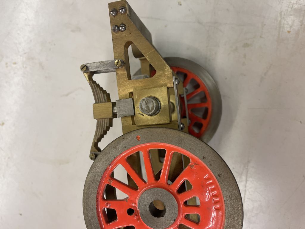

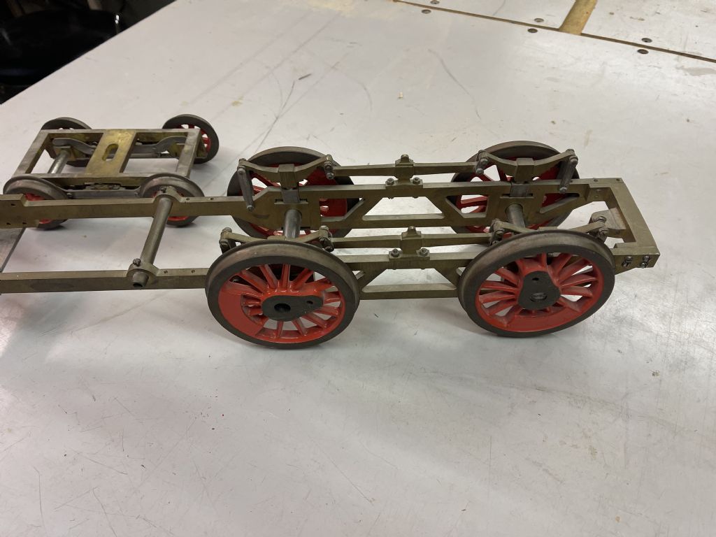

                        Many Thanks for the advice so far, I did not really give much thought to Kozos A3 being a slower build due to lack of castings and as I have all the castings book and drawings for Virginia I have decided to move on with that one, I can still use a lot of methods of work in Kozos book and I hope get help on here, also I am not keen on starting another project until I finish any of the others I have on hand.
                        So to Virginia and the problems so far, the build is in early stage so not too much has been done, the wheels are all ok. The suspension has been done but is not very neat with all of the hangers not being equal or looking the same so I will remake them. These are the problems so far
                        The frames are bronze or brass cast and have been just roughly filed, should I smoth these out or leave as is, the same goes for the cast springs and equalisers.
                        The frame which is now riveted together tapers by 1mm front to back, is this Ok?
                        The axles for the wheels have been made but the idea according to the person who I got this from was that instead of a press fit they were to have a pin inserted in the face of the wheel and end of the axle, should I just make new axles that would be a press fit?
                        The suspension has been fitted to the frame but there does not seem to be any form of springing where the axle blocks ride in the frame, if the frame presses fully down on the axle blocks the inside rims of the driving wheels hit the spring hangers, why is this? you can probably see this from the image I posted.
                        Finally because this loco has a cast frame and has all of the castings would this be a kit rather than individual items bought and if so does anyone know the kit maker, I know some kits need a lot of filing to make work.

                          You have quite quickly made your decision regarding which engine which is a great start.
                          I'd get the drawings and manual (if there is one) to check the suspension issue that you might have and strip the whole thing back down to component parts. Even if that means removing/ drilling out the rivets. Why? If you don't do it now, I reckon you will end up doing it later and you will probably save a lot of time.
                          You might even end up re-skimming the wheels when you get round to measuring the run out, the quartering or the differences in diameter. Better to do it now than find that you can't get the coupling rods to fit properly later.
                          Make the frame casting pristine with a file and emery. It will take you about a day. Well worth it.

                                  You may already be aware of this, but, there is an issue with the boiler as designed for this loco, so, when you come to this item I suggest that you measure and calculate very carefully.
                                  In brief, as drawn the firebox fouls the suspension. Narrowing the firebox and raising the boiler a little 'solves' the conflict. The firebox is also too-long, this results in the blowdown valve only fitting with great difficulty unless re-sited.
                                  You may wish to add a shoulder to the crankpins to save them scuffing the wheels.
                                  Not sure about the cause of the conflict between your (dummy?) springs and the wheels – depending on how advanced the work on springs and axleboxes is and how-much 'reworking' you are prepared to do you may have to resort to some judicious grinding there. The options need careful consideration following a detailed look and measure.

                                          The large scale had a recess cut-out at the bottom of the boiler by the back axel-box which is easy to do in the model when you get to that point. The blower can be moved to the back.
                                          Changing the pan heads for CSK should solve the clash you spoke of with the wheels. On the large scale these hangers went through the frames not round them, which gave more clearance. The front driver with the eccentric’s should have just enough play for suspension movement. The back can have a little more. Provided the front bogie can swivel and move laterally the loco will stay on even the tightest bends.
                                          You need to decide early on how you're going to fit the reversing lever (Johnson bar). Some connect to the boiler and others to the frames. With our little boilers connecting to the boiler is probably second choice.
                                          If you keen to spend a little more time on the build it is worth it (in my humble opinion) to make the suspension prototypical which is fully compensated. You would need to modify or remake the equalizer bar and replace the springs, but the loco will glide over even the roughest track.

                                                  No, the axlebox should rest on the keeper plate unloaded. Normally the running position is on the center line of the cylinders.
                                                  With the axels its up to you. You'll ask 5 different people and you'll get as many answers. Personally for my 3.5g I used retaining compound. For my 5g locos I use press fits and if I undershoot I just use a little retaining compound on that wheel. My 71/4g is keyed and press fit.
                                                  You going to find many mistakes on any build, but the fact that these locos were built is a good indication that any problem can be solved! looking forward to more pics!
