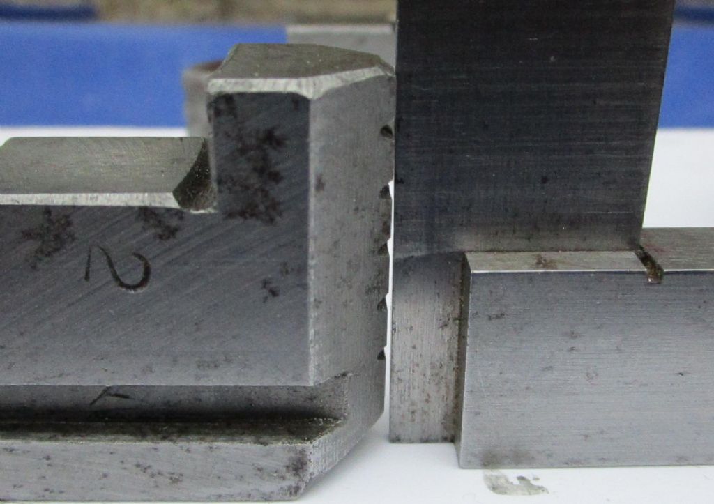

        Quick check. Whip the jaws out and check them with an engineers try square held up to the light to make sure the gripping surface is square to the base surface. And mike the distance fron the base to the slot that engages in chuck body to make sure slot runs parallel to base surface.
        I have heard of jaws that were ground out of square before. Vaguely remember someone setting them up on a surface grinder to correct

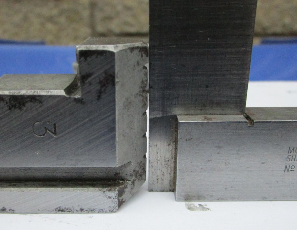

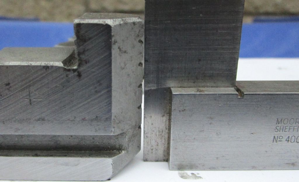

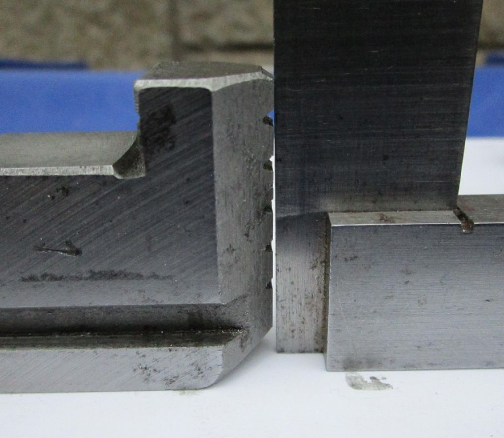

            Hello Hopper, Guys,
            That is exactly what I have done ! The amount of muck and chippings that came out from behind the jaws surprised me.
            Thinking about it this is what I should have done in the first place. I've discovered that what I thought should be a matched set of jaws, isn't even though they are all stamped with the same number. Unlike the three jaw chuck where the three jaws have the same ID as the chuck.
            Anyway I believe I confirmed the results of the measurements from the dial gauge.
            This is jaw number one set against a M&W engineers square.
            Jaw number 2.
            Jaw number 3.
            Jaw number 4.

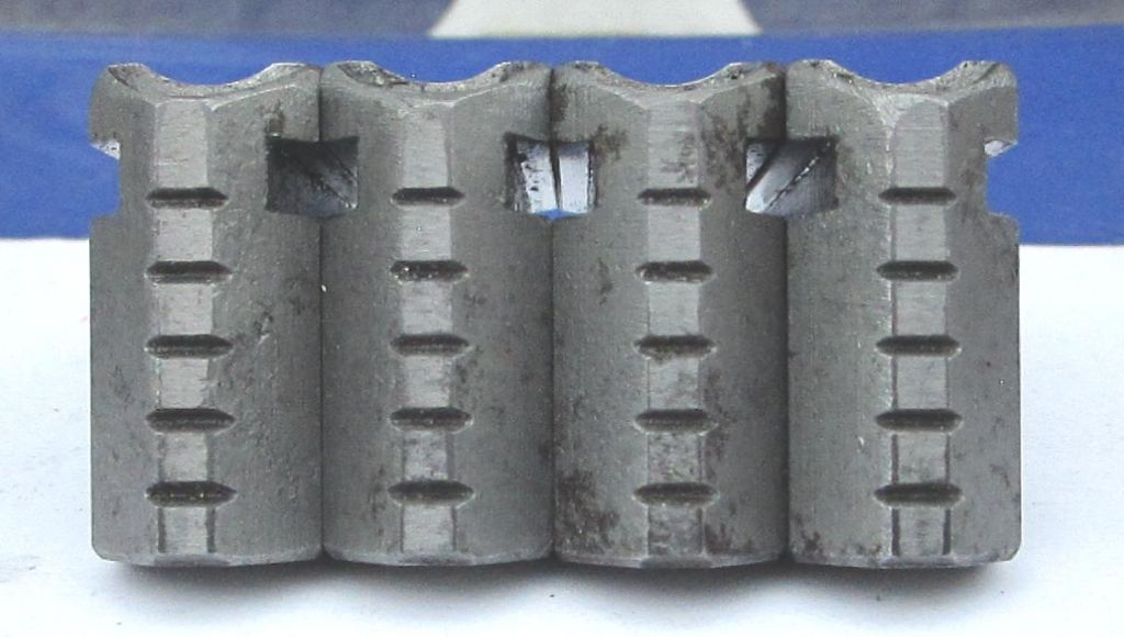

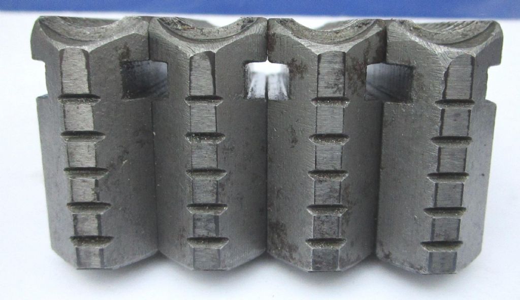

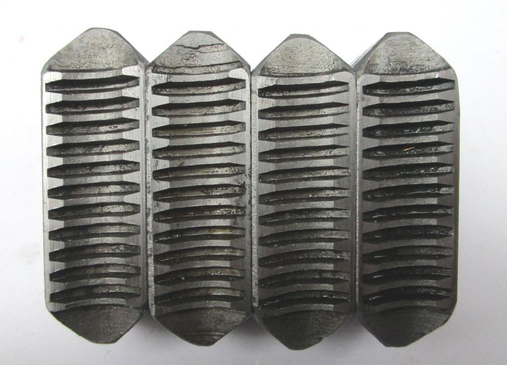

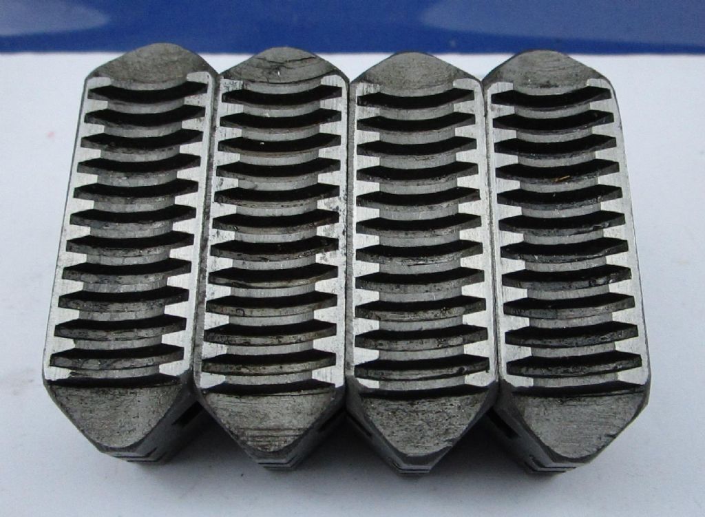

            Some more pictures.
            You can see that these are not even or parallel.
            If you look closely the third jaw is a fraction smaller and the ground edges are not symmetrical.
            A slightly different angle to get a better view.
            I think these are horrible ! Nothing like I expected. When I put them back in the chuck, I'm going to turn them round and check the other faces. My opinion is that these jaws are effectively worn out. They should all be the same hight and square.
            Thanks again.

                                    The pictures of the chuck jaws and the square are totally meaningless. The rear of the jaws has probably been linished to remove burrs at the edge of the teeth. The squareness that matters is between the slots and the jaws and only then if they are in the chuck body and are stressed in the clamping direction.
                                    There was mention of soft jaws being bored to fit the test bar. Did that confirm an error in the lathe bed?

                                          Looking at the pictures of the jaws from the lightweight four jaw chuck, and having recently sold a set of new ones, I recon yours are in pristine condition, there are almost no signs of wear. The threads are ACME form, there is a variation with square threads. I have a set of worn jaws, they look very different both in the thread wear and the contact edges.
                                          There is a method of grinding these independent chuck jaws, one at a time, in the chuck. That would ensure they are accurate when used.

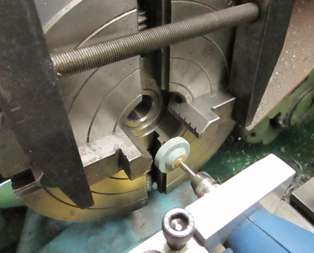

                                                  #476492
                                                  John Baron
                                                    @johnbaron31275
                                                    Hi Guys,
                                                    To close this thread.

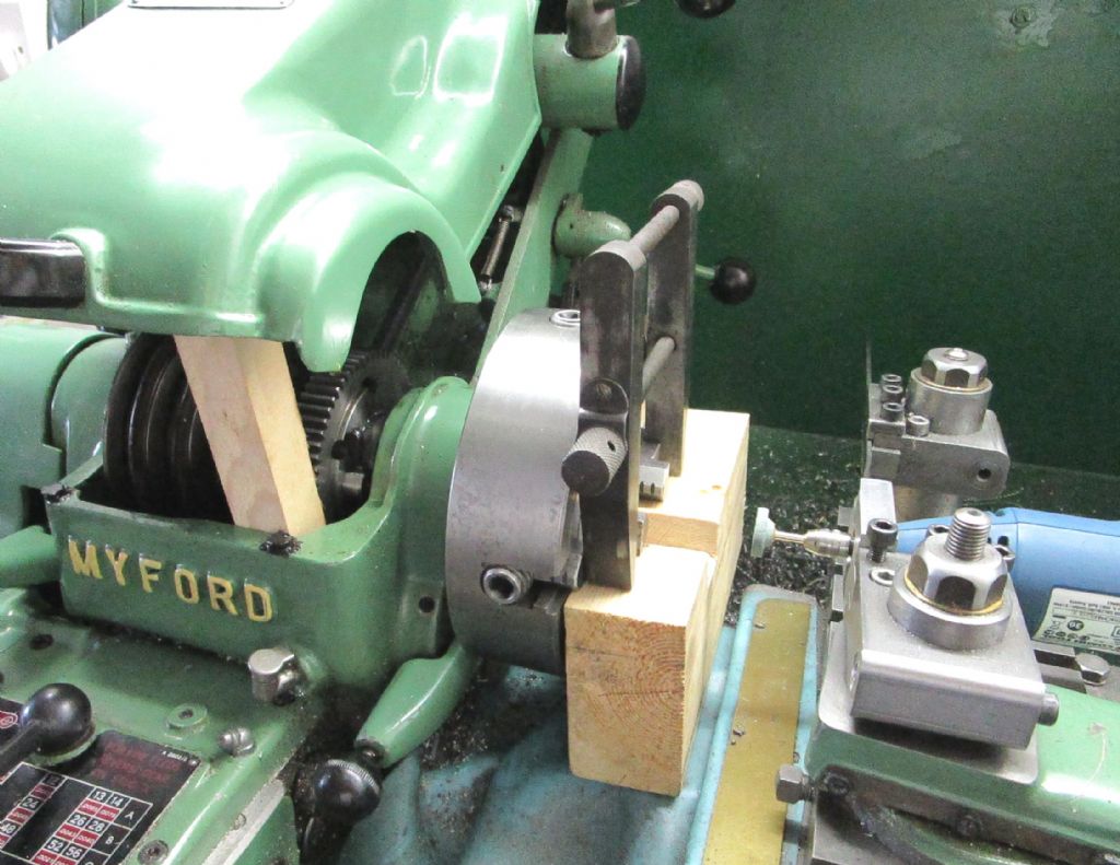

                                                    In my case all four of the jaws all had different amounts of taper to the back. I've simply reground mine parallel.
                                                    However I've also recently discovered that PB deliberately grind the jaws with a 2 to 3 thou backwards taper. Apparently to allow for grinding tolerances in the guides.
                                                    Anyway having reground them I can now set the test bar true at the chuck and it is still true within two tenths of a mm 150 mm away. So I'm very happy with that.
                                                    If I need to grind the compensation for guide wear back in all I have to do is reverse the jaw, clamp it against the inside so that it can't move and regrind the jaw face with the chuck locked so that the jaws are parallel to the bed and lock the chuck so it cannot move.
                                                    The general setup.
                                                    Ready to start grinding.
