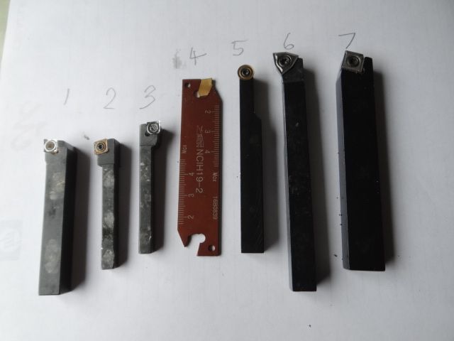

                          Picture of insert holders:
                          On a WM280, which is notch bigger than a Myford:
                          1. RH 10mm fitted with sharp non-ferrous insert, but also used on mild-steel. Used for fine-work in tight spaces.
                          2. Glanze 6mm Facing tool. Much used on mini-lathe, generally too small for WM280
                          3. Glanze 6mm LH. Occasionally used on mini-lathe and WM280 – for fine work,
                          4. Parting Tool, too big for mini-lathe, brilliant on WM280 with rear tool-post/
                          5. Button Tool, rarely used but irreplaceable when needed.
                          6. Triangular boring bar. Much too big for mini-lathe. Not much used on WM280 because I rarely bore large diameter holes.
                          7. Square insert tool for high-speed metal removal. Produces an unpleasant spray of smoking chips. Requires more power, RPM and rigidity than a 1.5kW WM280 is good for. A tri-cornered cutter or chamfering tool from the same set do the same job in a more civilised way.

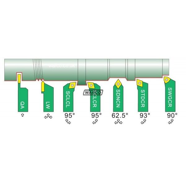

                          This image pinched from Warco shows what a range of common inserts do:

                            This set from Warco(Green illustration) looks basicly the same as the 10mm set I bought, and their tips all lined up to the same height perfectly, from where I made a small toolpost specificly for them to get more reach, and it works like a dream on small stuff.(Made some aliminium needlefelting tools for wife housing different number of needles).
