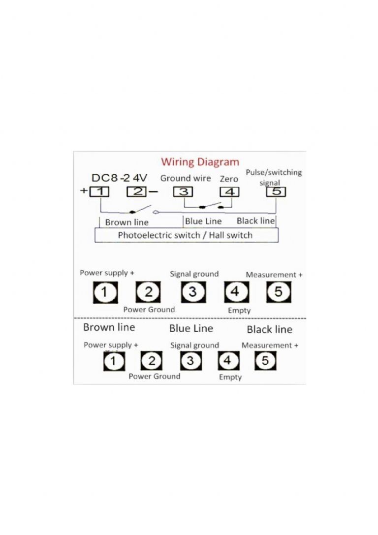

      Hi Graeme,
      I have just purchased a similar tachometer. However, connections on the 5 pin socket on the display are in Chinese. Did you get any information in English? How did you wire it?
      Mike
      #215669
      John C
        @johnc47954
        Mike – this should help – I have wired up mine using this diagram.
        Rgds,
        #215670
        John C
          @johnc47954
          Which translates to:
          Wire 1 : +ve supply and brown wire from sensor.
          Wire 2 -ve supply
          Wire 3 Blue wire from sensor
          Wire 4 Nothing
          Wire 5 Black line from sensor.
          I used an 18 v printer power supply for mine.
          Rgds,
          #215673
          Michael Cox 1
            @michaelcox1
            Thanks John. That is just what I needed.
            Mike
