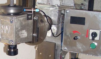

            Hi Richard,
            I have done similar to this on a Boxford. It's a simple job that involves fixing a small magnet to the spindle and arranging the sensor close to it. The rest is just simple wiring.
            You should be able to see from this image how I arranged mine.
            I would consider using a mains feed or you will be forever changing batteries. I 'think' it was an old phone charger I used for mine.

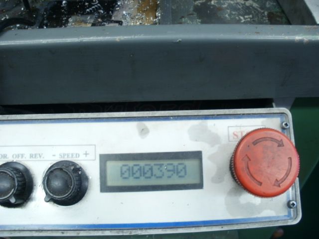

                      Posted by Muzzer on 11/02/2015 11:33:47:
                      Nick – what have you got at the other end of the sensor connection? Wondering where you got the actual display unit from.
                      Murray
                      It's this **LINK** one.
                      You need to get a box to house it in.
                      Nick

                              I used a cheap tachometer purchased on Ebay for my home built milling machine. It uses a proximity switch as a sensor and does not need a magnet. I reads off a hole 10mm D x 6mm deep on the edge of a pulley. It works well.

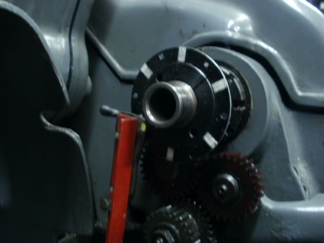

                                            p2111364.jpgI fitted one of these to my ML7RB and it works just great:-**LINK**p2111361.jpg

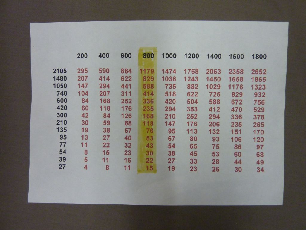

                                                      p1020857.jpgWhen I converted my S7 to VFD I developed the attached speed table , which I find suits my needs fine . The 800rpm column is highlighted because this is the minimum motor speed recommended by Newton Tesla for continuous operation.
                                                      Trevor
