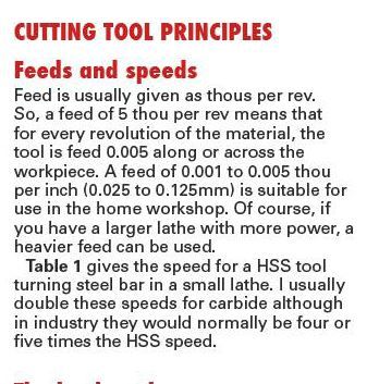

      I’ve been looking for but struggling to find a quick rule of thumb for lathe spindle speed. Something like work diameter divide by 1000?
      Also how do I change parameters for finishing cuts? Higher spindle speed plus less feed rate? What is the practical limit for this?

            That's useful though may be good to know if that's for HSS or carbide tools and there are no feeds.
            I found this very useful diagram from cnccookboook
            So the surface finish would seem to be limited by a feed so slow that the tool rubs not cuts and spindle speed limited by tool temp
            What's interesting is I've turned parts with much higher spindle speed than the the table from the 1st link with no problems – if that is a table for HSS tools should it be multiplied by 4 for carbide (even cheap carbide) tools? Is there a limit surface speed for aluminium because it melts?
            I've took feed rates below
            Which gives 0.5 to 0.05mm/rev in metric
            #386635
              This went with the table
              THE CNC table is more likely for milling than turning. And your feed chart is a bit high for most hobby use, try about 1/5th of that.
