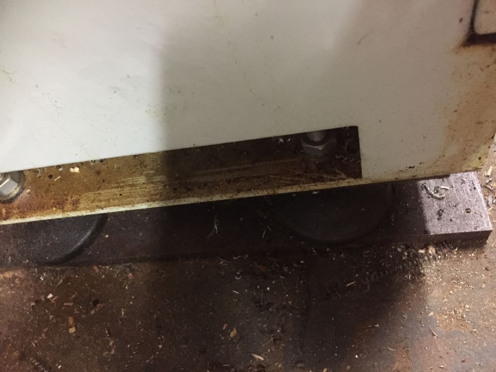

                              Well of course I tried it my way first, dismal failure.
                              Then I fixed the Engineers' level, removed the bodge piece of folded Chinesium, redrilled the scale pivot to square, put it back together again.
                              Then I levelled the bed. The tiniest tweak on any foot changes everything, took hours dont know
                              The largest bar I had was about 1.5" diameter. The chatter was decorative at the end but I got 6" of smooth.
                              Left hand end 1.5712"
                              Right hand end 1.5709"
                              Error 0.0003"
                              Bliss yes

                                                I measured again, about a zillion times, and I think I got it wrong. Blooming Vernier scales. I think I am 0,0016" out on the diameter.
                                                Best not tell the grown-ups because they get cross.
                                                The bar is still in the chuck and a DTI in the tool post says it is 100% parallel so nothing has moved.
                                                If I drop the front right jack to get 0.0008" error on the DTI would that be cheating?
