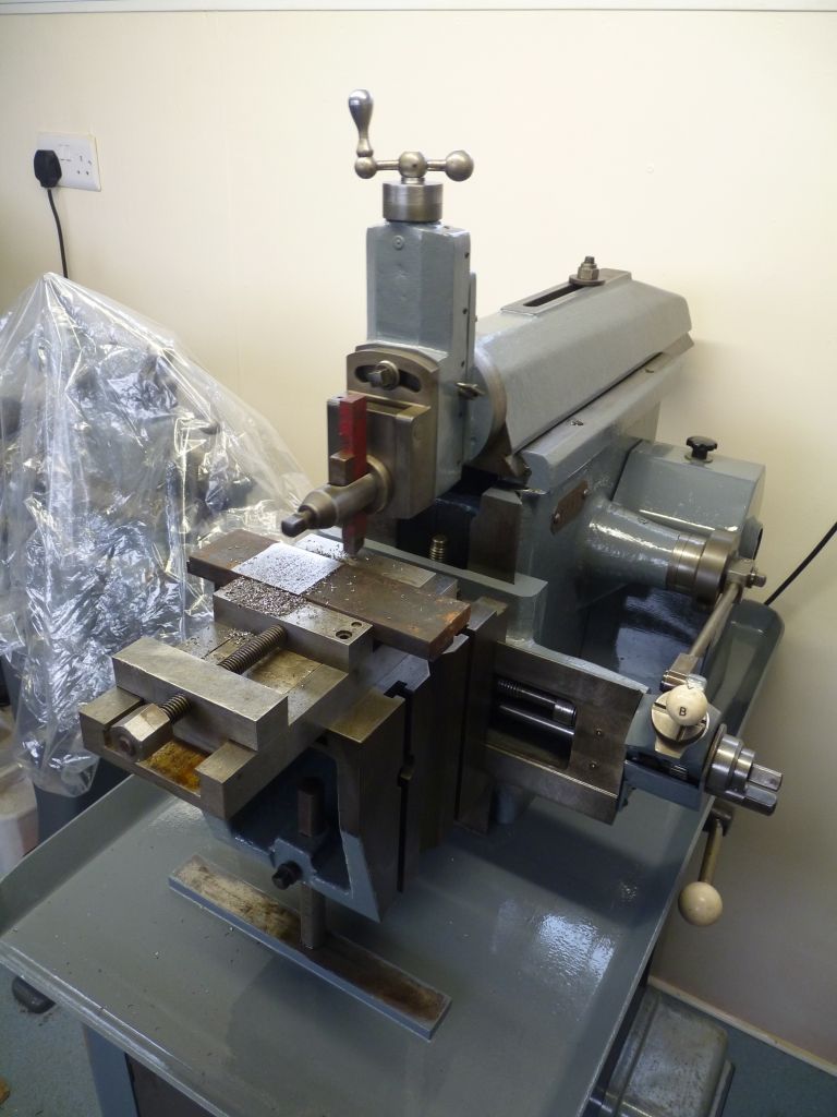

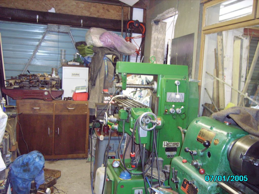

                I use Tractol machinery enamel, available at all agricultural engineers and country stores, here is my Harrison mill in a delightfull shade of John Deere green, which is the colour it was when i go it, much cheaper than the special lathe paint (lols) being flogged to purists by some internet "enterprenuers". brushes or sprays really well, but needs to be sprayed in a warm atmosphere or it may run. There is also a huge range of colours in commercial transport paint which is a polyurethane synthetic enamel which is virtuall oil proof when fully cured, and is very hard wearing. find a local spray shop suppliers (paint wholesalers), and pop in for a chat!
                Phil

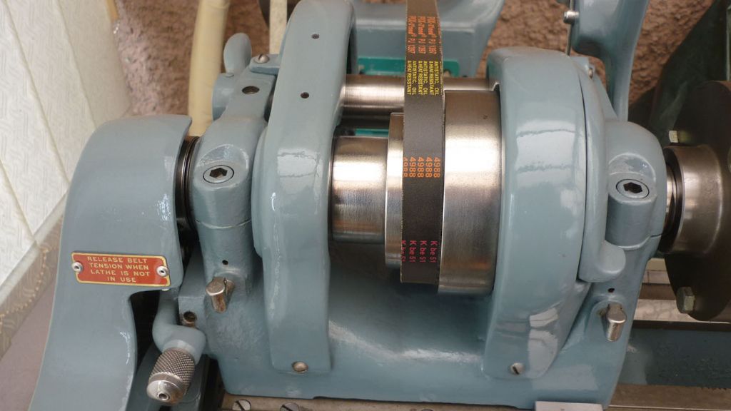

                                    p1260311.jpgI used the Paragon synthetic enamel in Boxford smoke grey from Stationery engine to do my South Bend..
                                    Its quite nice if you can get it to brush out easily.. I found its highly dependent on the humidity and temp.etc.. when applying it. I was going to spray but my gun was broke. If the conditions are good it flattens well without brush marks.
                                    I expected it to be a bit more forgiving though as its meant for brushing. The colour was a lot bluer than it looked on their website.
                                    Rustoleum combicolour is easier to apply and is popular on American forums.

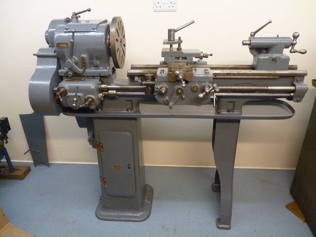

                                      Hi everyone.
                                      After some thought and reading all your comments I decided to paint my lathe with tractol white primer and then a top coat of some satin white called containerguard.
                                      It all went quite well untill I decided that the satin white was crap so I sanded it off slightly and put two coats of slightly thinned tractol gloss white/grey on top of that.
                                      I'm quite pleased with the result, it seems very durable, impervious to oil and suds and wipes clean.
                                      Hopefully I have done the photo link properly so you can see my efforts.
