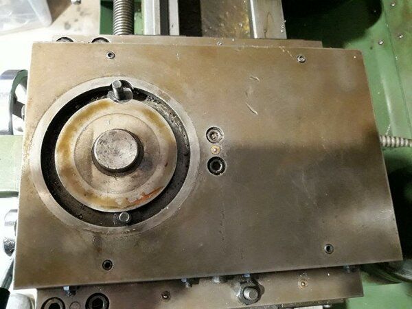

      I couldnt get any part to match with.
      So that would mean there has to be some sort of top plate between the two. Would I need to drill some holes in the myford one to match the holes revealed in the cross slide that has the screws in them.

        Yes. I would hazard a guess that you pull out those four allen-key grubscrews shown in your pic in the cross slide and use those four threaded holes to hold down a T-slot plate. Yes you would have to drill four matching holes through a Myford or generic T slot plate for bolts to pass through.
        Or you could probably use a piece of 13mm flat plate etc drilled for those four holes. Then take the two spigots off the bottom of the vice that look like they stick down into T slots. Then just drill and tap holes in the flat plate wherever you want to mount the vice.

                        Well good news the previous owner has found the table and according to him you take the toolpost off the saddle and the table bolts down there.

                                Looking at my lathe diagram I see the saddle is right on the lathe bed and the tool post is on the top slide which is on the cross slide which is on the saddle. Wouldn't that lose one axis of movement and leave only left and right movement or would it be more likely to come off the cross slide like we talked about earlier and fit in the grubber screw holes?
                                #407810
                                Hopper
                                  @hopper
                                  Not sure I totally understand your question, but usually the top slide is removed for milling and the job is clamped to the cross slide, or in this case to the slotted plate bolted to the cross slide. Left to right movement (X) is usually then done by turning the leadscrew by a handwheel, which moves the carriage along the bed. In/out movement (Y) is provided by the cross slide. Vertical movement (Z) in your case will be the raising and lowering of the vertical milling attachment's head or spindle.

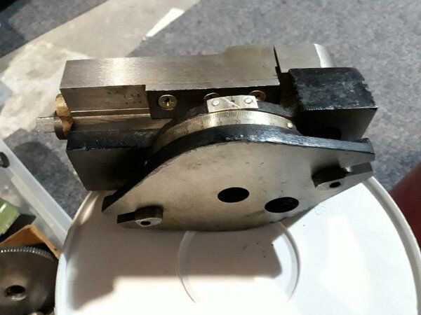

                                    OK I was trying to understand if there was another moving part missing as if I remove everything to the saddle there would need to be another Y moving handwheel and wondered if the guy had meant cross slide not saddle as the base for the milling table. As I had taken a picture of the cross slide earlier, it was also working out what other parts were needed to successfully use the table.

                                      It would be normal to expect the Cross Slide to carry a Topslide, which can be swivelled when there is a need to turn a short taper, such as a chamfer. The Cross Slide will be graduated so that the Top Slide can be set at the angle that you require. This will probably go from the central Zero (where the Top Slide movement is parallel to the lathe axis ) to about 45 degrees each side of this Zero position.
