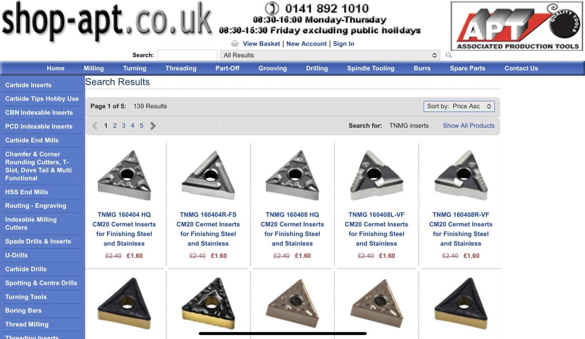

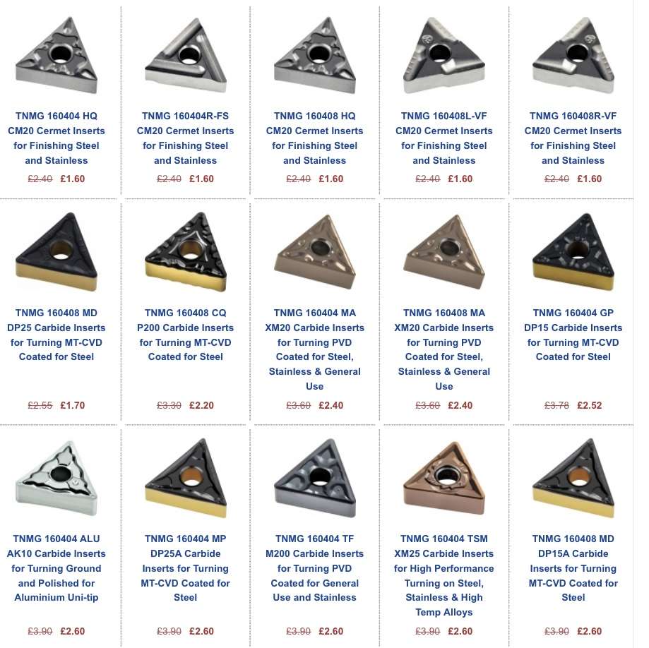

                  I too am a fan of the four way tool post on my little 8.5” x 14” lathe. As mentioned the tool holder for TNMG inserts is 14mm deep so quite rigid.

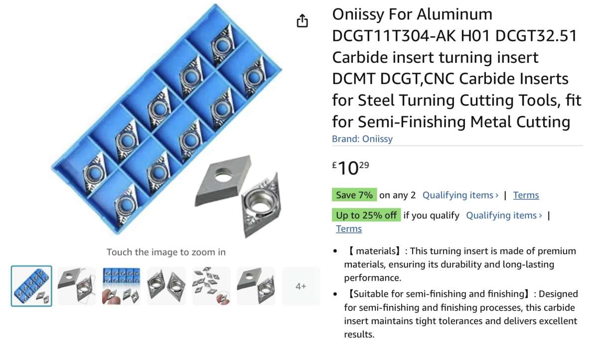

                  My journey with carbide inserts started with the little DCGT0702 inserts. I bought a double sided tool and a box of inserts from Jenny of JB Tools at one of the shows many years ago. I didn’t find them very durable, the tip radiuses available were often limited and being only 2mm thick easily damaged. The shape can be useful for some jobs though so I sometimes use the larger DCGT11 inserts.
                  The cost of inserts obviously varies by supplier. Yesterday I received some from Amazon. I’ve had several boxes of DCGT and TNMG inserts from them and I’ve not been disappointed so far.
                  IMG_4892
                  You can get bargains though from mainstream tool dealers like this supplier. As you can see, the cost of TNMG inserts is pretty similar in this case but you’re getting three times the number of cutting tips than the little DCGT07 inserts.

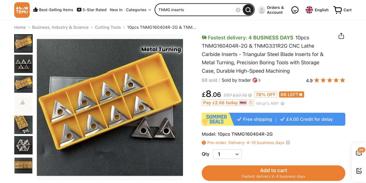

                    Anyone used inserts from Temu?

                        Two of the pictures posted were from APT, you may have recognised them from the website?
                        I cropped them to make the prices easier to read. Here’s another picture.

                        old mart
                          @oldmart
                          WNMG 06 or 08 size can be obtained in aluminium grades as well as for steel, they have 6 edges per insert, as do the TNMG 16. That is if you don’t crash and destroy one whole corner. APT is a very good supplier for hobby use and if you want to try smaller quantities rather than buying a whole box of ten, then they also have a limited number of inserts available at a higher unit price especially for home users.
                          Those Temu inserts pictured in Vic’s post are exclusively for use with right hand tools.
                            Are you sure, I thought the right turning one’s looked like this?
                            IMG_4914
                            Either way, Temu sell both types for similar prices Old Mart. 😉

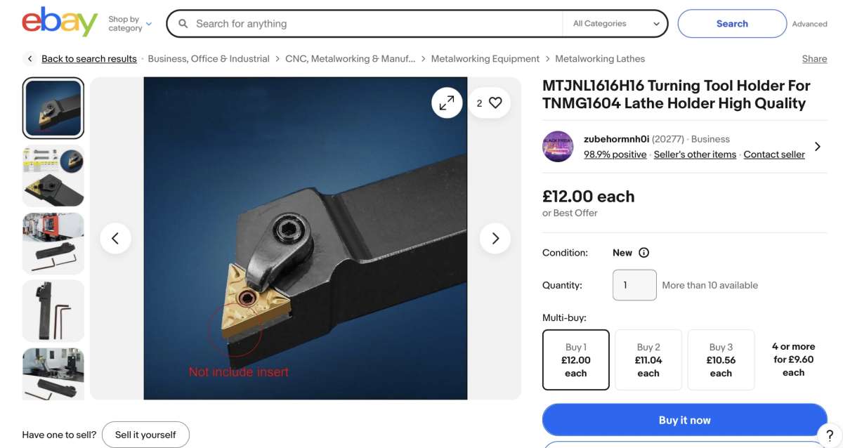

                            When I get low on stock, I sometimes look on eBay for bargains. I didn’t pay more than £1 an insert for these ones including postage.

                              It looks like the cost of the Tool holders is about the same price as I paid a few years ago.
                              The steel is quite hard (or it was on mine) so if you do need to trim it down to fit your toolpost you’ll need a carbide mill.

                                Old Mart is correct about the handing of the inserts.
                                That ebay image you have just posted is a right-hand tool not left. The heading has an L in it for L/H but image and insert is R/H
                                The other images down the side with the Allen keys in them do show a L/H tool and that has the L engraved on the side
                                That is the problem buying from cheap suppliers who can’t even describe or illustrate a listing correctly you may not get what you are hoping for and then it is hard to return. Or if you don’t know your right from your left they generally are not that helpful at answering questions.

                                  I bought a cheap box of the right handed TNMG16 inserts for steel and found they are primarily for much more powerful lathe than we have at the museum. I sharpened the edge with a diamond lap and improved the cutting.
                                  Remember a righthand lathe tool bends to the left to face off the righthand end of the work. Righthand tooling is more often used than lefthand. Lefthand tools can be mounted in line with the spindle axis facing towards the chuck when a difficult small diameter or tight clearance makes a righthand tool problematic.
                                      Those are Left Hand as Old Mart Said not right as you think they are.
