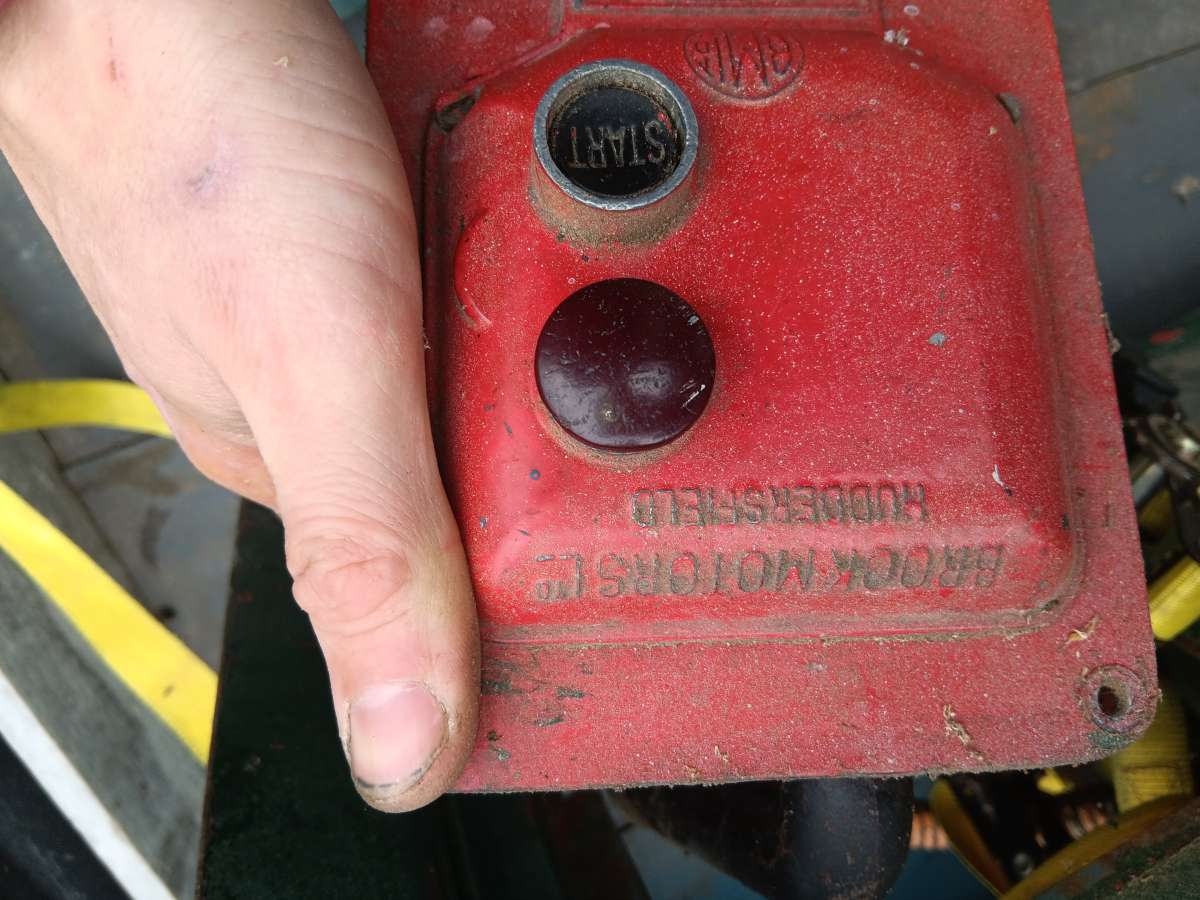

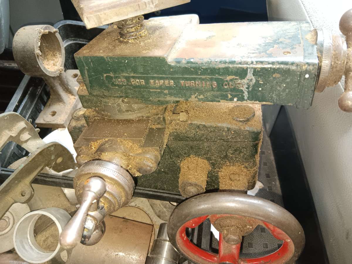

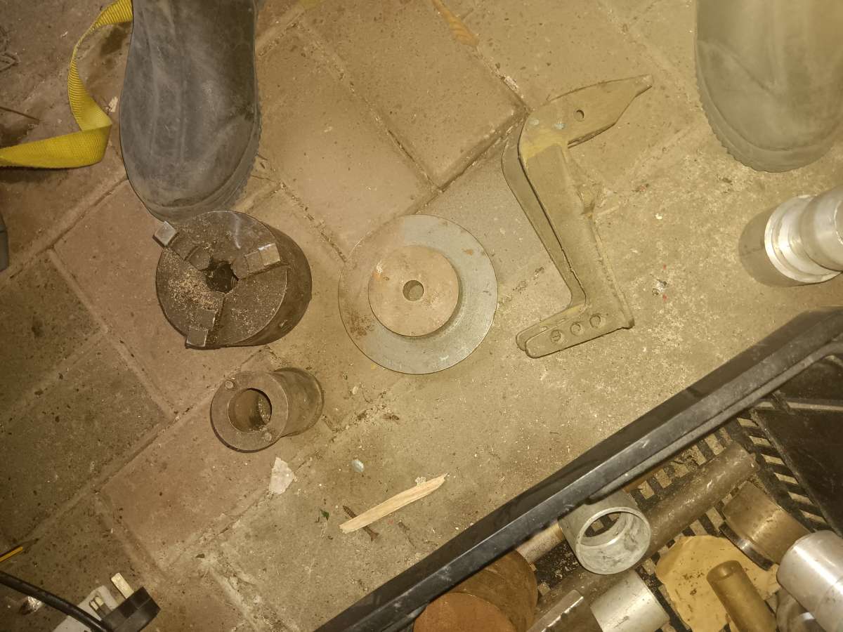

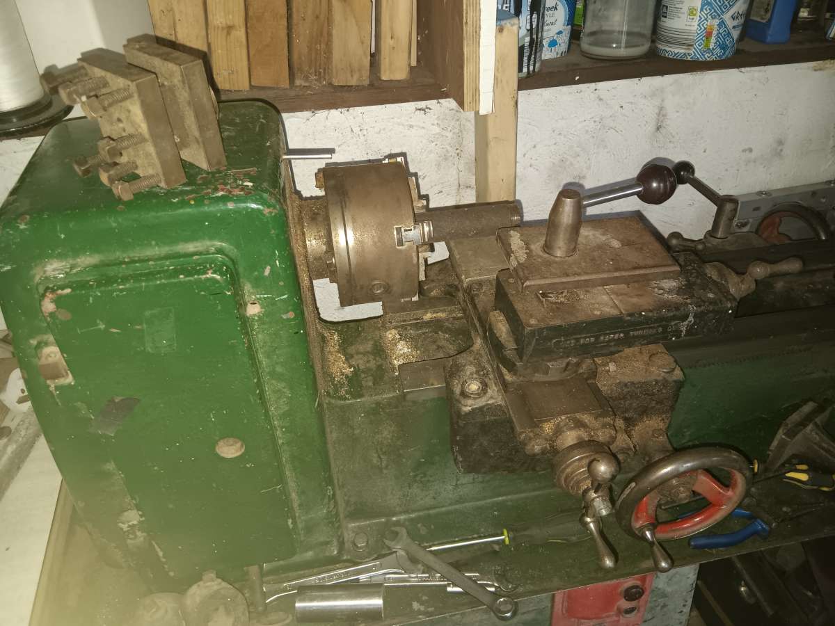

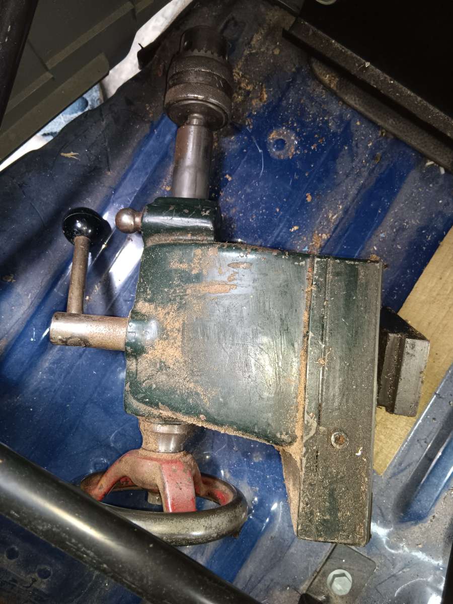

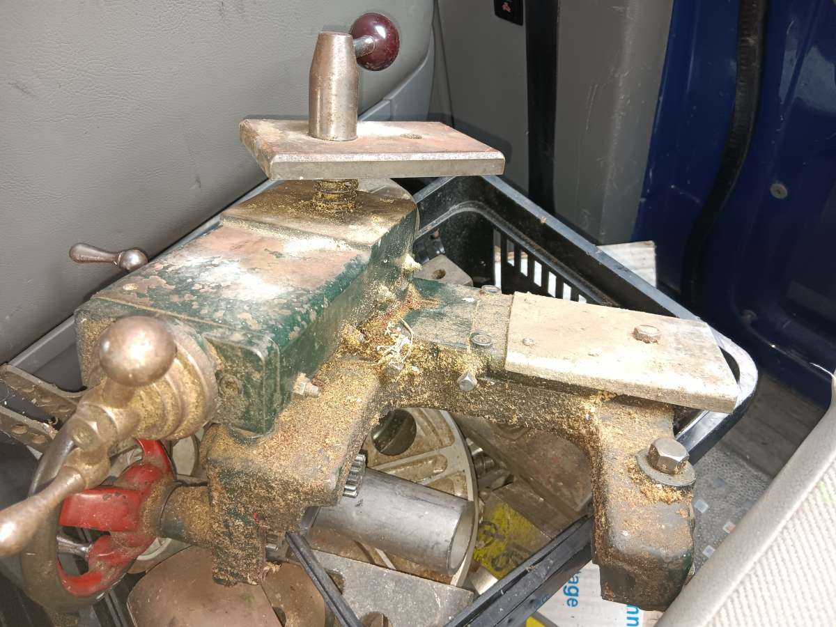

      My grandfather gave me his old lathe today. Ive been trying to find some information on it on line but haven’t found anything. I suspect its an old training lathe, its quite basic but my grandfather says hes used it for both wood and metal and made various bits without trouble.
      There’s no ID plate or branding apart from that for the motor and control plate.
      any ideas on what the make/model might be?
      thanks20260411_16392220260411_16393220260411_16385720260411_16383820260411_14403520260411_14402420260411_14391620260411_14353320260411_14352220260411_135720

      Dave Halford
        @davehalford22513
        Raglan Loughborough

            My first lathe was a Loughborough, it’s a simple thing, but built like a brick sh*t house. Decent size spindle bore as well. It was a good lathe.

                          So I got the machine setup in my workshop today. It works but I have to manually start the motor by hand to get it spinning, I assume this is an issue with the motor bushes possibly?
                          As I’m completely new to lathes I’m not sure i have everything in order to use it. It seems the mounted tool holder is for taper turning only (as it says so on it) but I cant see how to mount a cutter to it. Also, I have a tool post but cannot see how this mounts also. Am I missing some essential bits? I’ve attached some photos of what I have but a reference to a part would be helpful in sourcing anything thats missing.20260413_18282620260413_18292920260413_18281720260413_182745

                            Having to help the motor along by hand to start it usually means a bad capacitor or sometimes the bearings. Changing the brushes wouldn’t harm.

                              Sounds reasonable although I didnt notice a capacitor at all. Either way thats a problem for another day.

                                It’s the top slide that has the note on about taper turning. You can ignore that note. I guess the dymo tape is left over from the school use where presumably they didn’t want anyone to use the top slide travel unless turning a taper, when the top slide would be rotated to give the correct angle.
                                You have a 4-way toolpost (sat on top of the headstock in your photos). See if you have the necessary bits to fit that in place of the flat plate with a spring underneath and a lever with red knob on top. Your turning tools would clamp into one of the slots in the toolpost, and would possibly require shims underneath to get the tool tip at centre height.

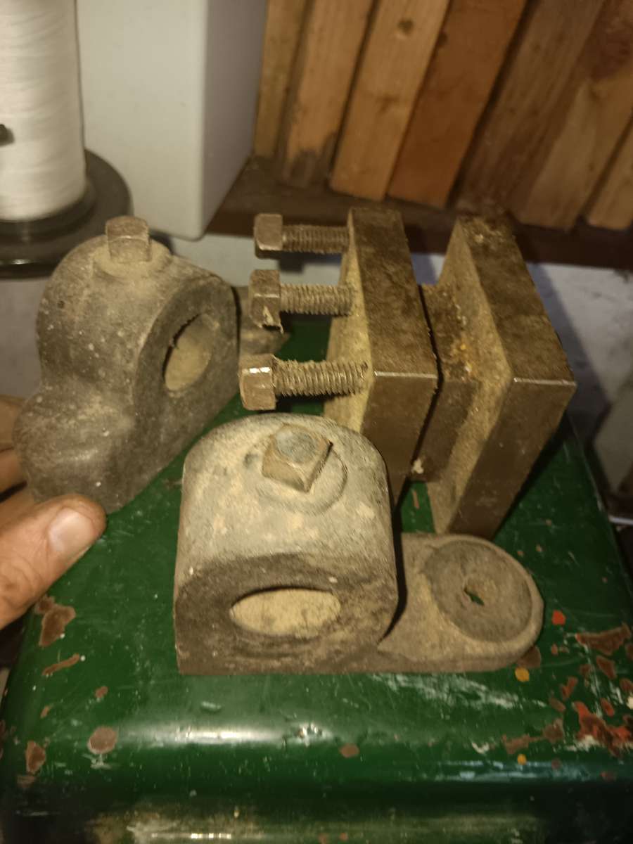

                                  Thanks Dave, yes I thought that might be the case with the taper note. Unfortunately, if I remove the top plate from it, I’m left with a stud that has a diameter too large to fit the tool post mounting hole. I’ll probably have to see if my grandfather can dig around in his workshop and find any bits I missed. But unfortunately I am 4.5hrs away and his health isn’t great so its may be easier to set up an alternative.

                                    Have a look at the lathes.co.uk website (see Dave Halford’s link above). You’ll get a better idea of what the normal tool post looks like on there. I guess yours must be an early one because there is no tee-slot on the top slide. Did you ever find the serial number?
                                    If you want one of the tool posts that appear to have been standard, and only hold 1 tool, let me know as I have some spare that I don’t use.

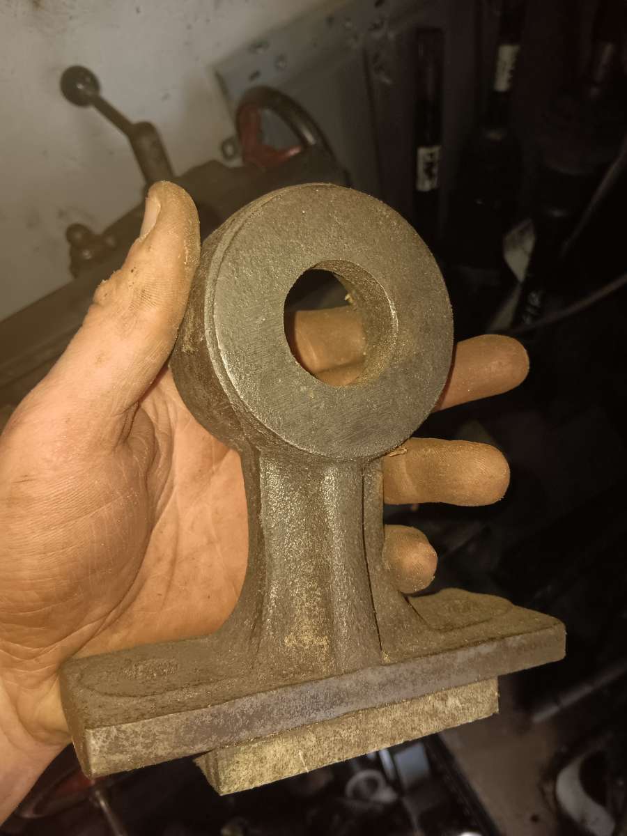

                                      One of these might do

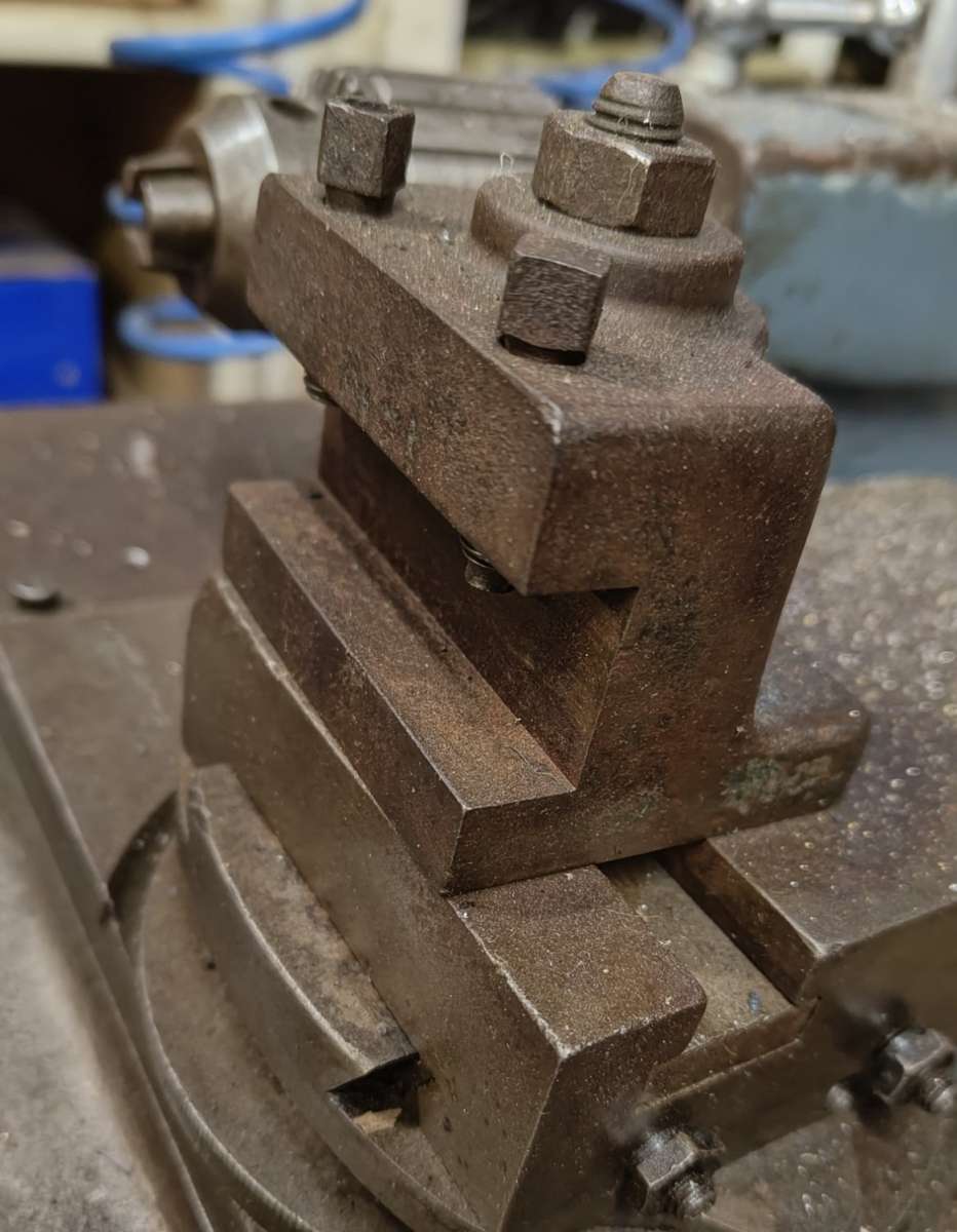

                                        This is what I believe to be the standard tool post (here fitted to a Raglan 5″ in a rather tatty state!)
                                        Toolpost
                                        It has a 10mm hole through it – presumably the standard stud is 3/8″. If your stud is bigger this could be drilled out to suit. The height is about 60mm so your stud needs to be that plus enough extra for the nut.

                                          Ok, seems the easiest option is to stick the tool post in the four jaw check and it out to take clamp setup i have.. or is there a reason not to do this?

                                            If no capacitor the motor has a starter winding that tells it which way to rotate then a centrifugal switch disconnects it once spinning. This switch can be dirty, burned contacts, out of adjustment due to wear, or worst case the winding is burned out.
                                            The 4way toolpost may have been a random purchase or thrown into the deal with other bits and never actually fitted.

                                              All good advice Bazyle, thanks. On closer inspection the 4way toolpost is  probably best left unmachined as its got a small circular mounting turret underneath that puts the tool centre too high i think. I’ll have to take a closer look at the whole setup later on when I have some daylight in the workshop.

                                                The proper tool post is sometimes call a Gibraltar tool post

                                                  It would be interesting to know what a Gibraltar tool post actually is – I thought it was one that replaced the top slide. I’ve never seen one of those as an original fitment to a Raglan.
                                                  I have a solid block to replace the top slide on my Raglan, but it still takes a quick change tool post on top, rather than directly clamping a tool.

                                                    Thr Gibraltar toolpost was a massive toolpost invented by G H Thomas for use on his Myfoird 7. It was big and so rigid and held just one tool.
                                                    To turn short tapers (Such as when trimming up a centre ) the Topslide is offset. For most rurning /facing work it is set parallel to the axis .  But Taper centres for the tailstock are usually hard, whilst those for use in the Headstock are soft, and need a trim up, occasionally.)

                                                    It seems a feature of Raglan lathes for the 4 way toolpost not be moiunted on the Top Slide, which can be a bit of a PITA.
                                                    (I made a rather skinny 4 way toolpost to fit on the Top Slide, for a friend who had a 5″ Raglan.)
                                                    Your lathe needs a realy good clean after being used for wood turning. Then reassemble it and carefully align it. The time spent eliminating twist from the bed and setting the tailstock in line with the headstock will be well spent. (A twisted bed will not produce parallem work.
                                                      Howard,
                                                      I’m afraid you’ve confused 2 of the ME greats.  Actually it was Tubal Cain (Tom Walshaw).  Anthologised in his  “Simple Workshop Devices”.  I have made the Hemingway version in cast iron.  Very good for holding large boring bars.
