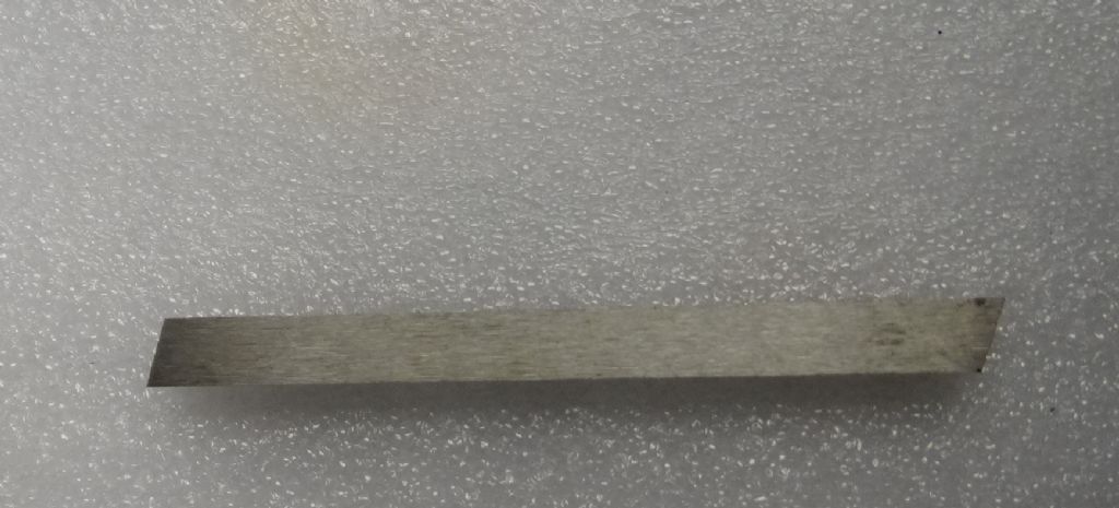

            #319218
              I've wondered about this too. Here's an example of a new HSS tool blank:
              On this one, the left hand angle is about 70° and the right about 73°. Whatever the purpose of the angle, accuracy seems not to matter.
              #319220
              Thor 🇳🇴
                @thor
                Dave, the toolbit in your photo looks pretty much the same as the ones I have.

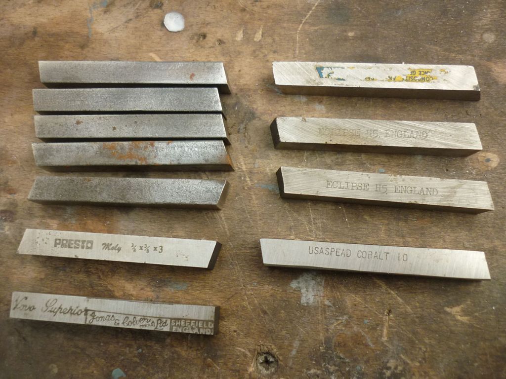

                #319223
                mark smith 20
                  @marksmith20
                  Ive always wondering the same the angles vary ,heres some i have the ones on the left are cut at a 60-70 degree angle ,the one at the bottom straight across and the ones on the right are cut at an angle but in two directions.
