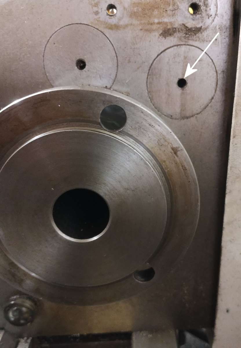

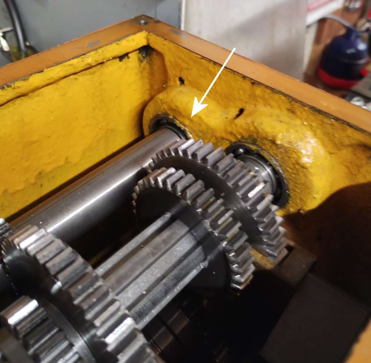

      I need access to a bearing in the headstock of my old BV-20 lathe. The ends of all he gear trains are covered by a ‘plug’ which I need to remove. Each has a small (5mm) tapped hole in the centre.
      I assumed this thread woud allow me to either a) fit a screw and use it to ‘jack’ the plug off or (b fit a lashed-up extractor to pull it off. Neither method has been successful. The threadsize is so small I don’t dare put to much force on it as it’s so light it may just shear off (have tried until I literally couldn’t turn the allen key any more.)
      So, anybody seen / done this before? It seems overkill to start drilling holes / applying excessive force at this stage. Any suggestions appreciated

            You may find the bearings need to be tapped out with a drift as well unless there are C clips.

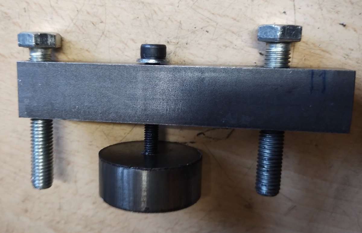

                Thanks Dave & old mart. The heavy duty puller worked a treat! Found a bar with a couple of holes near the end that I was able to tap M8. It was surprising how much force I had to use and still the M5 screw didn’t strip! Pulled the plug out no problem.
                Anyway, thanks again for the most useful input. regards, Mike

                      When turning a bolt in a threaded hole, a lot of the effort goes into friction under the head and between the male and female threads. This means that the bolt shank has to resist both tension and torsion at the same time. Doing it with the goal post arrangement means the M5 bolt only has to resist the tension.

                          When using a puller like Mikes’ it’s best to put a spacer between the parts being pulled and the bar so the centre screw or bolt can be done up tight. Effectively becomes a single solid unit vastly reducing the chance of thread stripping.
                          Way back young and hairy Clive stripped the thread on the centre bolt doing a similar job, fortunately not the extractor thread on the part being removed. Was advised to make things solid with a spacer and it all came out quite easily. As I recall it with less torque on the pulling bolts too. I presume with it all locked up solid the mechanical efficiency at actually pulling is much greater. Or something.
                          Probably unwise to use a high tensile bolt in the middle. Nice fitting ordinary bolt, something better than the rattle around big box store cheap ones, seems wise. If everything does go whaooie shape a HT bolt could well strip the thread in the part being removed. Which makes the problem ten times worse. An ordinary bolt stripping leaving the other thread intact is much less of an issue.
                          If need be and you have the facilities make your one with a top limit size thread for best grip. Something I’ve done in the past when I really didn’t like the potential fall out if things didn’t work.
