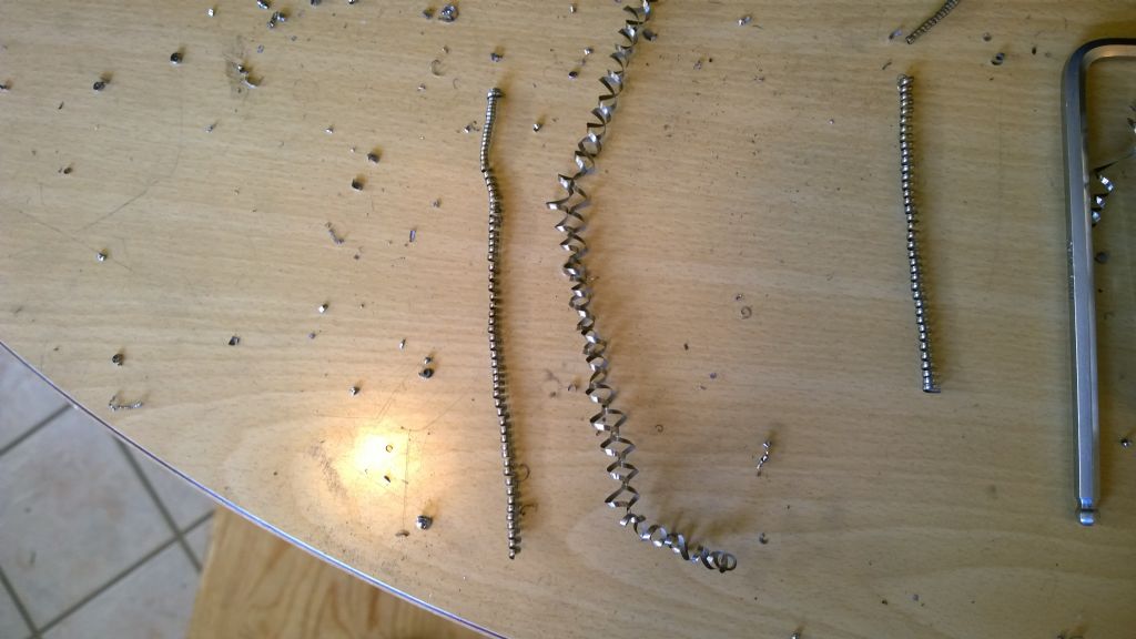

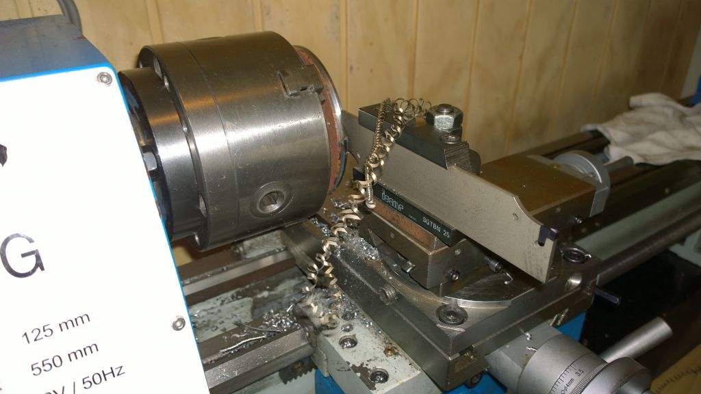

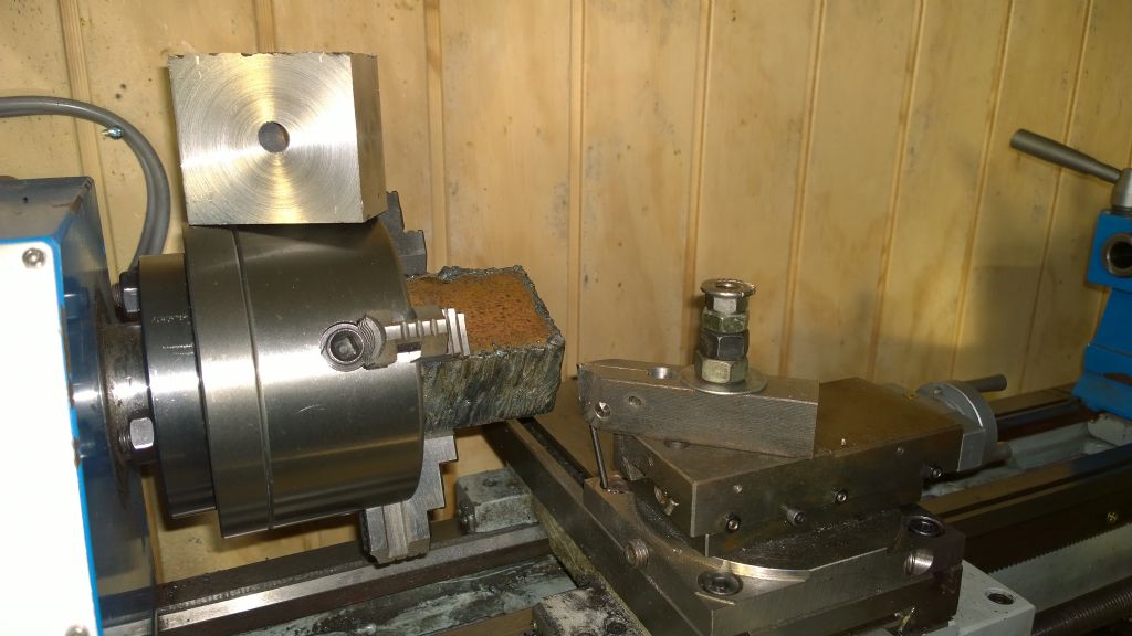

                        I have had a WM 250 with MorseCone 3/20mm bore spindle/sold it and do not miss it.
                        My present WM250 with Morsecone 4/28mm bore is the one the one to put on top of my grave.
                        It will miss me.
                        The first was sold because parting off was marginal at best and the present does it for breakfast.
                        The last picture shows how it can do ugly things to a piece of oxy -acetylen cut steel of lousy breed.
                        (order of Photos and text is not easy to handle)
