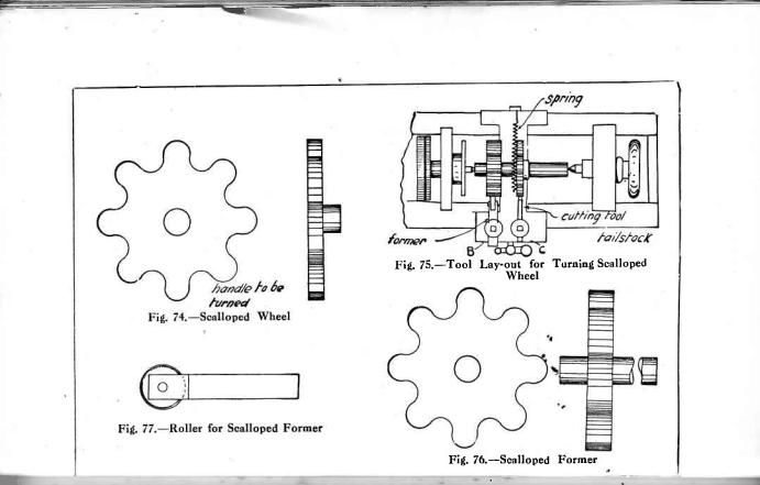

                    A lot of the older lathe books make reference to copy turning type attachment lashups in bygone years, usually involving a strong spring across the cross slide
                    This is from "metal turning made easy" from 1923
                    Edited By Ady1 on 23/09/2015 09:28:59

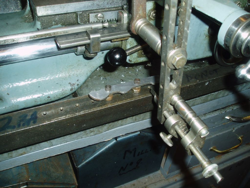

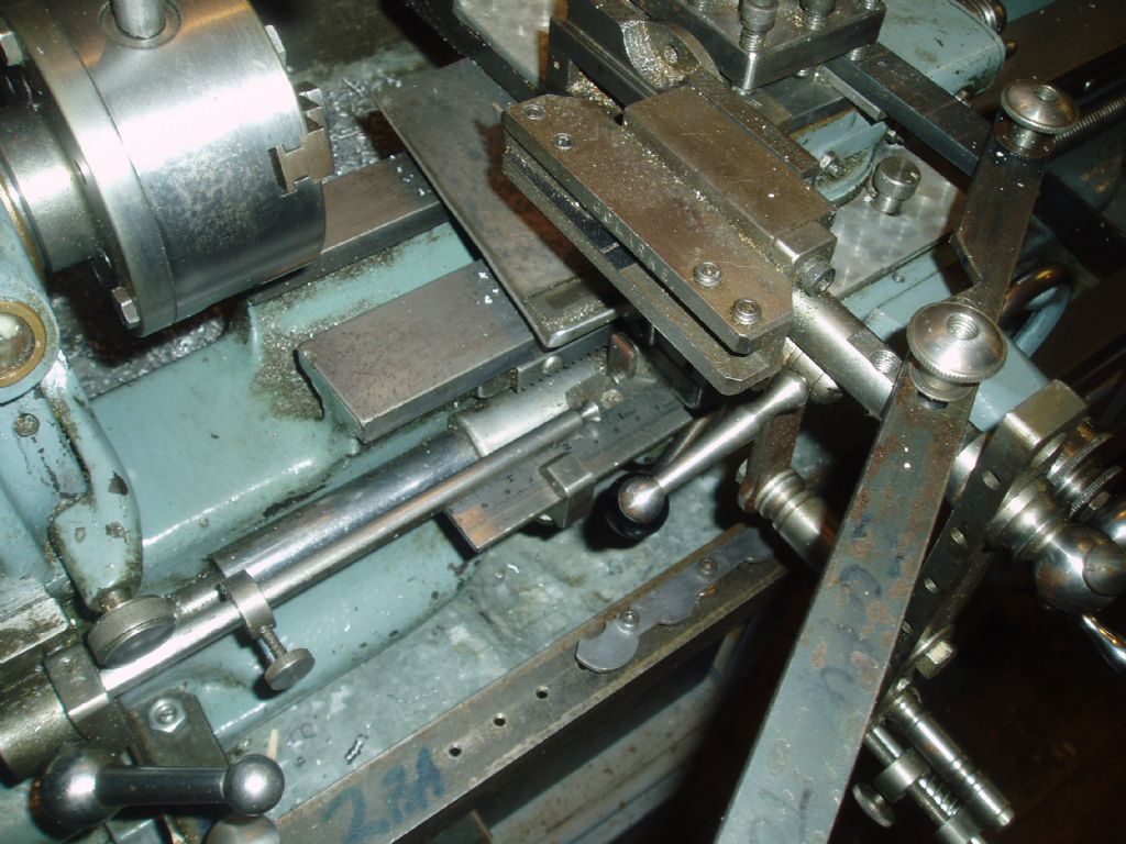

                                            Nobby
                                              @nobby
                                              handleHi Chris
                                              Yes it is On my super 7 Mk one slide

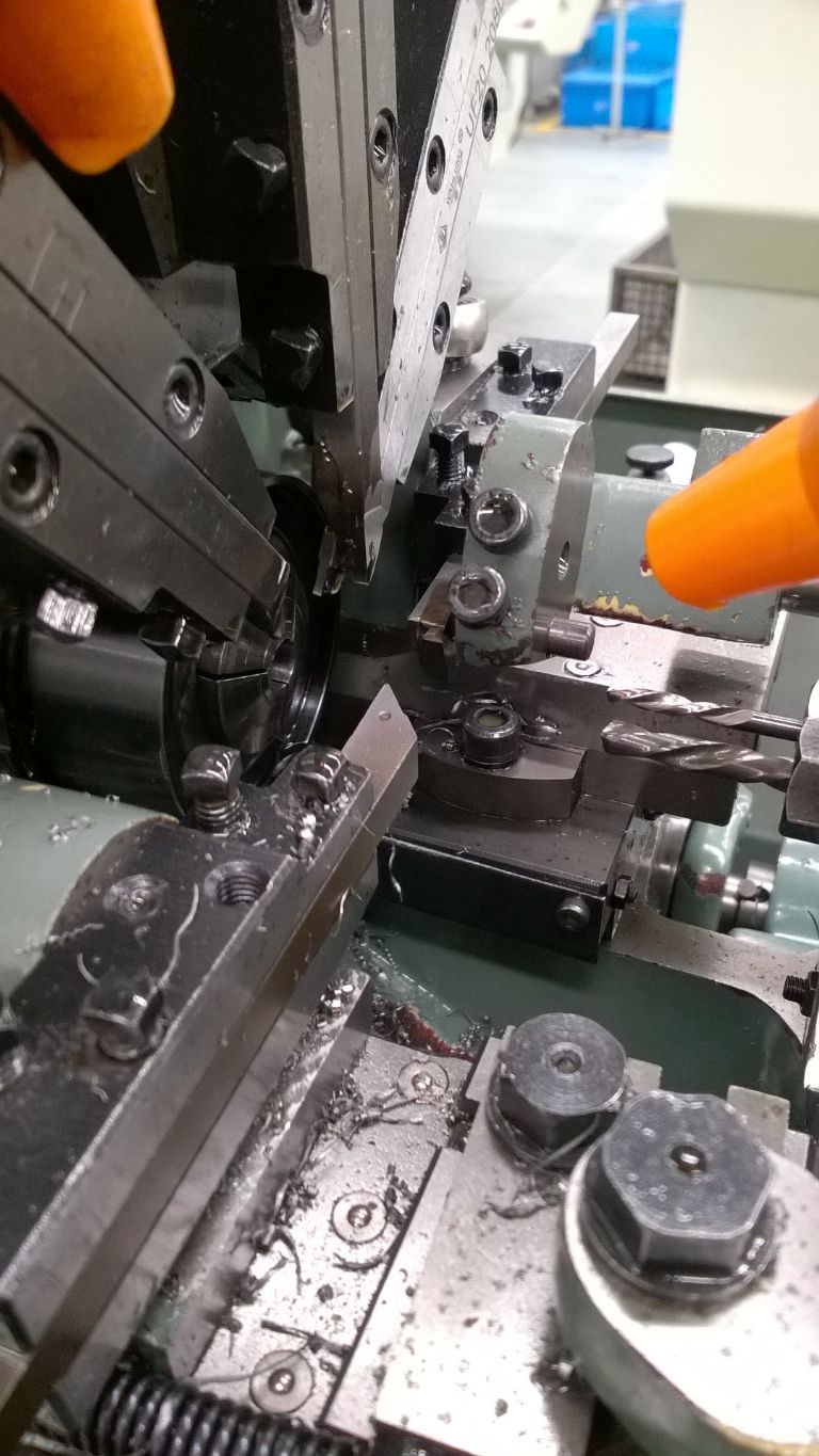

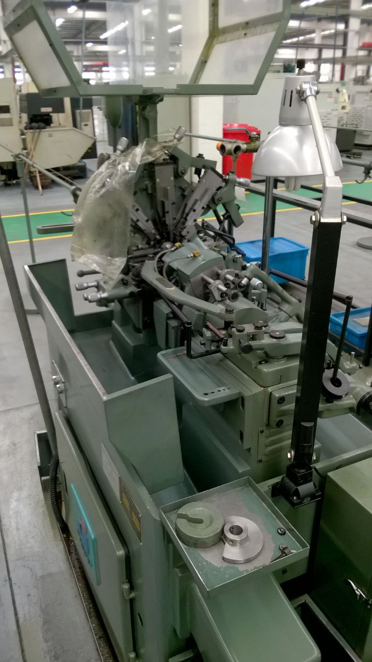

                                              Muzzer
                                                @muzzer
                                                This is a cam operated lathe used in one of our factories in China which was used to churn out vast quantities of hose barbs. It's a mechanical CNC machine if you like. It's been superseded by some rather nice new Mitsubishi CNC lathes which you can imagine are somewhat quicker to reprogram! The operations are programmed by machining suitable cams which can be seen in the middle picture.
