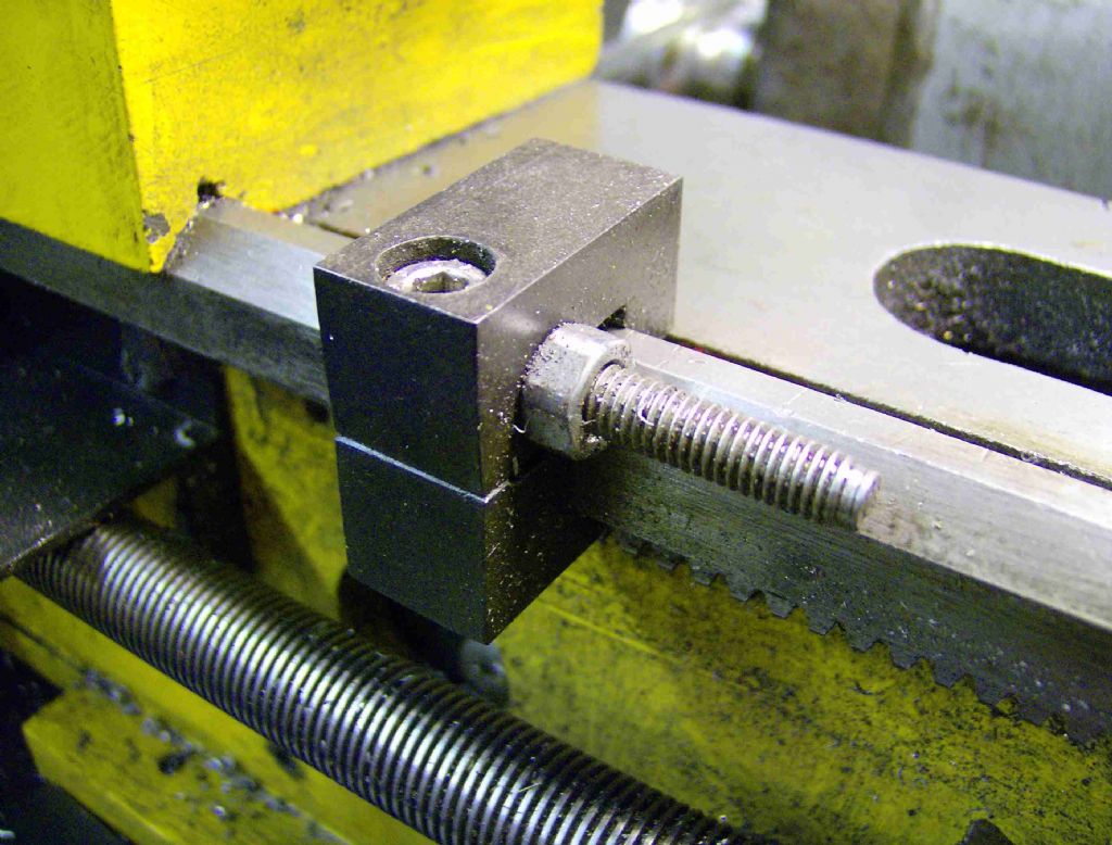

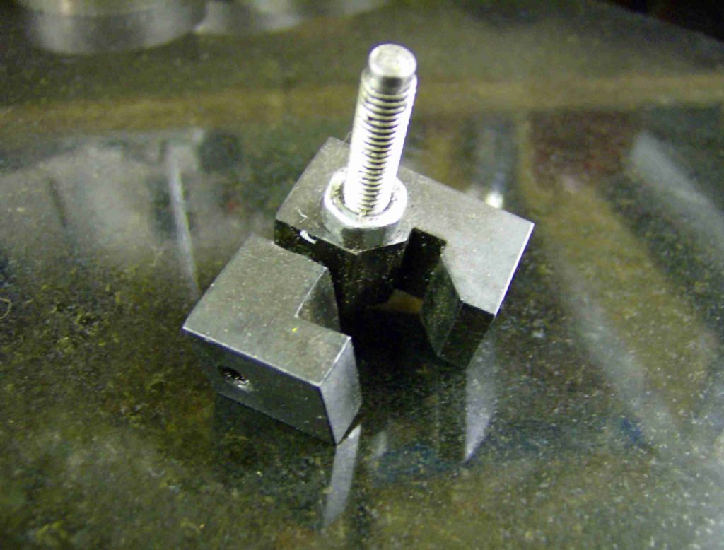

                #88507
                Sub Mandrel
                  @submandrel
                  Saddle stop
                  Saddle Stop fitted to lathe

                    To my mind, ChrisH, there are two sorts of saddle stop.
                    The first is only useful if you are traversing the saddle by hand, and consists of something like the one Neil (Stubmandrel) has shown. On repeated cuts, the saddle bumps up against it, stpping the saddle in the same place each time. For obvious reasons, you can't use it when the saddle is being traversed under power.
