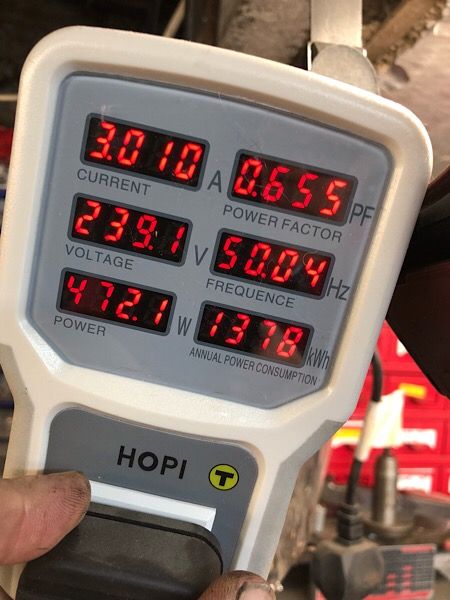

                                              This meter is showing the load on the single phase input on my 3hp 2.2 kw motor running via a vfd under no load and running the spindle with a cut on ,on a Colchester student

                                                Posted by Ian Parkin on 06/05/2019 10:37:27:
                                                Edited By Ian Parkin on 06/05/2019 10:38:49
                                                Edited By Ian Parkin on 06/05/2019 10:39:35
                                                Interesting. Was that a hard cut, putting the motor under high load, or not? It's right at the upper limit for what you'd expect if the 1ph to 3ph conversion didn't increase current draw (despite the data sheets saying it does).
                                                Or, if the VFD is 2.2kW in, and only putting out 1.25kW.

                                                Ian Parkin
                                                  @ianparkin39383
                                                  Its an Emerson commander control techniques one
                                                  its by far my preferred choice of vfd’s if i’m Buying one new
                                                  easy to configure and the instruction book is only 40 pages long and they seem to do everything i’ve Wanted i’ve Probably installed 40 of these on various machines in day job
                                                  #407941
                                                  Carl Farrington
                                                    @carlfarrington53722
                                                    Posted by Ian Parkin on 06/05/2019 11:10:43:
                                                    There's a table at the bottom of page 8 here: **LINK**
                                                    It says the 2.2kw unit has a full load input current of 23.2 amps from a 1ph supply, or 11.9A from a 3ph supply.
                                                    #407950
                                                      I waffled about this in another recent thread. Briefly, the maximum currents quoted in the specs are peak, and they mainly occur during start-up. Starting a motor from a dead stop is electrically brutal until the rotor moves.
                                                      As soon as the motor is turning the current drops to much lower levels. Ian's watt-meter pictures show his running lathe consuming 3A 'off-load' rising to 10A when he takes a cut. That type of watt-meter is to slow to register what happens in the first few seconds, likely a lot more than 10A!
                                                      Running off-load the lathe is doing enough work to exercise half a horse. That's due to friction in the machines bearings, belts, and gearbox etc. If the motor were uncoupled from the lathe it would likely turn on less than half an amp. Conversely, when the motor is asked to do more work by cutting metal, it draws much more current. A motor worked beyond its ratings can deliver far more power than the plate says but it will overheat, perhaps fatally. A VFD should detect this type of over-current and either limit or cut the power before the fuse sees anything unusual.
                                                      The fuse problem is how best to handle that initial start-up peak on the input side. It has to take a short but hefty wallop safely. Three choices:
                                                      1. A small ordinary fuse as used in a domestic plug; these stand short overloads fairly well but age prematurely and eventually die. It's safe but makes starting unreliable, perhaps unbearably if the motor happens to be a big fat pig. Single-phase induction motors are notorious.
                                                      2. A small slow-blow fuse; these are designed not to age but they react slowly to genuine faults. The motor will start and run reliably but you risk smoke in the event of a fault.
                                                      3. A big fast blow fuse sized to manage the peak; this is usually what's recommended by the makers. The idea is that the fuse won't blow during normal start-up conditions but it will react very quickly to a genuine fault. The problem with this type of fuse is the cost – they ain't cheap.
                                                      Circuit breakers can be had in similar 'ordinary', 'slow' and 'fast' variations.
                                                      I think it important a fuse rated for full peak current is NOT a slow-blow or ordinary type. The problem is the length of time they will pour power into a fault before tripping out. Better to rate these for the ordinary current consumed by the motor, not for the peak, and accept they might blow occasionally.
                                                      Running a big motor close to the capacity of a domestic circuit might not be smart; bit spendy but an electrician could be asked to upgrade the wiring.
                                                      I am not an expert! If a professional disagrees with any of the above listen to him.
