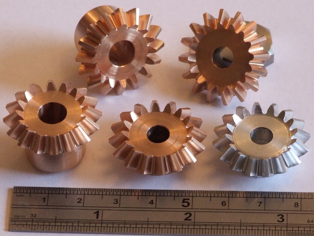

                                        Yes it was. The motor was designed for use in an industrial wood router with a rated speed of 22000rpm. We took a chance and went to 24000rpm, ie, 400Hz from the VFD.
                                        The high speed spindle motor on my CNC mill will run at 24000rpm, albeit at lower power, ½hp I think. It seems happy running for hours at a time. These gears took about 4 hours each:
                                        Andrew
