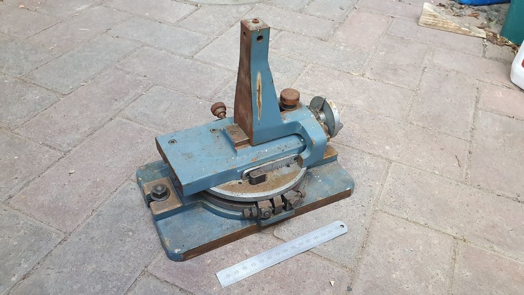

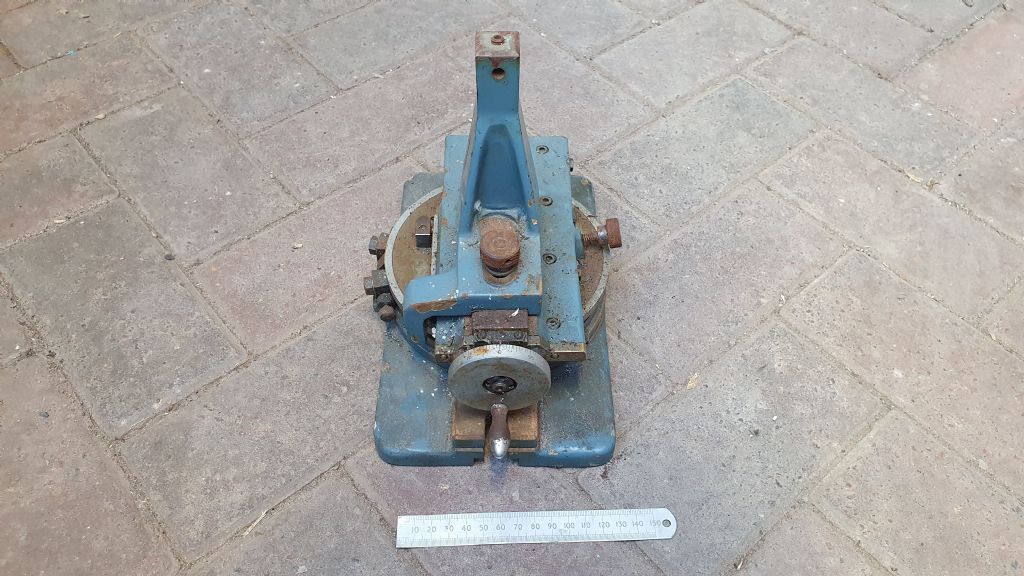

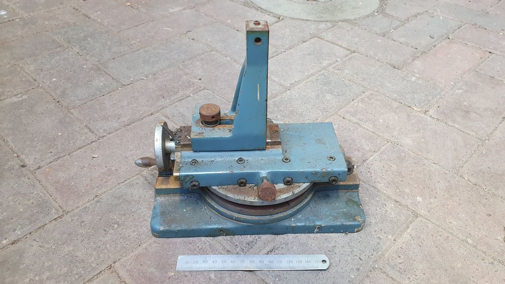

      I'm pretty sure that for the time being this is the last tool I have that I dont know its use. If anyone could shed any light on it I would be interested to find out.
      The cross hole at the top I guess is for tool holding around 1/4" hole. Undoing the knurled knob that holds that section down gives coarse motion back and forth. The graduated dial (0.1" per revolution) gives fine adjustment back and forth with a scale on the side reading +/- 1".
      The whole thing can then rotate freely on a graduated rotary part that has 2 stops that can be adjusted.
      Some kind of radius turning device is what springs to mind for me but it's relatively large but obviously that's only relative to the machine it's designed to be used with.
      Any ideas?
      Thanks again, Craig

          I would say that it's very likely a radius dressing tool for abrasive wheels. The hole is to hold a dressing diamond.

                Pete you are spot on. It is used on surface grinders to put a radius on the grinding wheel. Have used one on many occasions during my toolmaking days.

                  Thanks Alan, it appears to be in typical Jones and Shipman blue and a quick search on google images brings up several matching items.
                  It's a Jones and Shipman Radius Dresser. Should fetch a pretty penny Craig if you decide to sell it.

                    Thanks for all the prompt replies. Top marks to Pete, it most certainly is a "Jones and Shipman radius dresser" and as you say seems to hold a certain amount of value. My illness with anything like this though is, although I have no use for it now, if I ever wanted one in the future I would hate to have to pay face value knowing I once had one in my possession, and to that order I'm probably unlikely to part with it 😅
